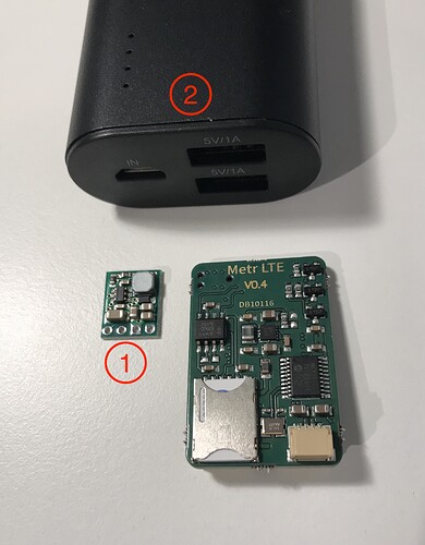

Hey Roman! How has testing been going with that tiny 5V step down in the photo you shared? :smiley:
It works. Metr Pro CAN + Metr LTE + GPS and all those are powered with 5V from the regulator and not from CAN.

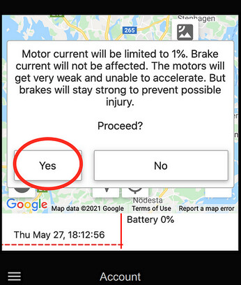

That would be amazing, but Metr modules unfortunately have no voltage sensing capabilities. In order for this to work you need to keep VESC on.
I would like to have a better package in order to sell it (plug and play). Right now I have a few 50V → 5V regulators (Pololu D36V6F5) but they require soldering which some may argue is not very user friendly. You can get one for free together with Metr LTE. :wink:

I have a Metr Pro CAN SD and LTE module on the way. It looks like powering it while the vesc is off isn’t yet an option but would it hurt to power it off a usb battery now in anticipation of it working at some point in the future?
Would the proper way to wire this be plugging the gps module into the Metr Pro and sending the usb battery power into the open CAN slot on the lte module?
The Metr has to be powered from a 5V source. The easiest is to find a buck converter that can take your battery pack voltage and step it down to 5V reliably. This will keep the Metr running continuously. Please keep in mind that this will also keep ground connected through the metr to your ESC, (as ground is required for CAN connection) so always be sure (if you disconnect power for the ESC from the battery to charge) that the ground is first to be plugged in, last to be unplugged. Positive should be last to plug in, first to unplug. Otherwise you’re charging your ESC capacitors through the tiny wires for the Metr and they might pop. (Ask me how I know)
Just so I understand, you mean a portable power bank like for recharging a phone but installed in the enclosure? You’d need some way to recharge this power bank, so in theory it could work but in practice it would probably be just as complicated to try and work out power bank recharging
IMO the way to do it is get a small buck converter module that can run off the board’s main pack voltage. Attach this to BMS output so the Metr can’t drain the main battery below a safe level
I’ll look into the buck converter. How do I makes sure that ground is always first to go in? Is that a specific plug or do I just modify something?
Correct- a portable power-bank like for a phone. I was thinking that I’d either add a charging port to the controller box or ideally I was hoping it would be possible to charge the battery from a 5v pin off the vesc. Looks like the buck converter is the way to go.
This would need to be a high-side BMS, and those are very hard to come by. Almost any off-the-shelf BMS is gonna fry something if it ever cuts the load.
Most BMS don’t cut the red wire, they cut the black wire.
Finishing testing with power bank only, update coming soon!
