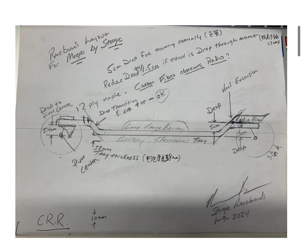

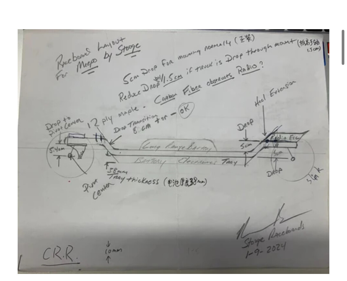

How high is the standing platform from the top of the axle ? Been messing with getting my diy lower
It’s quite high. These are made to be a drop in replacement for DKP and TKP trucks.
If you want to lower ride height, go with the normal HD stooge trucks. You can lower the master heim into the baseplate on that version.
Looks like a pretty thick jam nut so unsure how far it can actually be lowered but it’s the same design on the meepos.
There is some adjustability in ride height. One of the new 3-links on the Meepo Monsoon Legacy had the center heim joint screwed in to lower the ride height.
MLR standing platform to pivot center is 1"
The 3M-Legacy truck fom baseplat to pivot center is 2.25"
