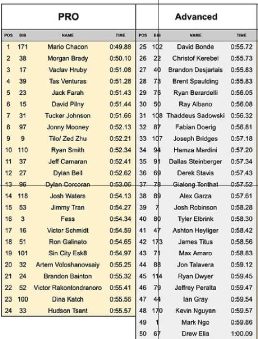

@fessyfoo made pro class at esk8con on this board so it’s a capable board. Fess being an awesome rider of course helped!
I rode it too and was very impressed. Given the price tag, it’s an amazing entry race board. And u can easily bung a bigger battery in with another ESC and get something truly competitive in pro class.

@fessyfoo qualified this setup in the pro division

No doubt! With an extremely talented racer on a well tuned truck setup, anything is possible. Look how many people made it into advanced on stock import boards. Talent is a huge factor in racing, in my opinion. Perhaps even a larger factor than electrical specs.
