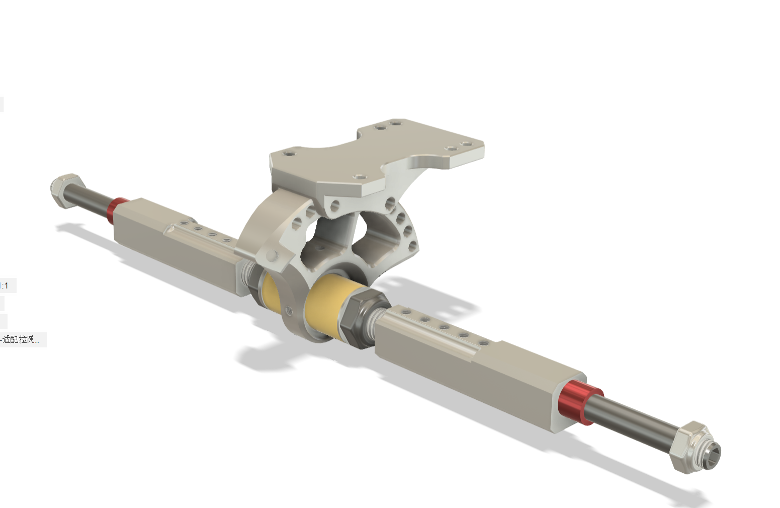

Imo, it will be hard to design without sacrificing some adjustability.
As fess said, looks like newbee still has a threaded rod, but has a square sleeve for drive interfacing.
So still relies on threading, just more of it.

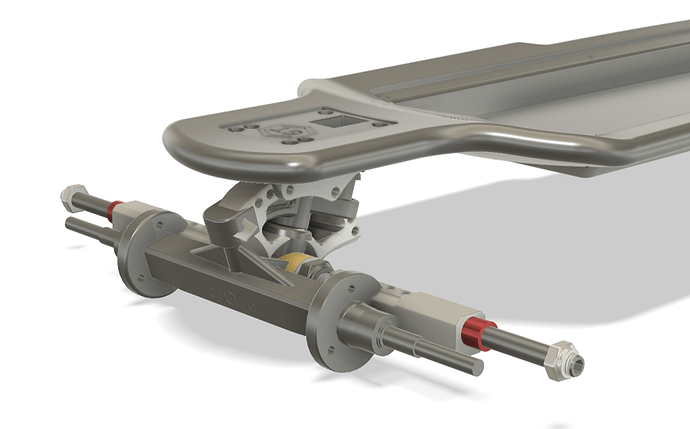

I need to make some claims in here.
So First: I’m not meepo…i am just one dude i own newbeeesk8 .
Second: This is not a straight-up copy and i don’t want to rip off moe, I made it with my own ideas, compare to the SRB 3links. Also i don’t expect sell this much…the original goal is to see 3links concept would able to fit my own gear drive.
Differences:
Mine one don’t have the heim joint for through the mainaxle
Second…the way it adjust angle is different. Mine one is based on rotate the angle bracket beside SRB mouting the rods in different angles.

So here is the Full look/ comprare to DKP

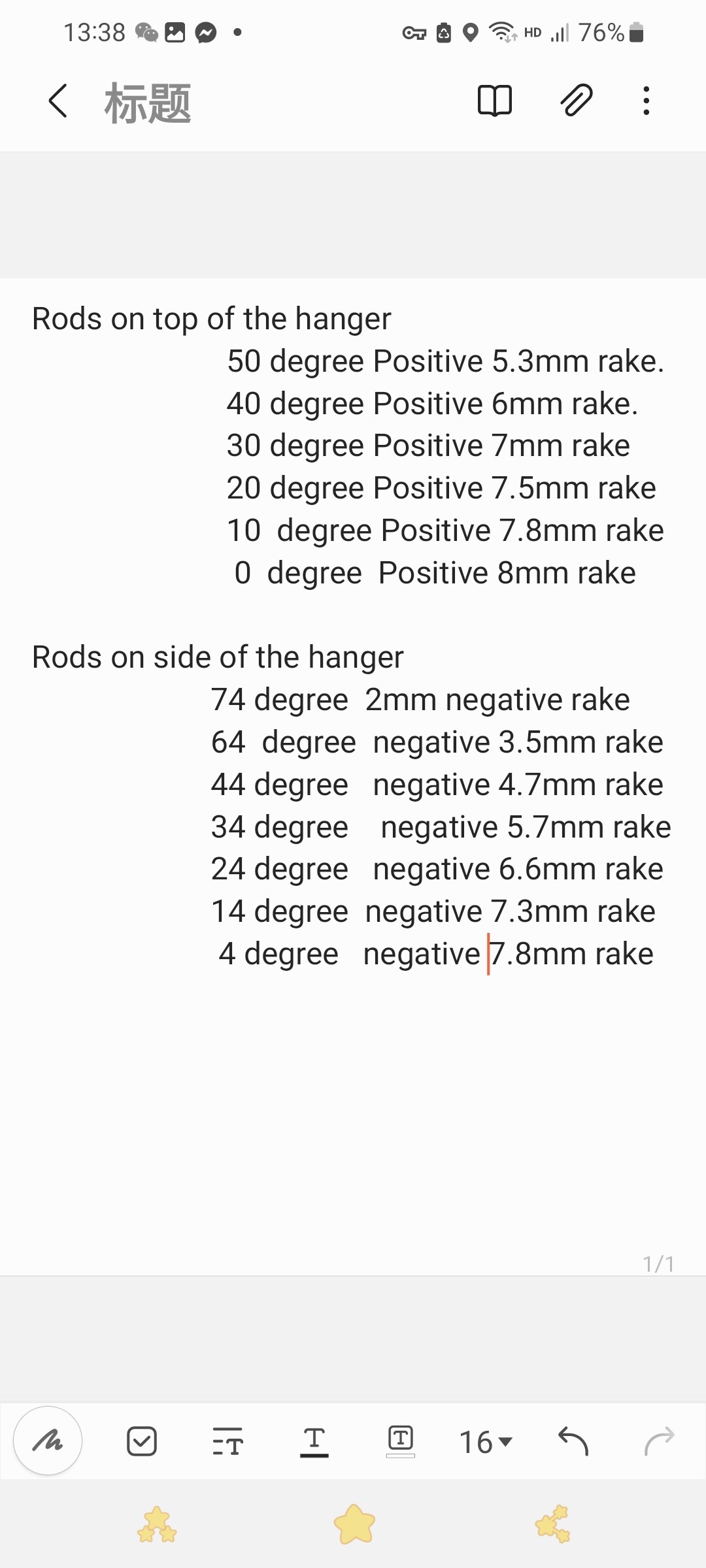

And all the variables
If anyone have suggestions, let me know…i will fix that.
