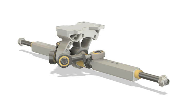

DKP height oof that’s going to be tall. Is there the possibility of mounting it drop through at least?

From the axle center to the top of baseplate is 56mm, isn’t that bad.

Very cool! It is a little tall - does the height change much with angle adjustment? It seems like it would stay fairly consistent. Also, are the links the only thing restricting movement about the axle? Rotational torque, I mean.

height doesn’t change when in different angles. Based on my understanding, rods only provide the limit and give a direction of the lean of the main axle. Bushings is one to restrict the movement. Also this truck could adjust the leans by tight the grub screw.

Was thinking, Let’s say one is to install them to MTB type deck (bro, Flux etc.)
Could it be possible to have adjustment on the other direction too to counteract the deck wedge?

Newbee’s RKP trucks come stock with riptides so I don’t see why they wouldn’t be riptides here tool
BECAUSE WE WOULD NOT SUPPORT THAT
Why? Because of the work and cost of making a new mold? The bushings in the Cad design posted look like barles almost so maybe wouldn’t even need a mold
Probably conflict of interest w/MoeStooge/OG 3 links.
This would be super interesting actually. If you could use barrels in a 3-link style truck, you would have a high rebound precision truck.
Part of the reason folks prefer 3-links for racing is because of the low rebound bushing, that allows you to lean a lot. If you had normal barrels on a 3-link, I assume you would lose that characteristic feeling.
