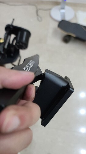

Can someone post a picture? Are you converting a DKP into a TKP? If so, what height bushings is the system designed to run? Sorry, I wish I had time to go through the thread.
yes. He removes the DKP baseplate and middle thing (whatever it is called), installs a TKP baseplate and uses the same hanger as before.
The hanger is sold as a DKP as well as TKP hanger.
Left “TKP” - right “DKP”
The conversion only consinsts of changing baseplate and removing the middle DKP arm.
*Disclaimer, these photos are from when @frame just tried out to mount them. I’m not sure if he changed anything else or optimized it since.
There was a clearance issue that i am aware of but i think that had to do with how these boards mounted the baseplates.
u got it all right, just a baseplate replacement and use the hanger, no middle arm
once i top mount it, i only change back to using flat washer, then that’s all.
drop mount is not possible with original motor mount, but if there is a longer mount, it should be possible…
OK thanks, in this new hybrid, what height boardside and roadside bushings are they designed to accept?
