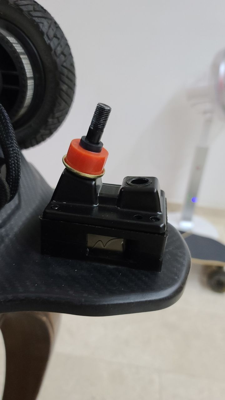

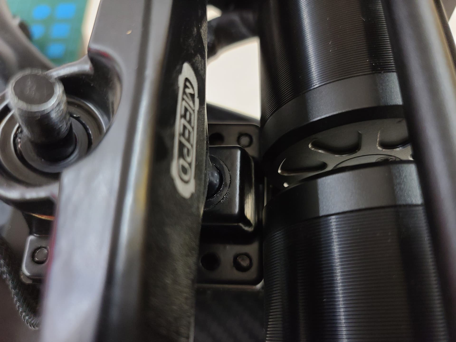

Did that
Still won’t go in the pivot cup because of the motor mount angle
This is how much riser I tried
Time to drill and tap additional mounting holes on those fixed mounts!
i’ve put on some riptide bushings, hopefully it will perform better
e: and it did, but I need some riptide cone bushing to complete the tuning

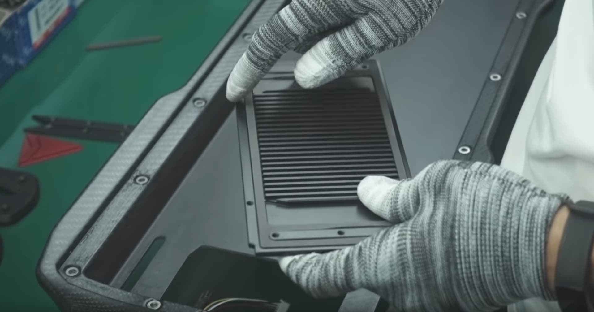

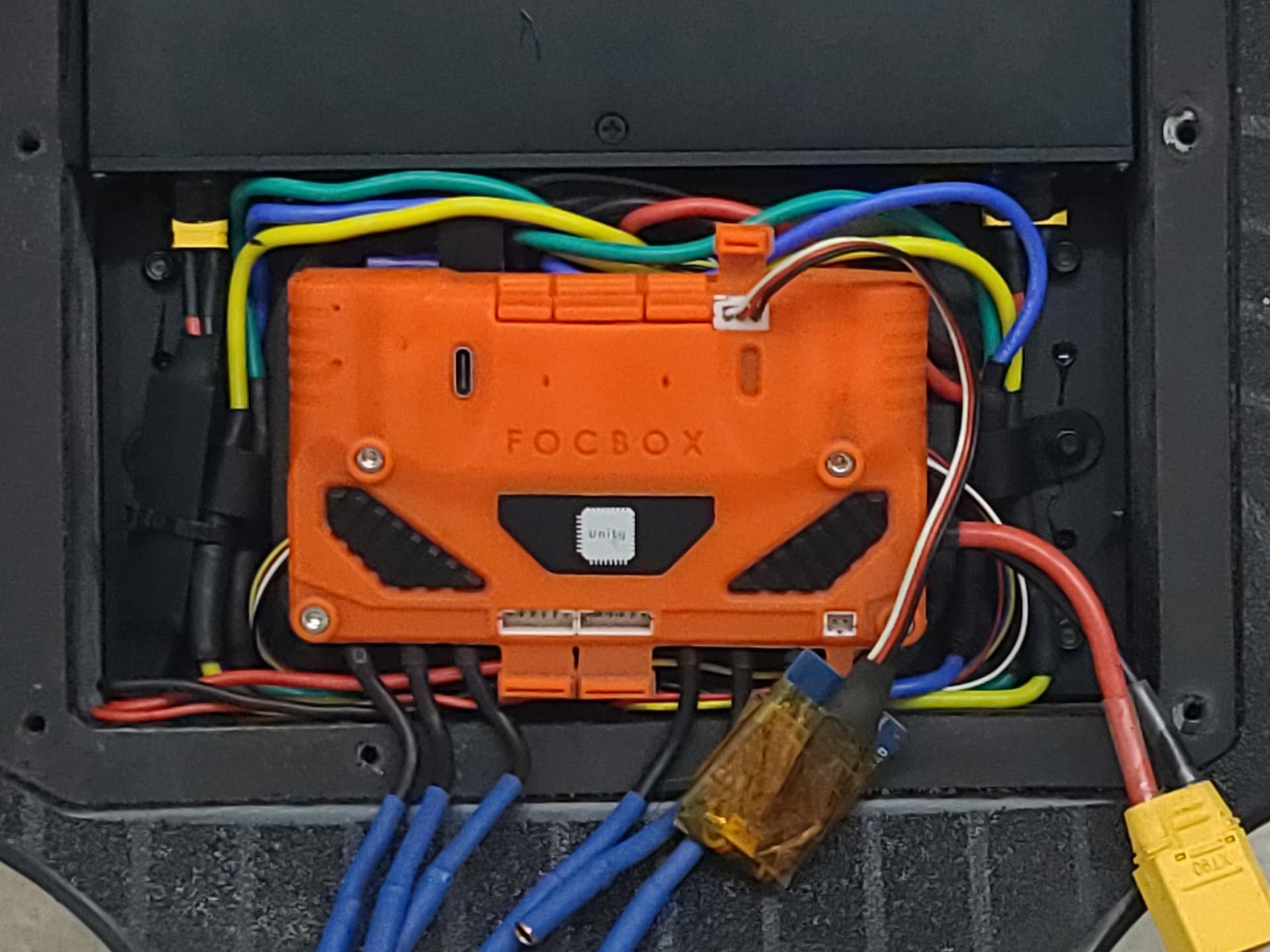

Unity and other dual esc should fit in easily, dual single might be tight
Probably not the dv6, too thick
maximum thickness u can have is about 25mm in the heatsink area, so probably won’t fit
e: dv6 looks to be 23mm, so maaaaybe it will
unfortunately it looks like a trampa hd60 would fit in here. how much thickness is available?
6.6 mini should fit.
Get longer motor mounts. The 3 holes for the mount look like they could fit @IDEA mounts. Love his stuff
I have BN and TB mount to work with, and I have a plan for it. If all else fail, idea mount should fit nicely.
