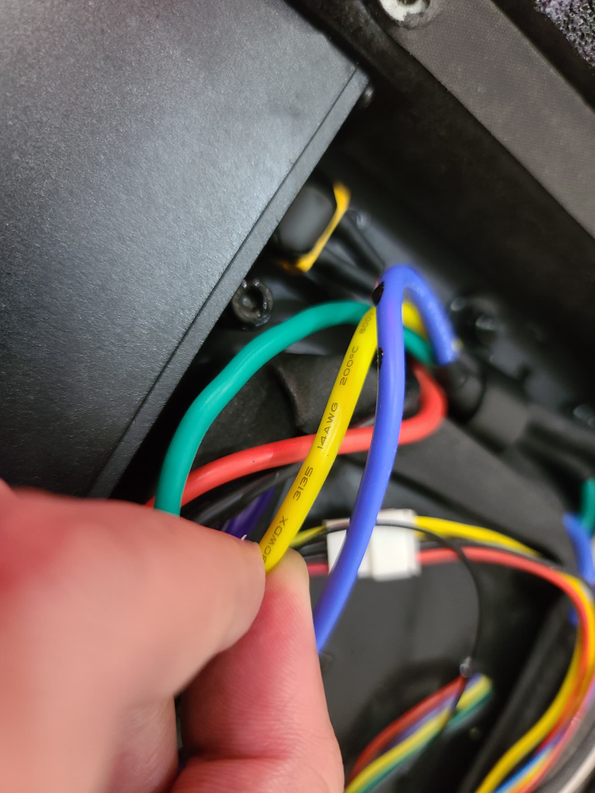

14awg for phase and batt, all wires are 3mm diameter

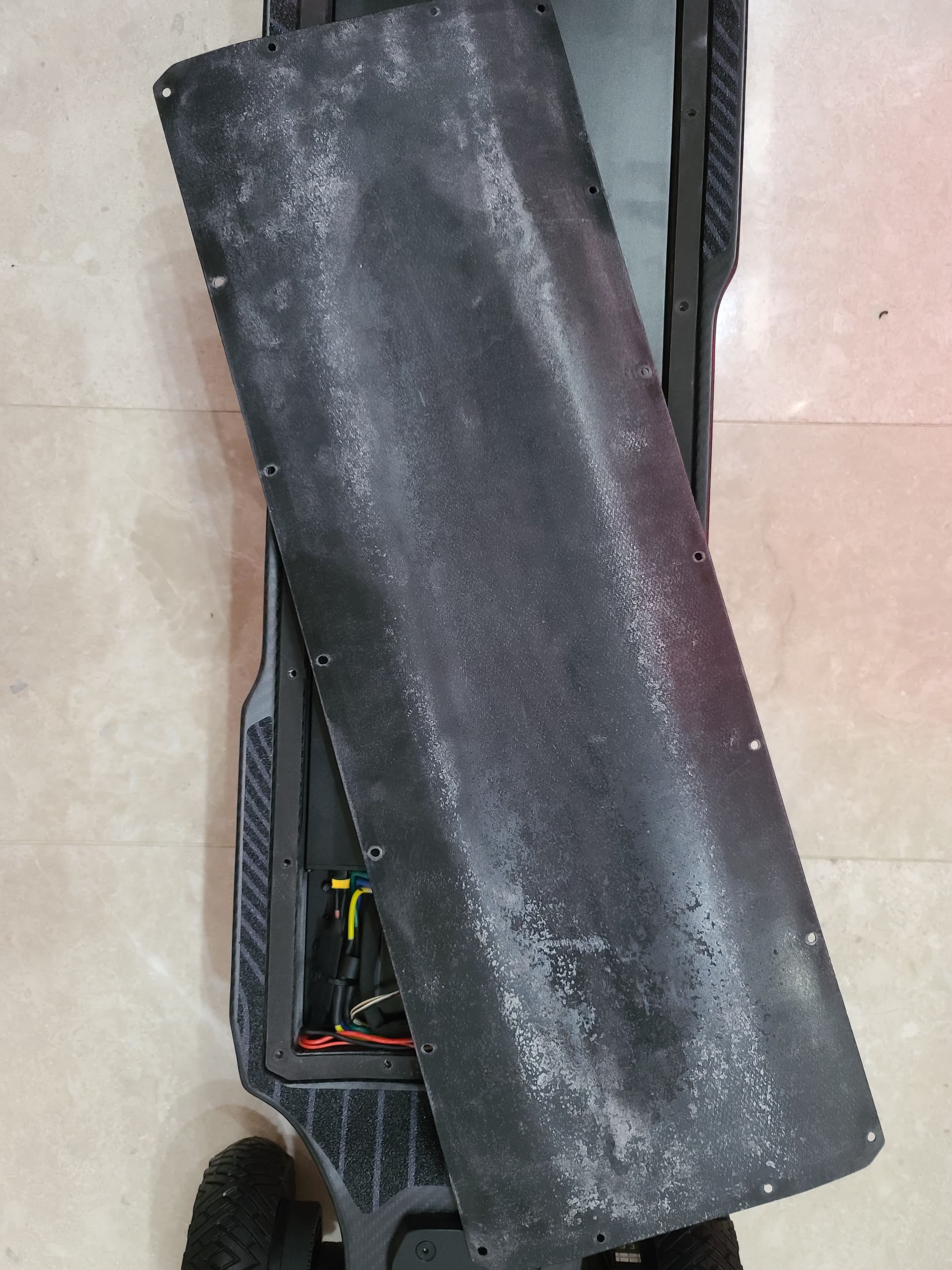

Compartment dimensions
27.5mm deep (calipers measurement)
195mm wide (calipers measurement)
630mm full length (tape measurement)
533mm until heatsink (tape measurement)
@xsynatic and anyone who want to know
Top lid is held down by 18x m4*12 countersunk screws
Discharge and charge port is seal with black glue, cutting is a must if u need to unplug
Deck dimensions
100cm length spot on
26.5cm at widest point
It's also disgusting under the lid
Last thing: the top lid can be put on both direction, only thing is, pattern will not match up
Finally silicone wire?
14awg esc and motor?
Yes, and charge wires is 18awg

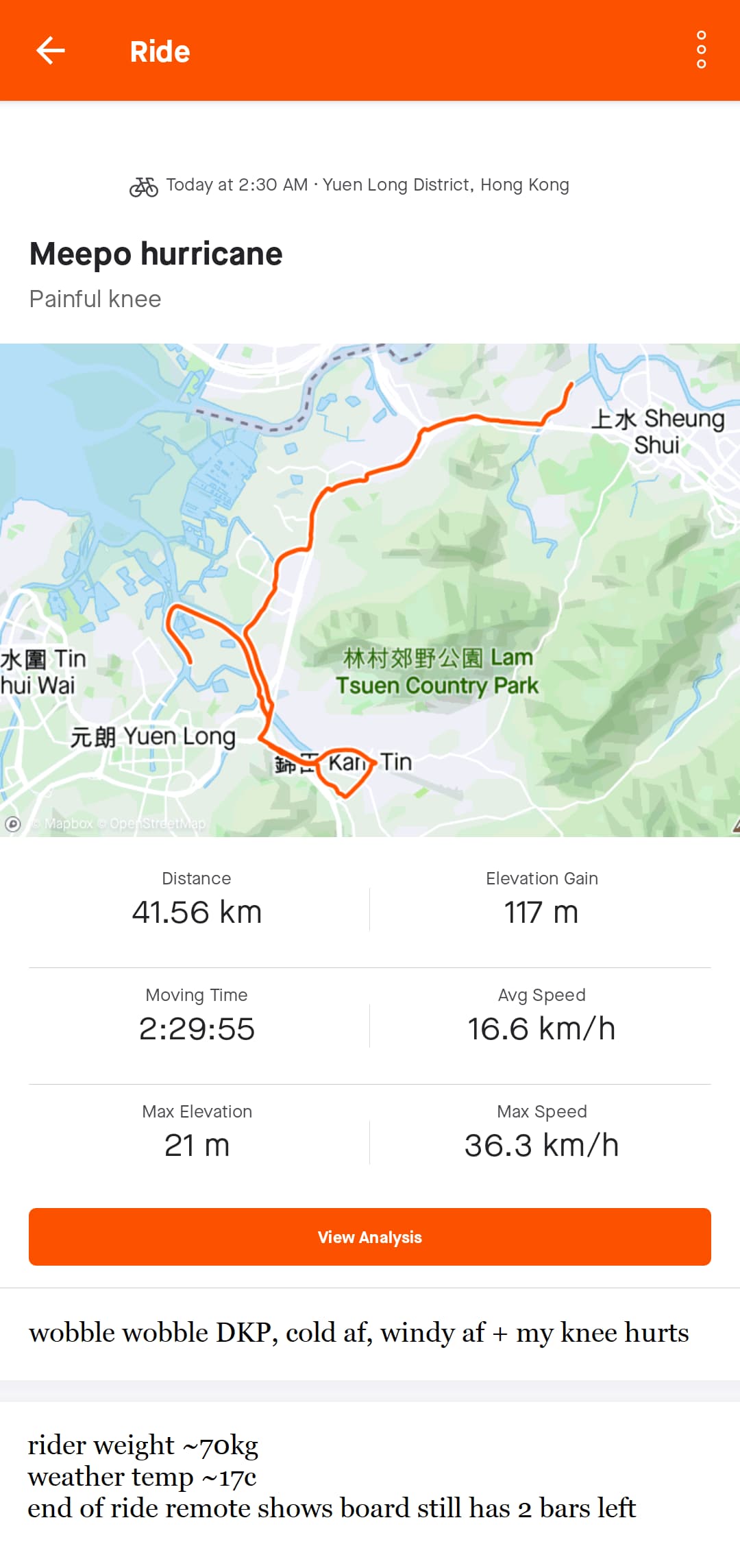

fk me, i can’t drain the full battery in one ride, take what u want from this info
Weakling
yup, i suck at esk8ing :joy:
I swear, I’ll kill it 20km
40km is pretty dank actually. More than enough for an average rider
too many factor in play, if u weight 150kg, full throttle all the time and going uphill, then ya probably.
and i gotta say, brake mode 4 can instantly pin the board to the ground
slow rider at fault here :joy:
bro I didn’t know there are paths to ride in HK! I would still be there if I haven’t left 10 years ago! Did you ride where some peeps got into an accident and died in that bike route?
The descriptions. :joy:
there are quite a few places where people got injury or dead, but i don’t think my route was anywhere near those
it was my first time riding that long

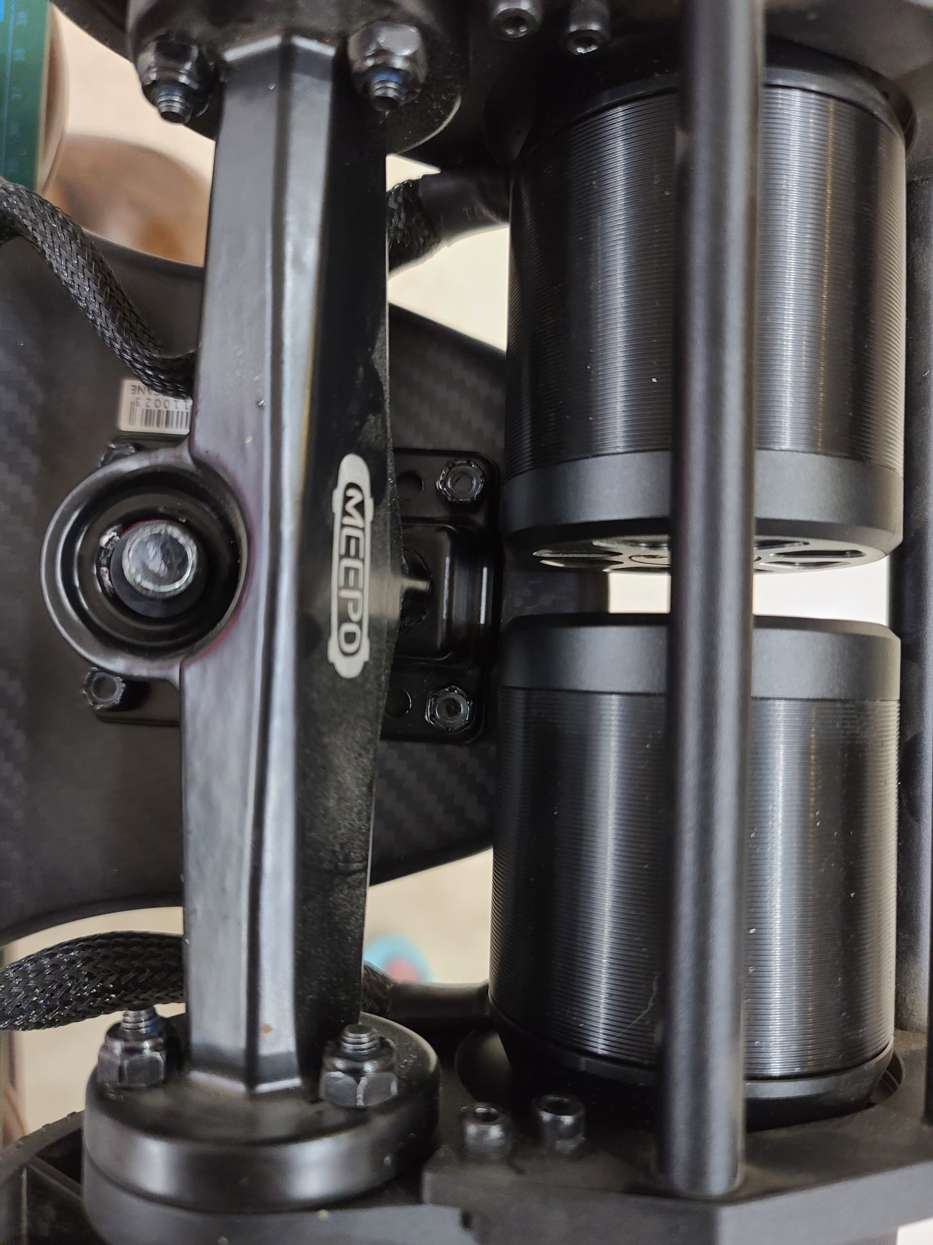

Cant convert to TKP, motor mount in the way, and if I adjust it, motor will have 0 ground clearance
Fuck
10-15mm riser do the trick? replicate the height of DKP adds
