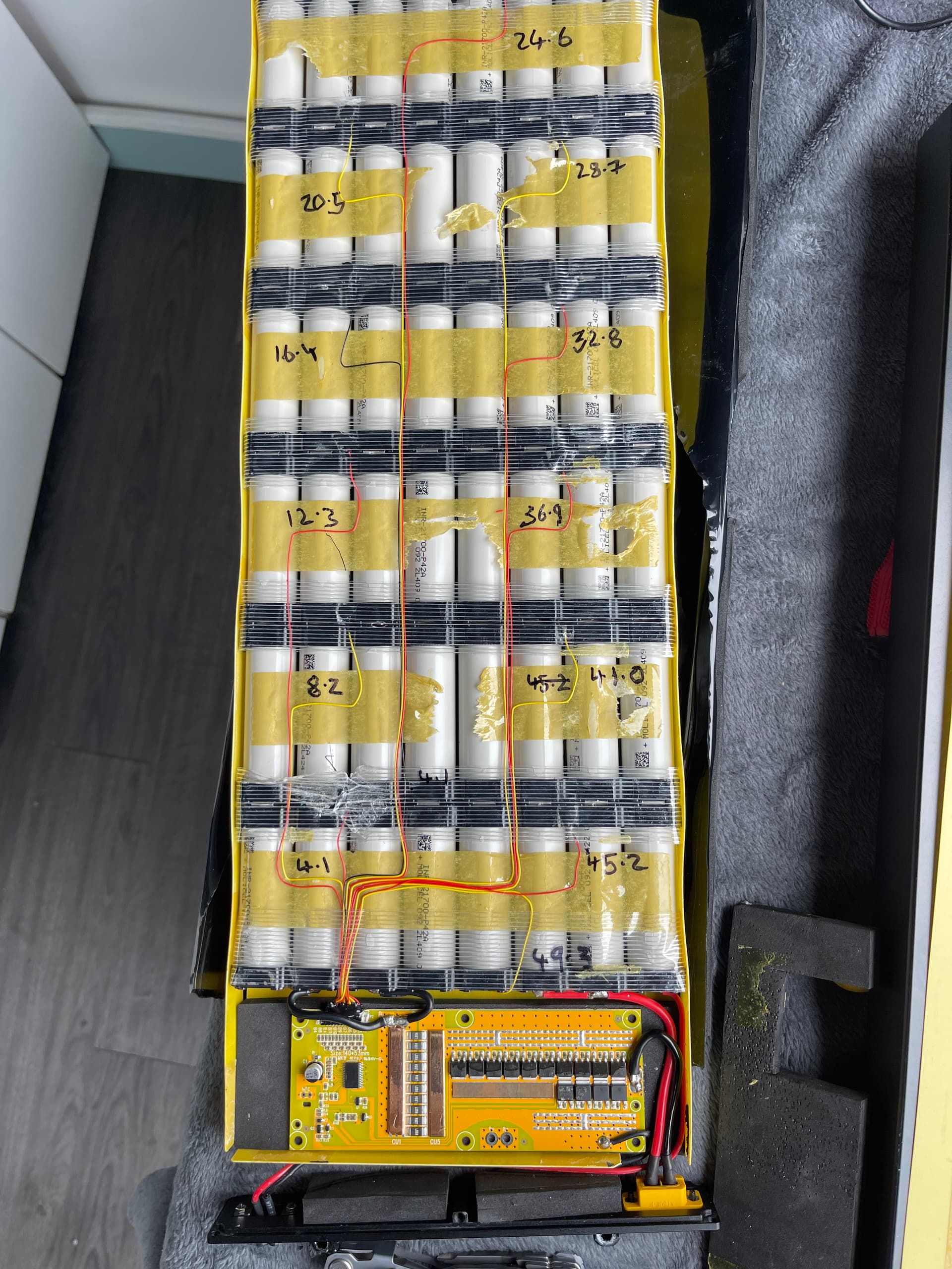

Hi, my Hurricane battery is at 47,1V fully charged (autonomy is reduced to somewhat 40/50%, board is charging in 1h instead of 2h30). It’s from the first batches (board 1376) but has less than 1000 miles/50 recharge cycles put on it, I’m :rage:

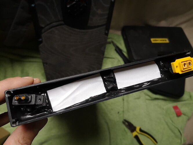

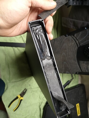

I’d like to open the pack to at least check voltage of the p group individually but I am not able to get to this point, there is a lot of glue in the aluminium casing and I am afraid of playing with knives inside or whatever to get rid of the glue, any tips would be greatly appreciated ?
One of the top 2 groups is dead
Edit: oh, didnt see the 49v at the bottom

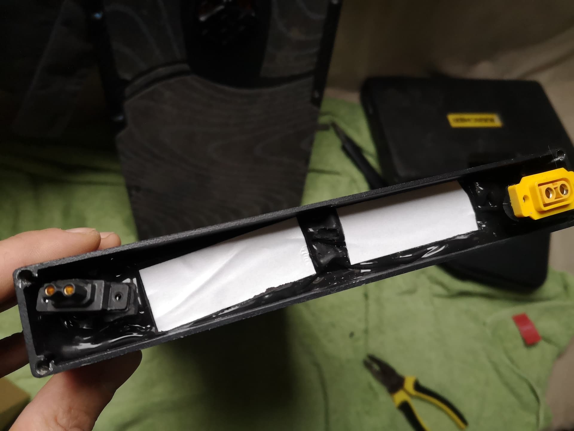

@everyone Could anyone here give my friend @Skyart a tip on how to open the meepo battery case please?
gotta cut the rubbery black caulk to separate the battery from the enclosure, then cut the black plastic battery housing. I used a straight razor to do this recently. work slowly, careful of wires. check for bms damage after this. @Skyart

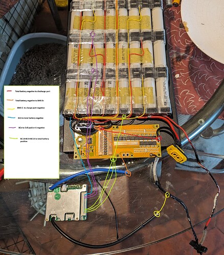

Could you please tell me if I got the wiring correct for a BMS bypass for discharge, I’d like to be 100% sure before going for it as I am just another noob trying to learn ?
I just replaced my BMS with the same that you got. You wiring is correct, ofc you remove old BMS completely.
I also put small pieces of fishpaper under each of black cell holder so it was not loose anywhere. You can also de-solder everything from end of negative side of battery, expose wire in this blue 12AWG, soldered it to all 4 tabs (or 2 like they did) and connect the end of the wire to negative battery connector. Tape positive side with something to not short anything. That’s what I did.
Meepo wire for charging port is super stiff, not silicon one.
Thanks a lot for your answer, I am not quite sure to understand the part “connect the end of the wire to negative battery connector”, are you talking of what I’ve called “negative discharge port” and if I use this blue cable for both connecting BMS B- to negative battery side and to negative discharge port, would it still be bypassed for discharge ? (I understood, to use at least 2 tabs to connect to the battery discharge port, will do it especially if it’s an added safety)
