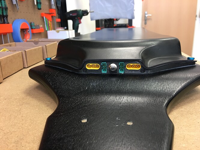

Here’s another iteration. With a start button. I only had enough space for the small DAVEGA button with no LED. It’s OK though. I’ll still have the DAVEGA for on/off indication.
And I also managed to drill the enclosure and install the threaded inserts without messing up the alignment. It’s even fairly well centered. Yay!

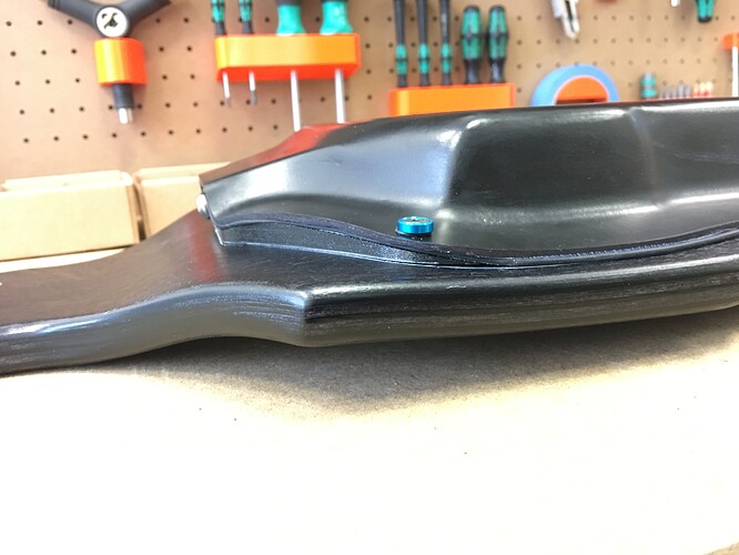

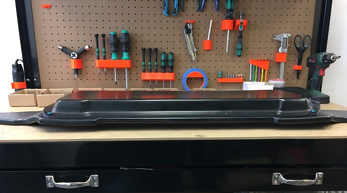

More progress! I’m pretty much done on the enclosure. The fit is good now. There are still a few small holes that I may need to seal with silicone but overall I’m happy with the current state.
The bigger notch is for the DAVEGA cable and the two small ones are for charge cable. I plan to make a thin riser for the front truck that will hold XT30 for charging.

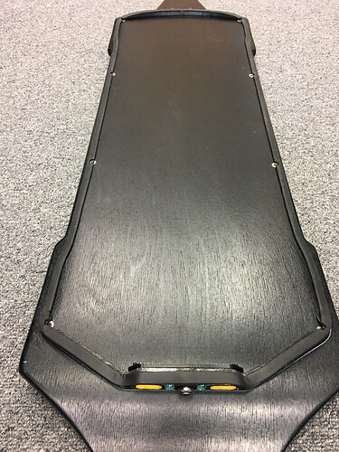

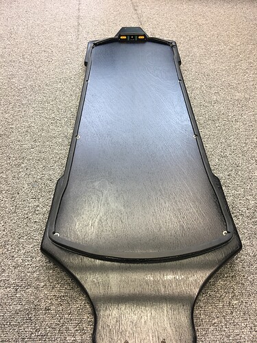

More progress. Getting there. There’s a lot of unused space. I could almost fit 12S4P but not quite. It would fit on the deck but not into the enclosure, at least not with the NESE modules.
Just now saw that you’re using @BigBen’s enclosure for this deck. Nice! Allow me to chime in. This is the max amount of cells you can pack. I did a 12s5p P42A pack with a unity/xenith. However you gotta arrange the p groups like so.

You should consider adding some of that gasket to the deck on the interior side of the threaded inserts. Right now it looks like your enclosure fasteners holes are a path for water ingress
