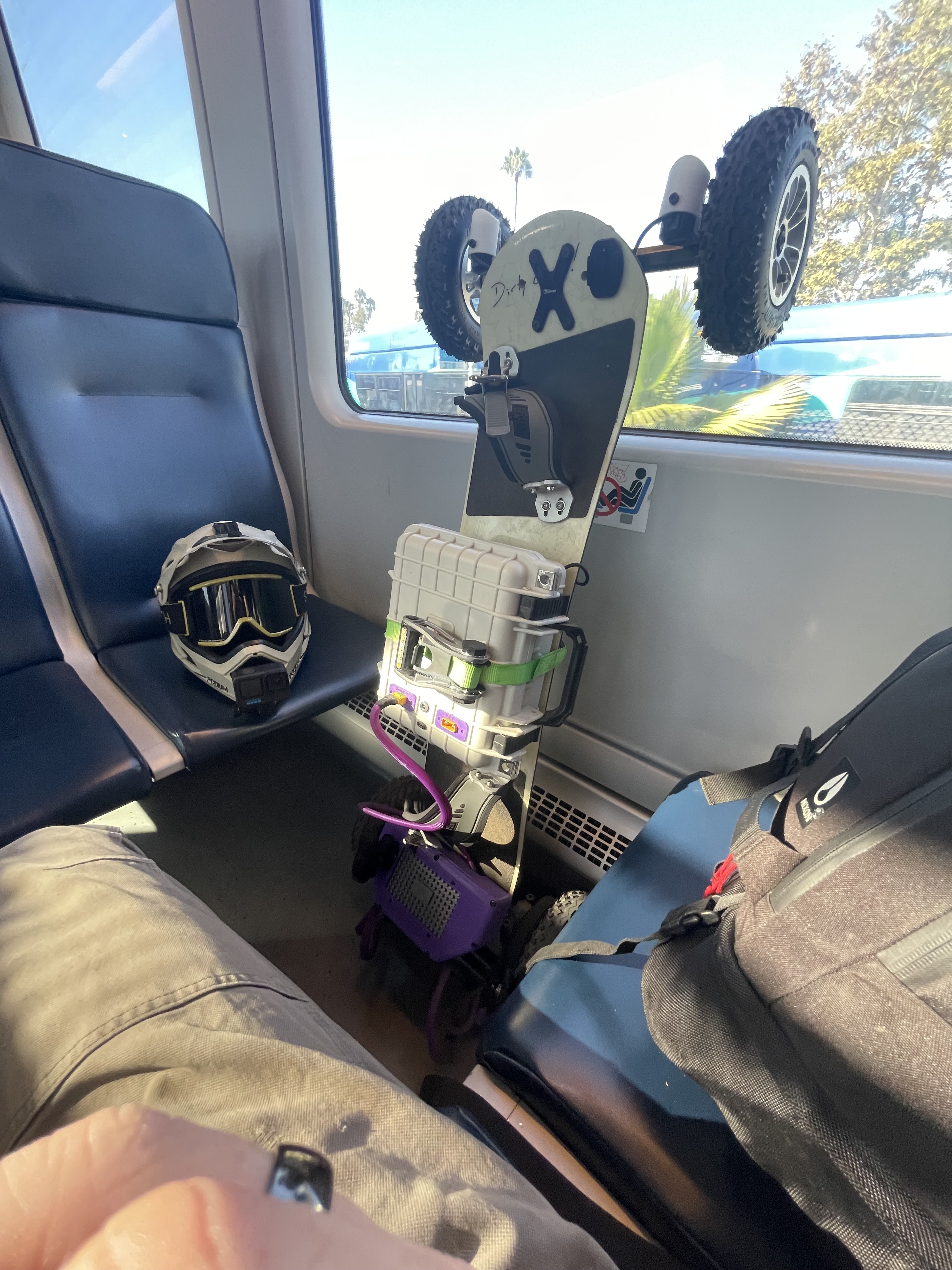

Okay APPARENTLY 8inch pneumatics are too hard, and they will break the glass window of a train
Or at least NCTD thinks so, bc they felt the need to kick me off for this reason
Fuck the Sprinter
Oooh big bad scary skateboard is too much for train man
too bad you cant conceal it
I know it’s too scary for some
black duffel and take the wheels off? :person_shrugging: i cant see a reason for you to get banned thats incredibly unfair im sorry
That or I just put it in the luggage area way up high, I just weighs 40lbs

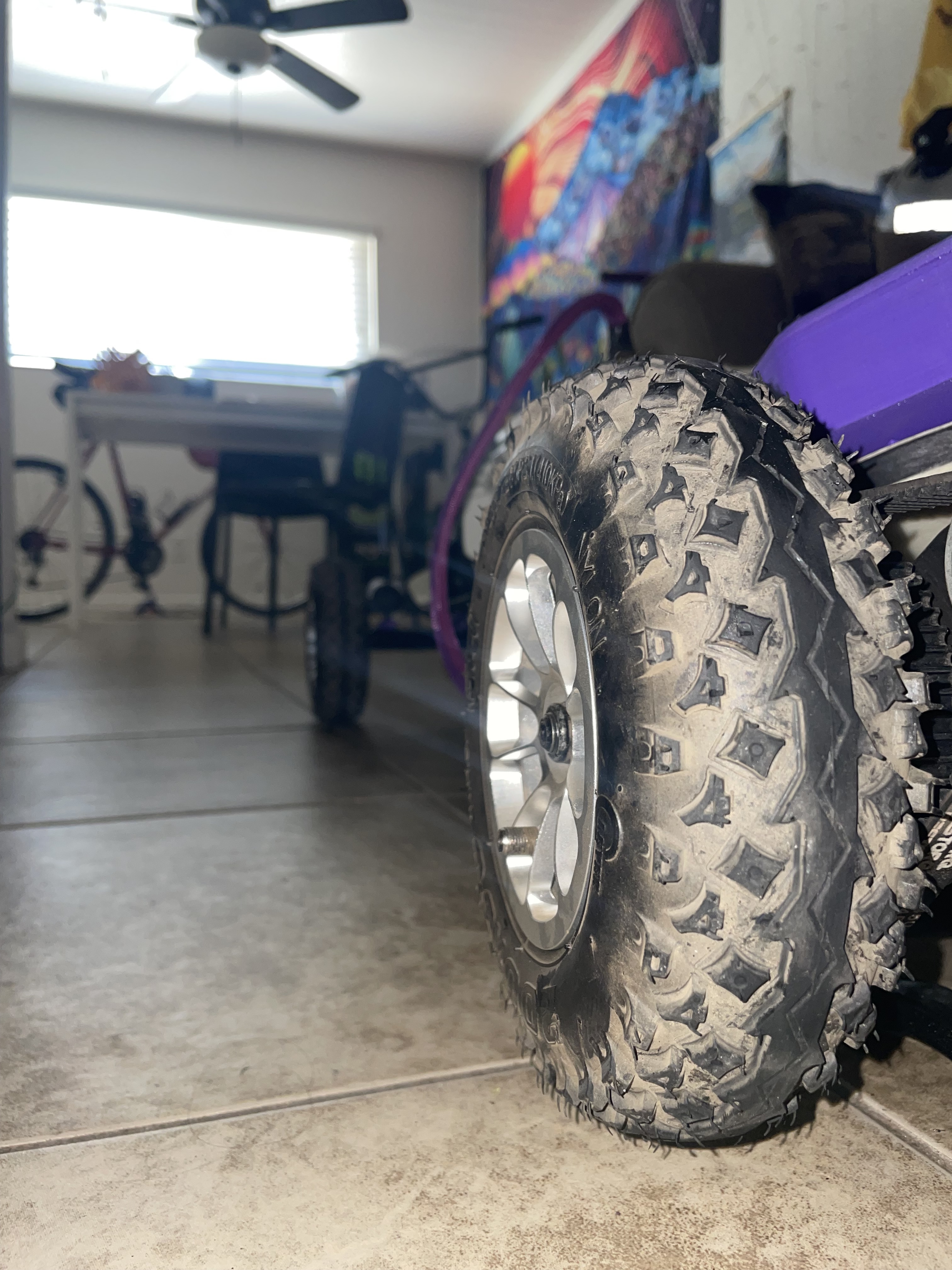

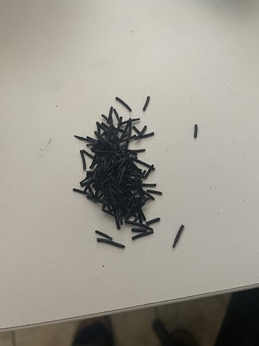

Dunno if i’m the only person who takes the time to cut all the nubbies off
No judgement but like… Why?
Is this just an aesthetic preference?
Yes mostly
It’s kind of a headache but i’ve found when seating them sometimes they are annoying and get stuck under the seat of the tire, which leads to side to side wobble
Its nothing really bad but the higher speeds you feel it
But its mostly for looks, a nice razor blade and some time and they look good, i’ll put some ceramic on the walls to keep them clean and looking nice and that’s that

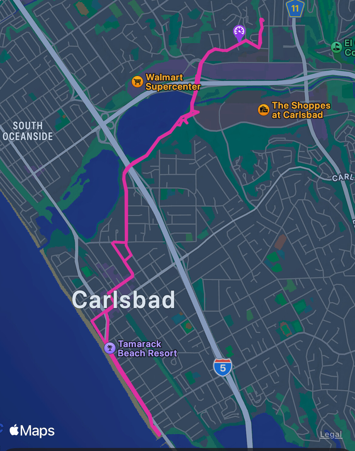

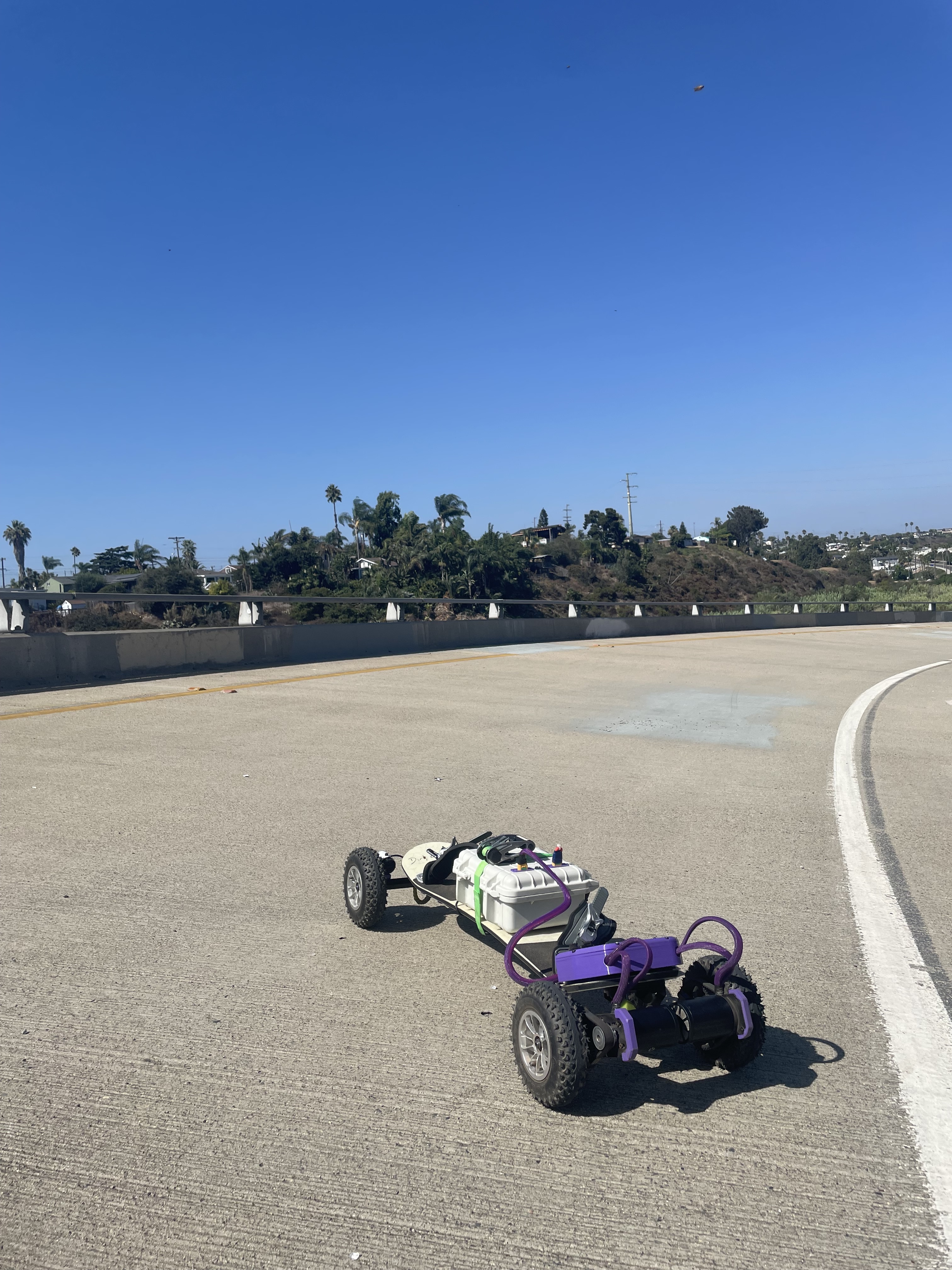

Went for a cruise today, It was super hot at my place so I went out to the ocean to get some ocean air
Just over 9 miles in about 30 min, was just cruising around having a good time
Very nice day, and tested my new gopro pov setup, worked well, just need to figure out a mic situation for going some videos on yt

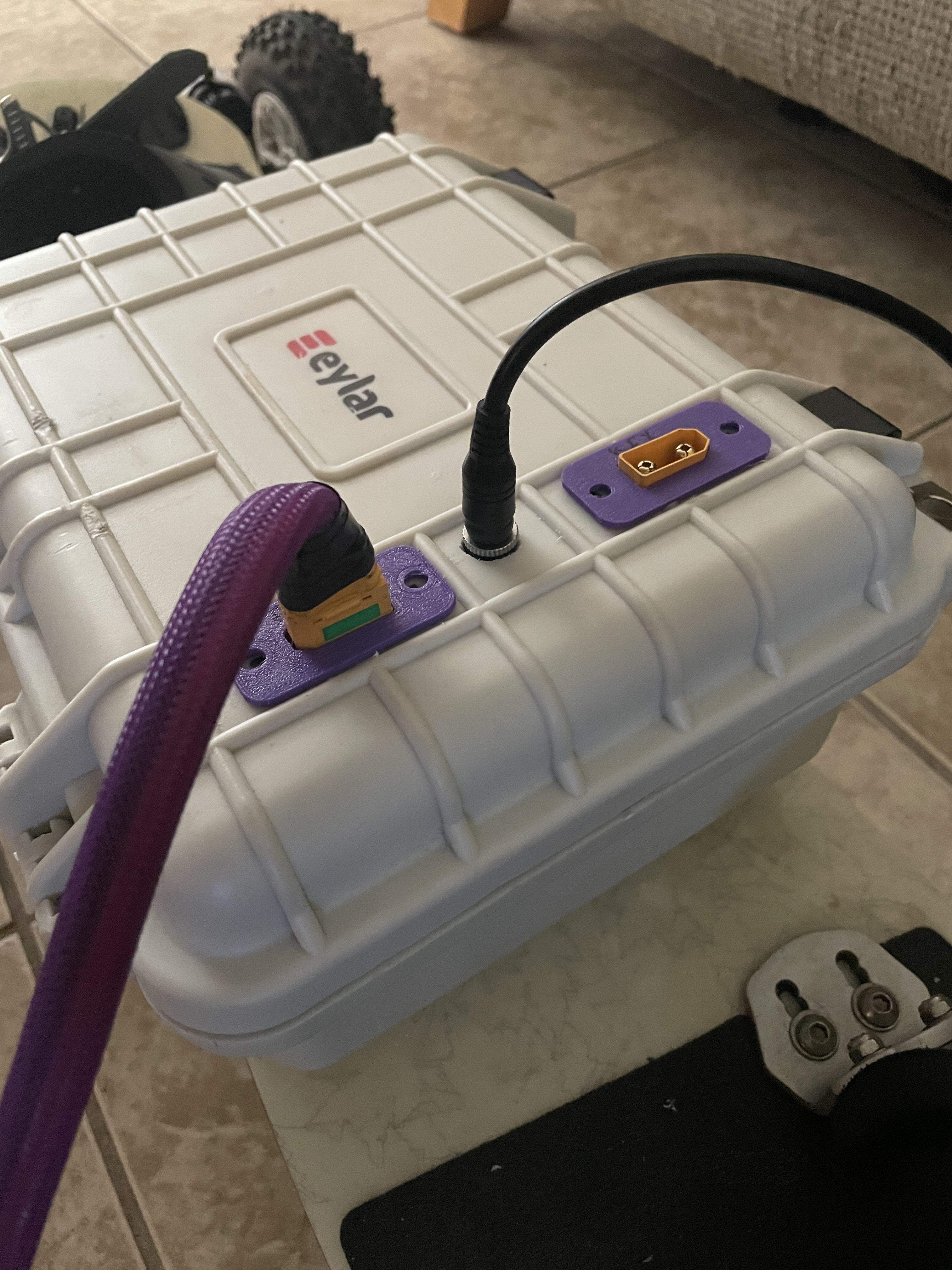

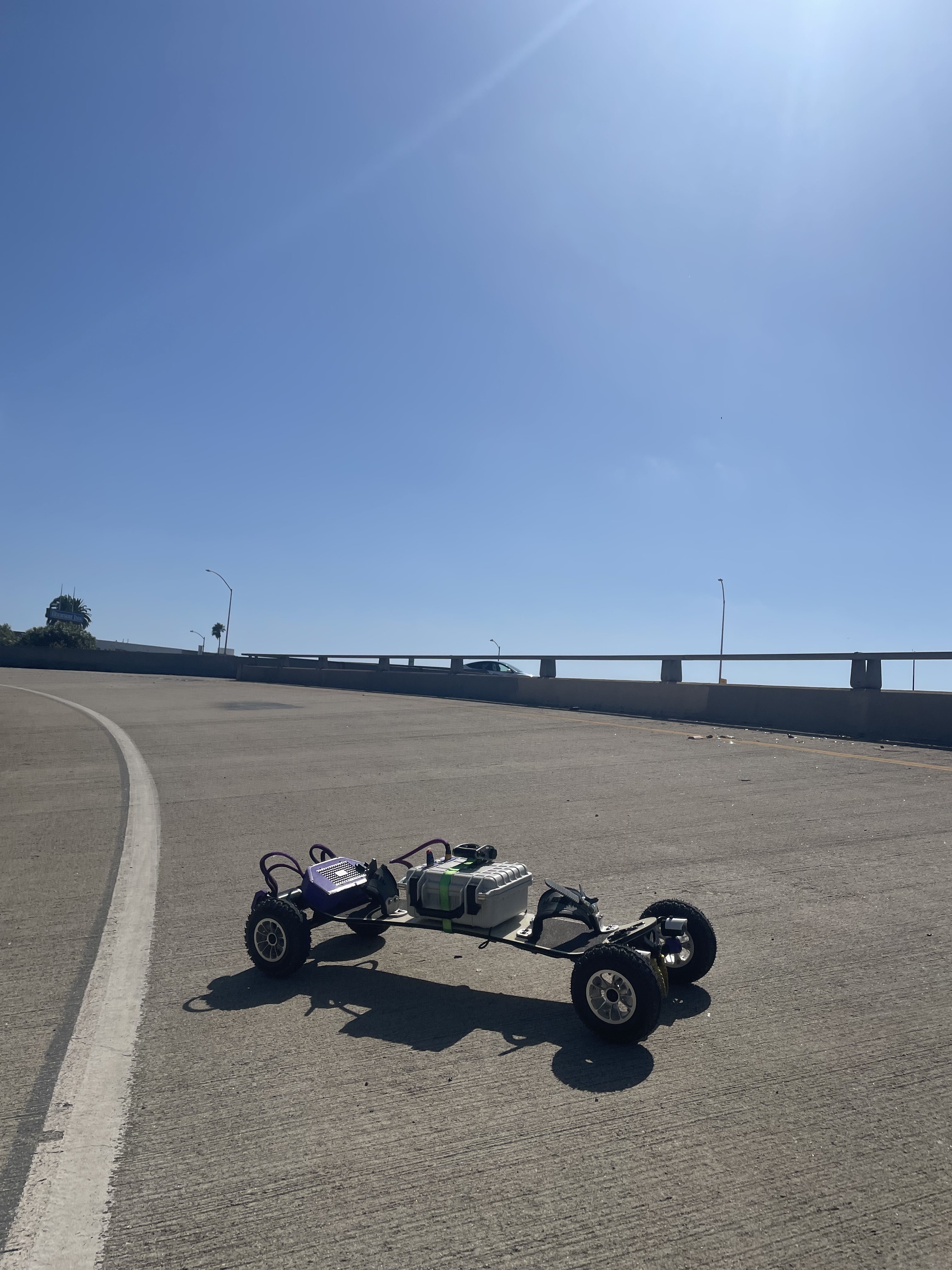

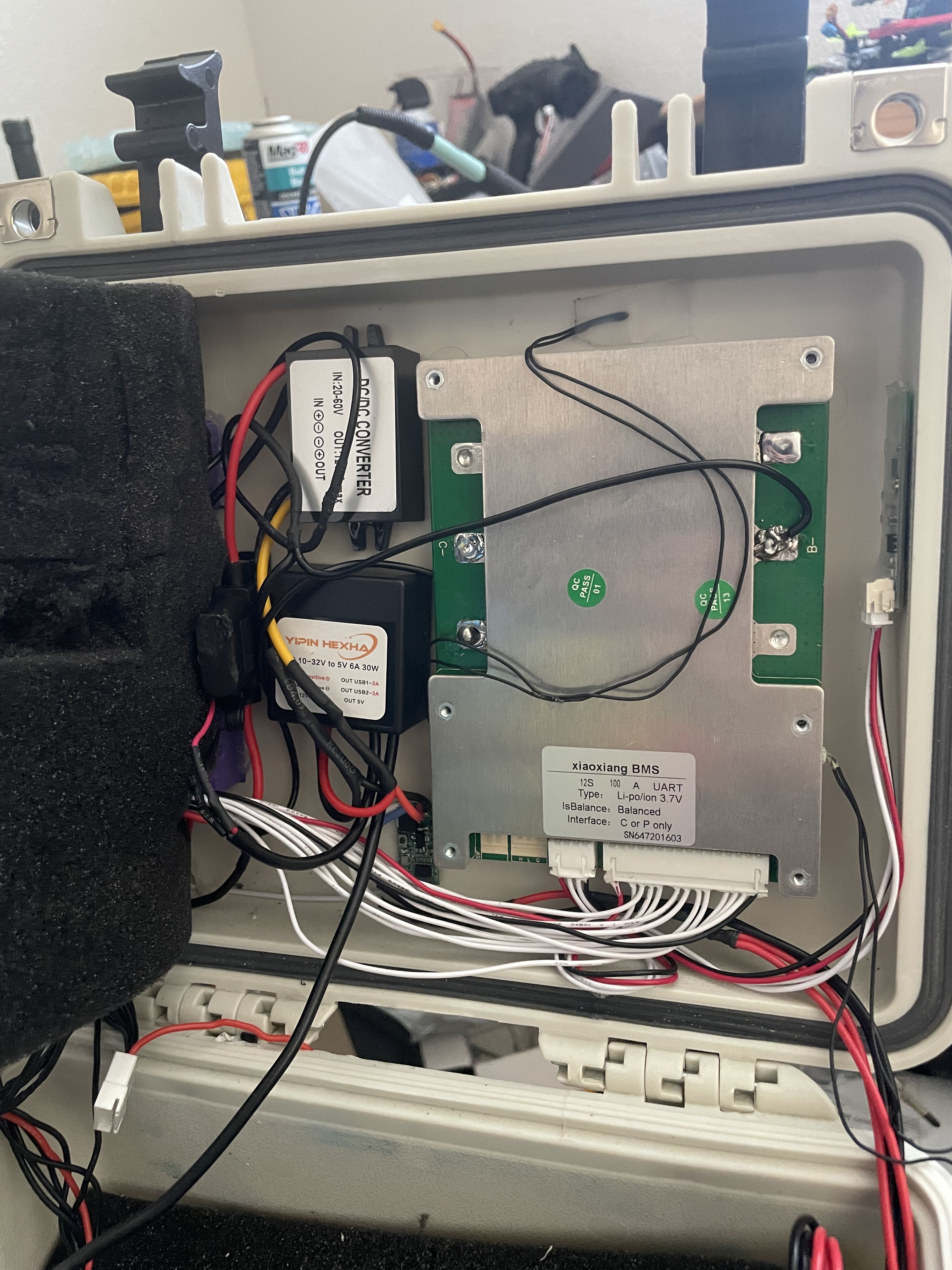

Finally got the charge port installed, I been lacking and keep forgetting but I got tired of opening the box
Just got back from a 14 mile ride
Turned the amps up a little bit more to 65a battery and it’s riding very similar to how it felt before, I was running just a touch more before it blew
I was worried about the lipos ballooning and getting too old but they are still in great shape and hold charge great
No hard sag until 3.6v a cell which all things considered is pretty good, and they are good for 200a before they start to become unhappy

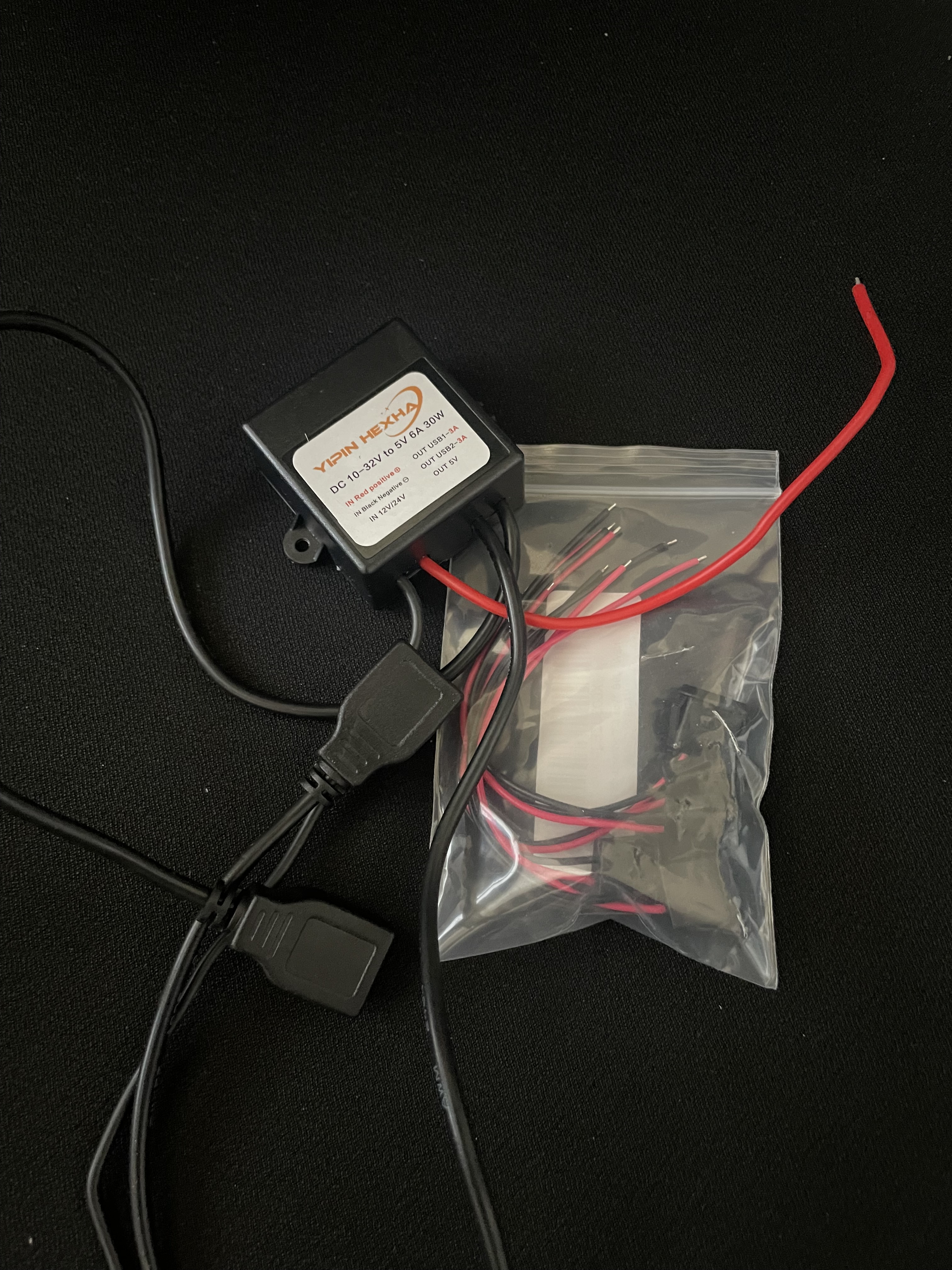

I have also have had this 12v to 5v usb converter and usb C ports on my bench for a couple weeks now and I just remembered I wanted to put that in as well so I can charge my phone, I think i’m going to tackle that tonight
Well now there’s really a lot going on in my top box top lol
I got the port installed and left I usb A on the inside just in case, Upon plugging my phone into the port nothing happened, turns out I bought power in, not power out, for the usb c ports (I guess that is a thing) so they will receive power, but not give it
I’m just going to unsolder it, cap the ends with shrink tubing, and order the right ones
Classic
says electric also but maybe this would be an option
How are you running a 10-32vdc to 5v converter /usb power supply from 12s?
There’s a little bit of magic that’s all scrambled up in there
No just kidding
The converter above the 10v-32v step down to 5v, is a 20v-60v step down to 12v 15a I believe
It’s wired in before the switch to the lights, so it always has power, but the lights still have their switch to power on and off
When I put the first converter in for the lights I figured I might as well order one for charging, as i’ve gotten in the situation before where i’ve been stuck somewhere with my board, and no way to charge my phone
I left a usb a port on the inside of the case so for the time being it still works, just a little hard to get to
