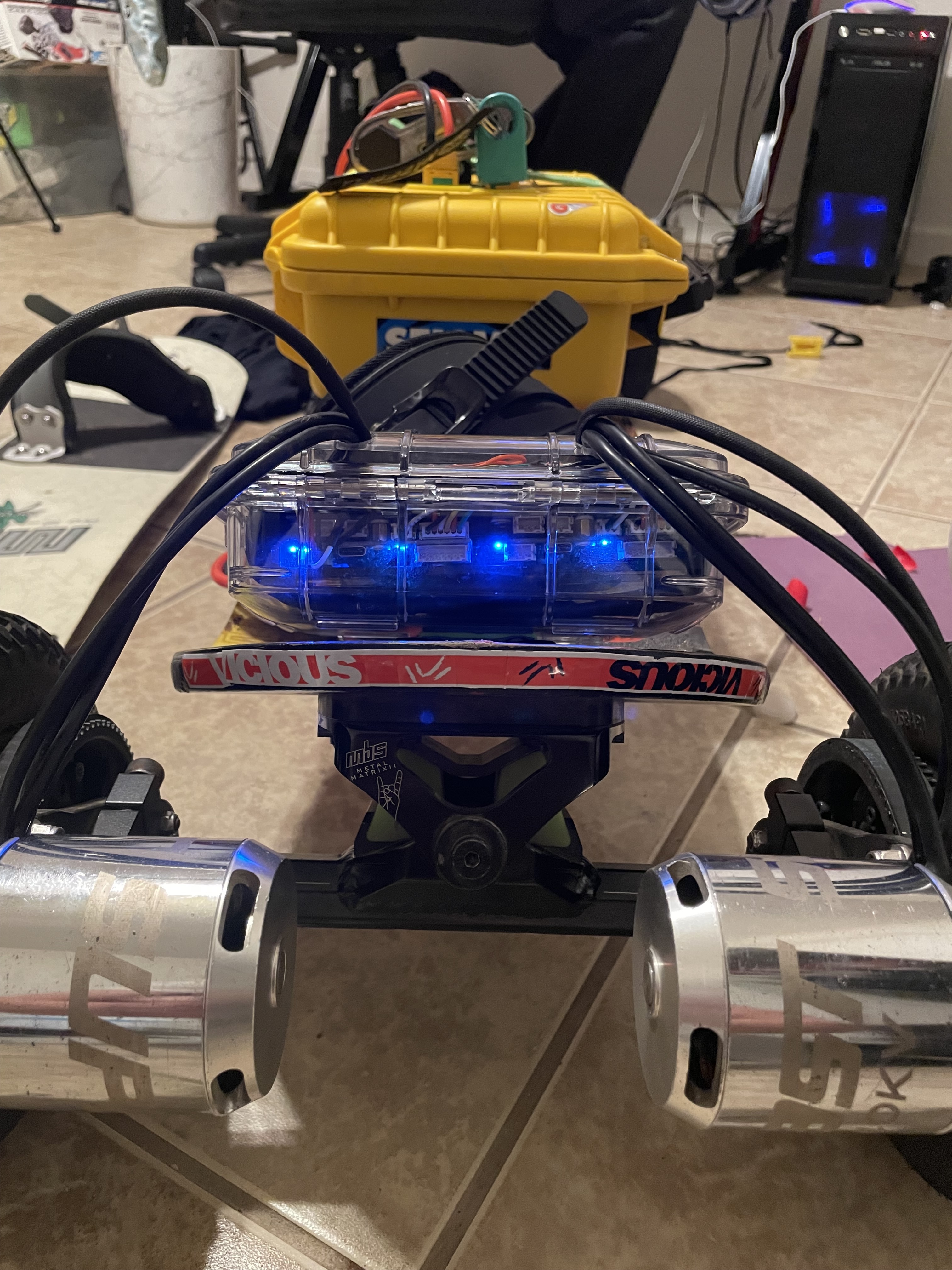

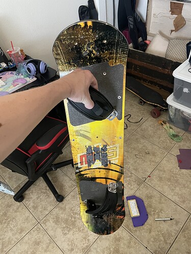

So firstly I was riding my Banana for a decent amount of time before the tenka in it did what tenkas do.
The week of it retiring I was looking at putting a new set of motors on it, which ended up not being that week as I had to get some more funds to get a vesc.
Ended up getting some SKP solos which are absolutely amazing (and have really cool lights if you put them in a clear enclosure).
Didn’t even realize them until my gf took a video at night of me flying by. Super sick.

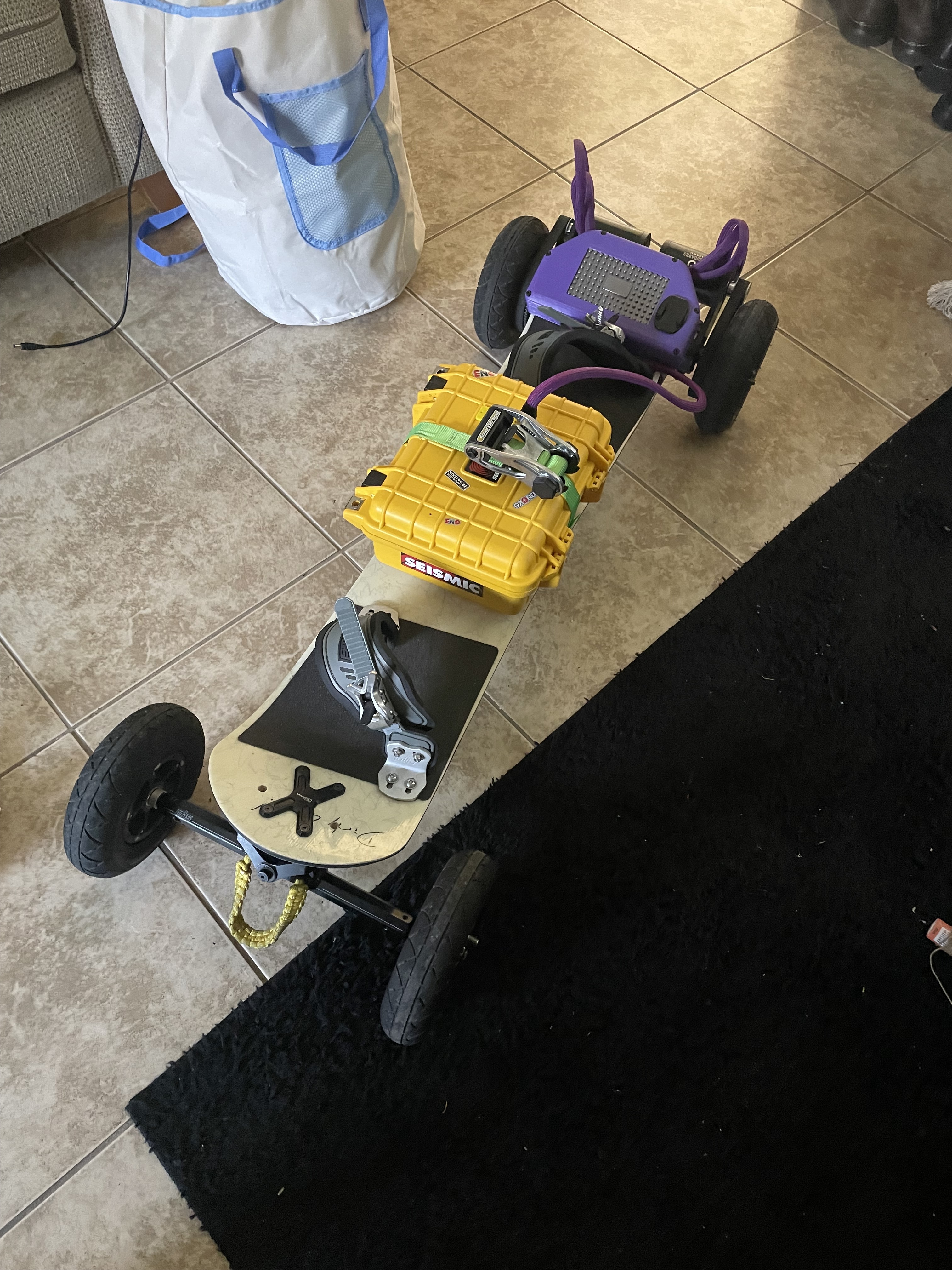

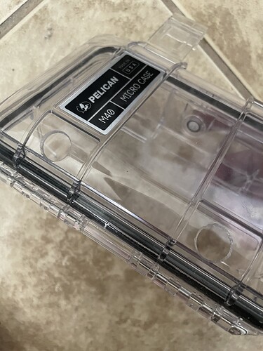

The pelican case is a M40 Pelican that was wayyyyy too small to fit everything in but for the time being it worked.

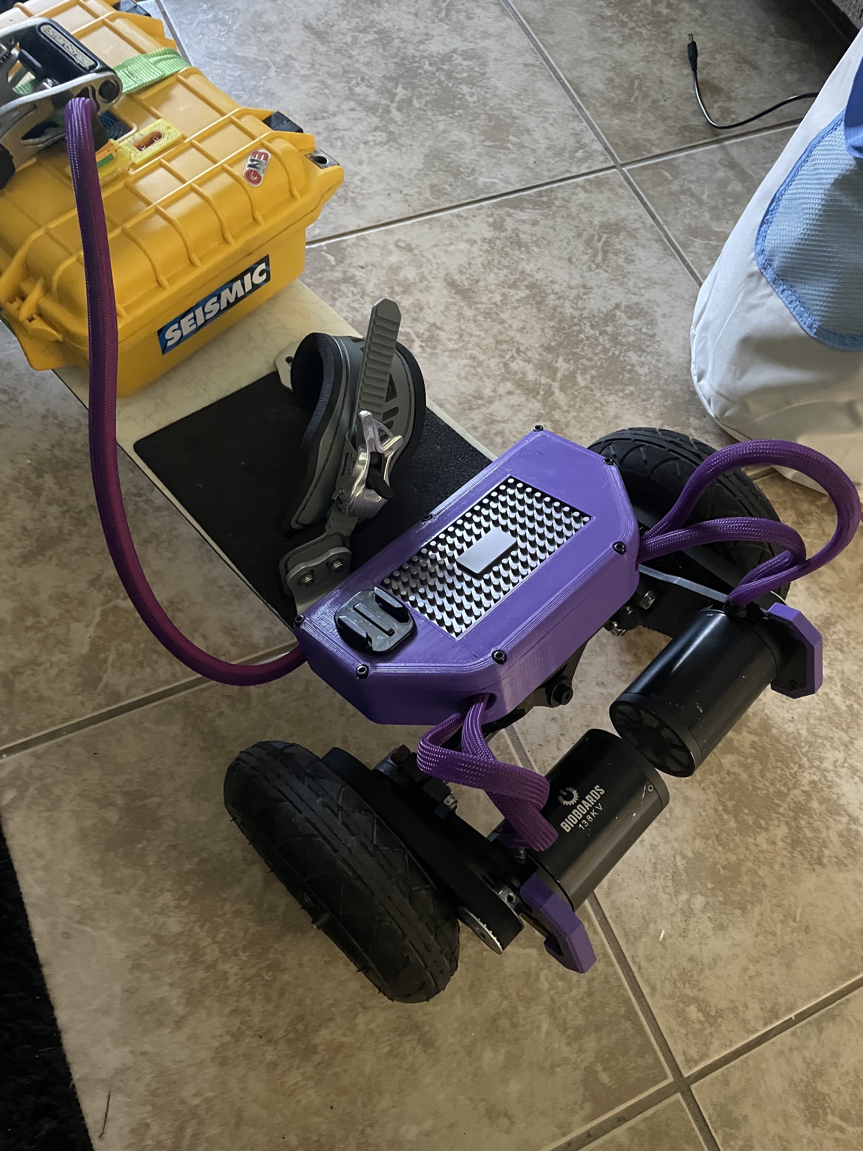

After running this Jank setup for a couple days I received a set of 65100 Bioboard motors from @OzzysPaw (Shoutout, they rip and big homie for sending an extra couple bearings for the can) and I decided it was time to switch them over.

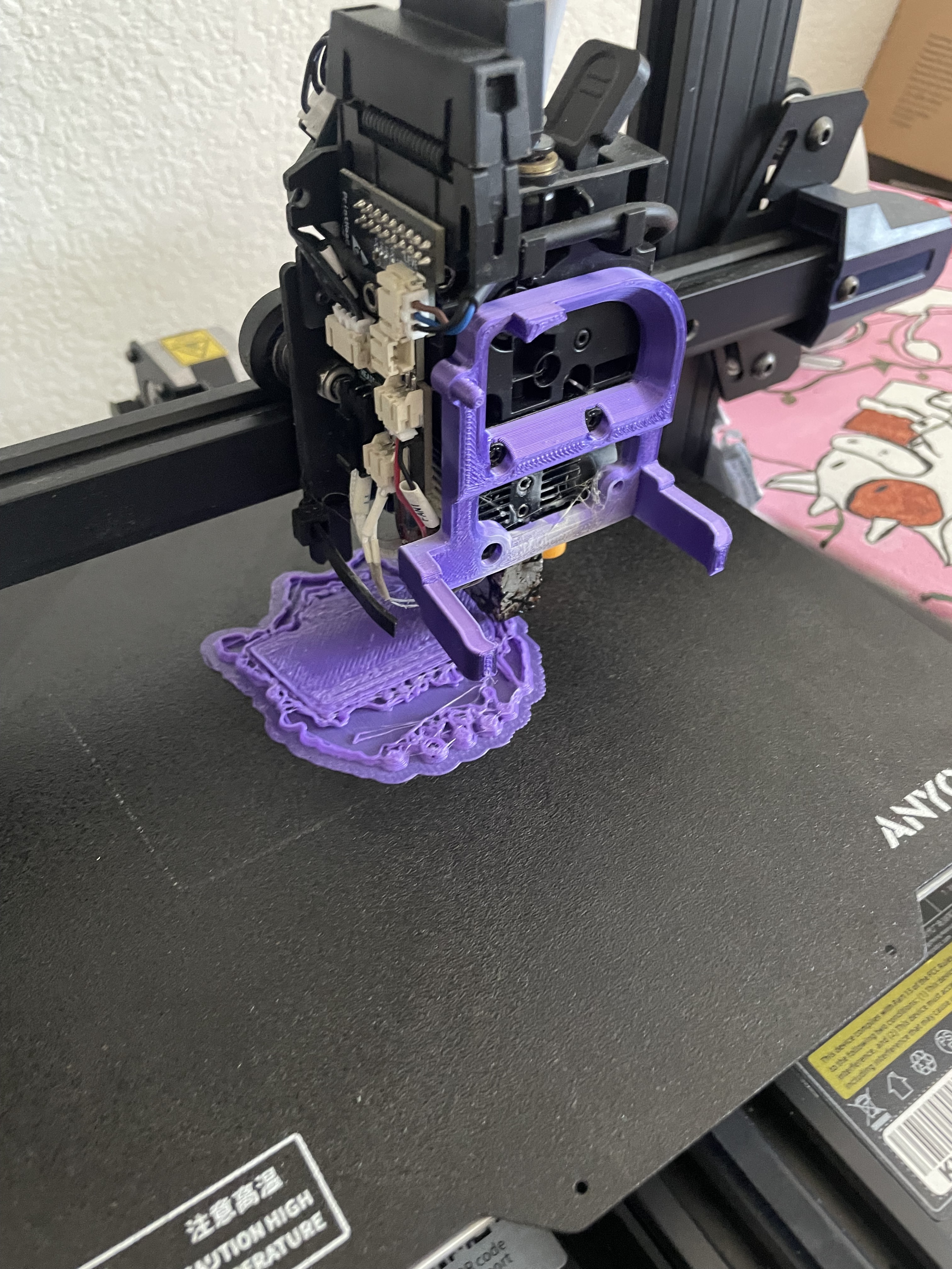

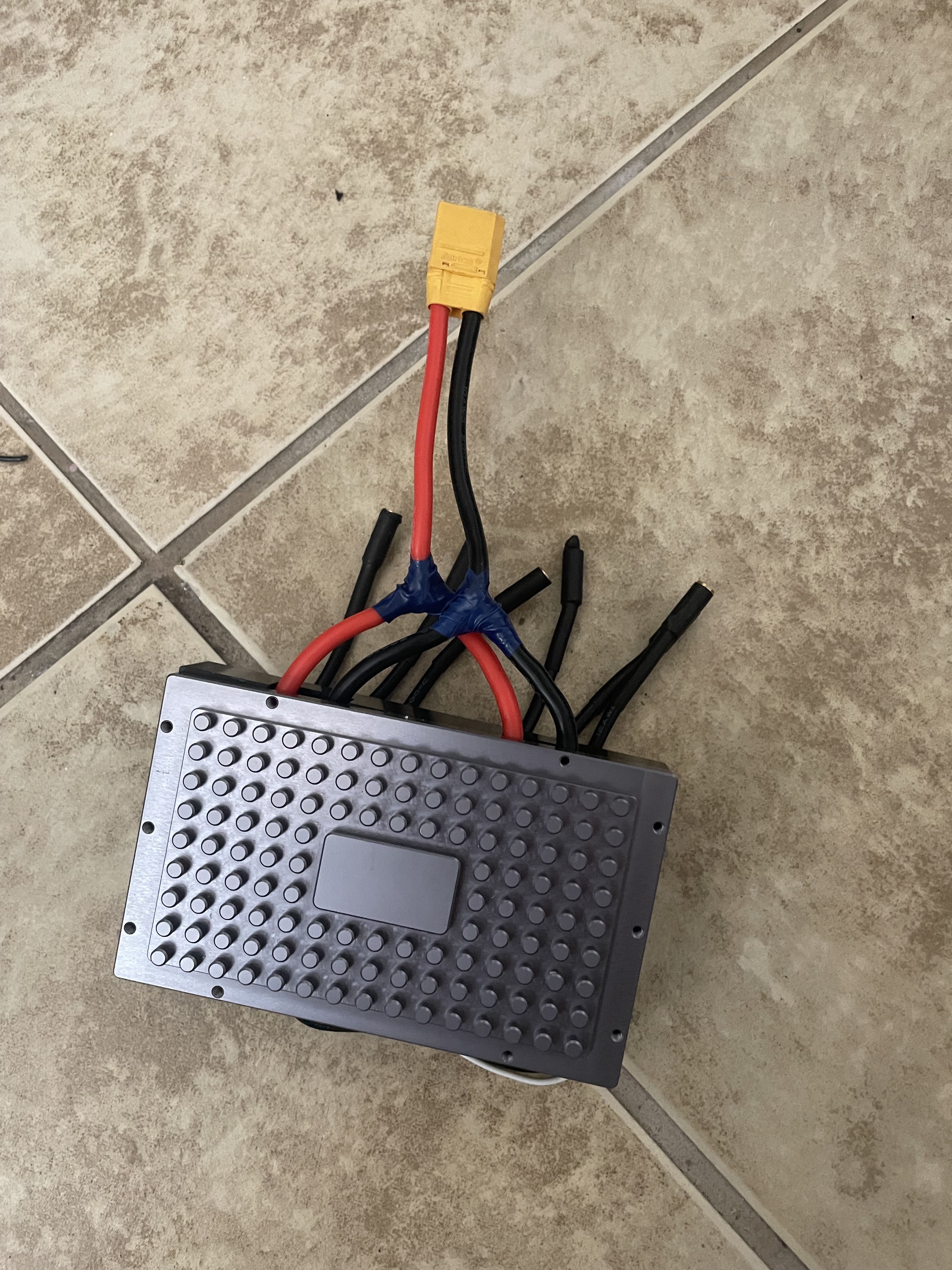

I didn’t wanna use the pelican case, as I was worried about it getting too hot with the heatsink on the inside so I printed the same enclosure I had on the Banana, but in purple and with a hold for the heat sink.

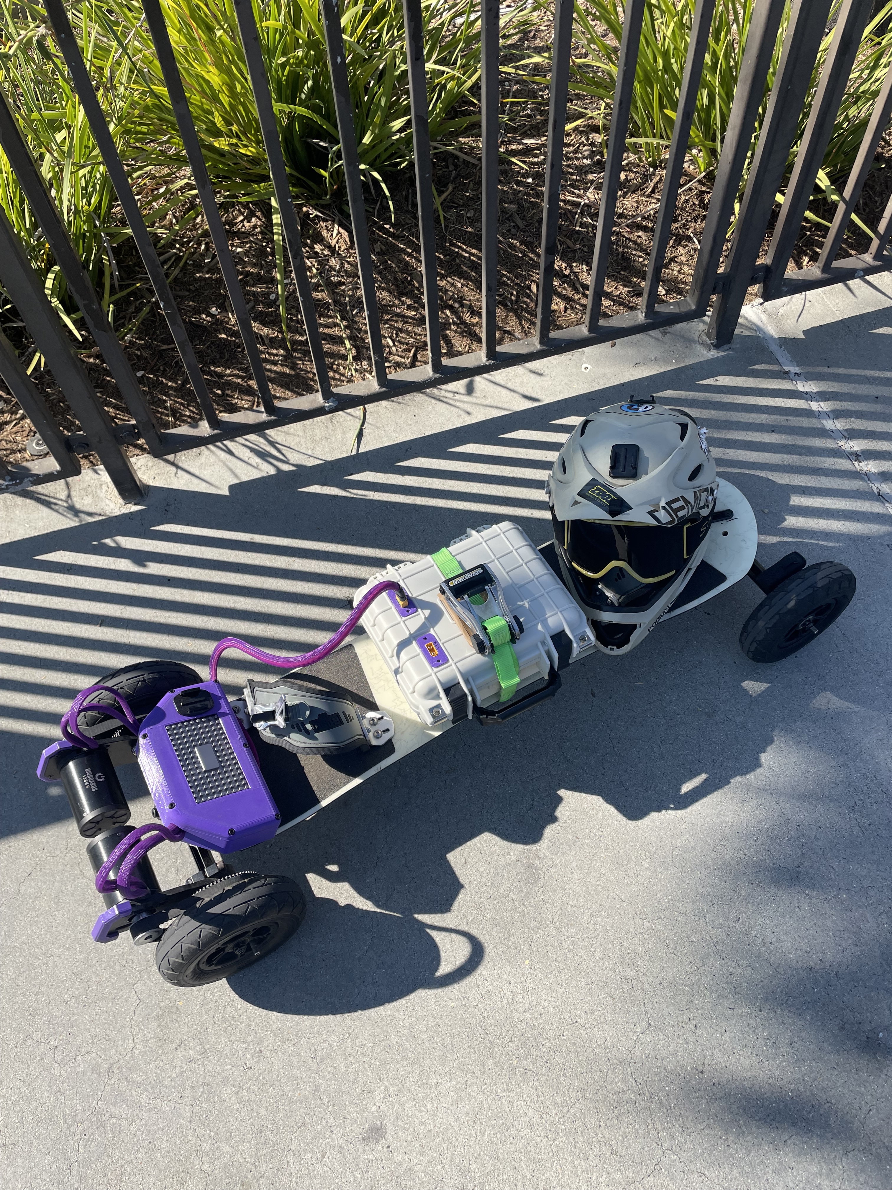

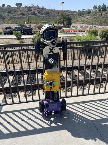

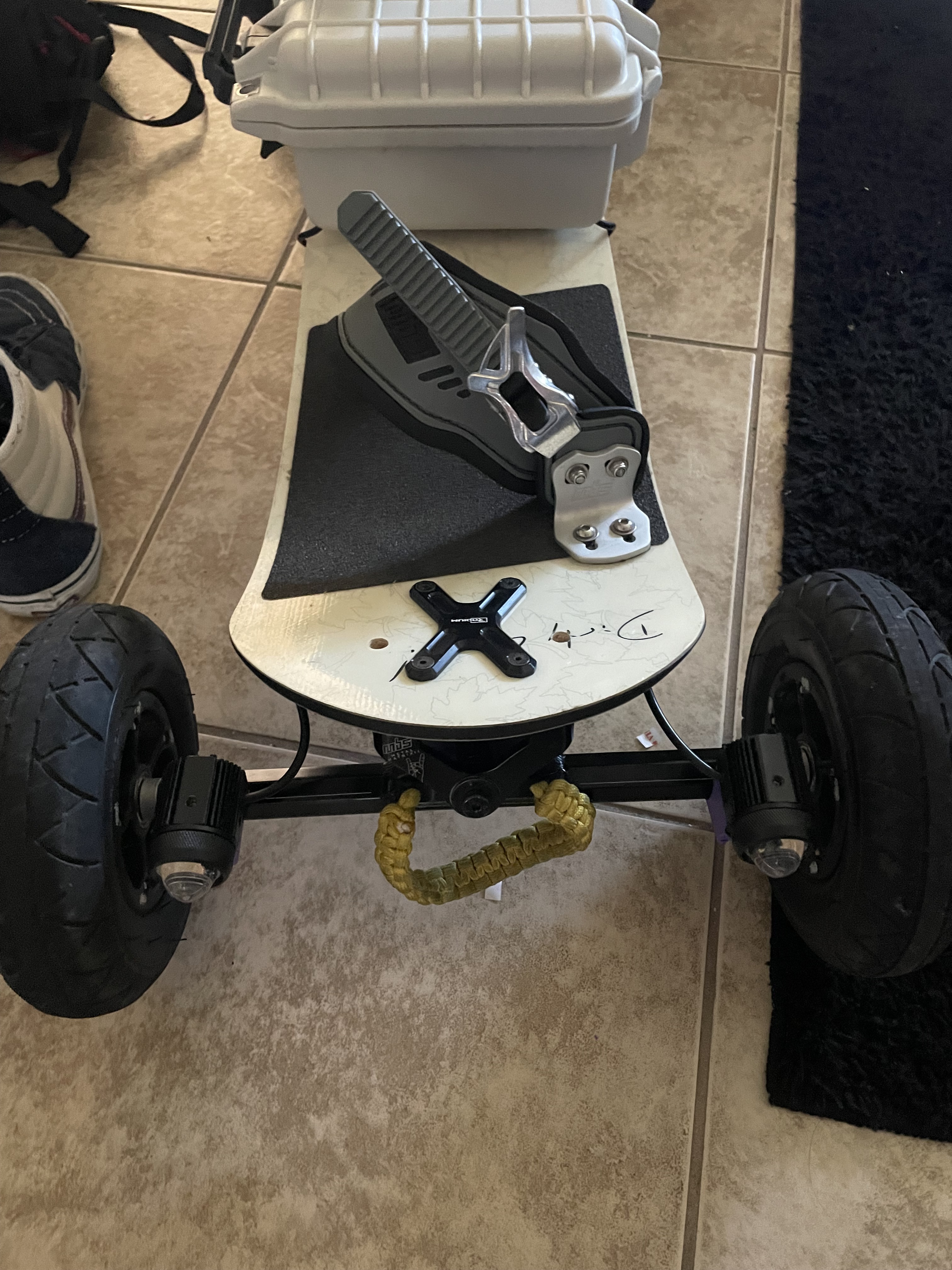

Now I know you might be thinking, what?! Yellow and purple that’s a lakers board, well i’m one step ahead of you.
I got a screaming deal on a Jeremy Leafe Pro deck that is white and matches up with the purple pretty nicely.
Tossed a set of street tires on the back and it’s looking really good. I have a white top box that is on the way so i’m hoping to get a sick white to purple from front to back. And i’ve been looking at wheels too so if anyone has a white set of wheels im interested.

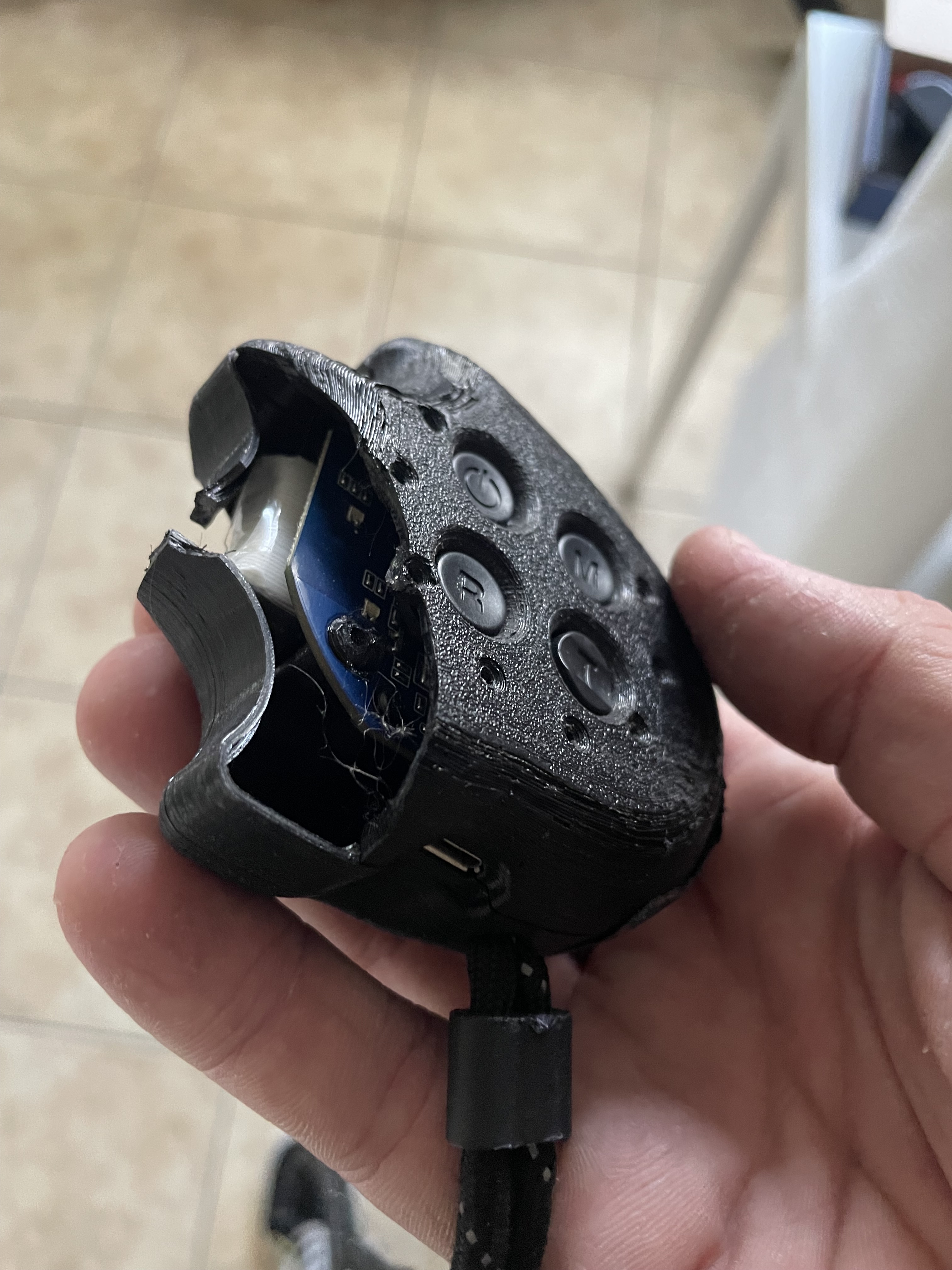

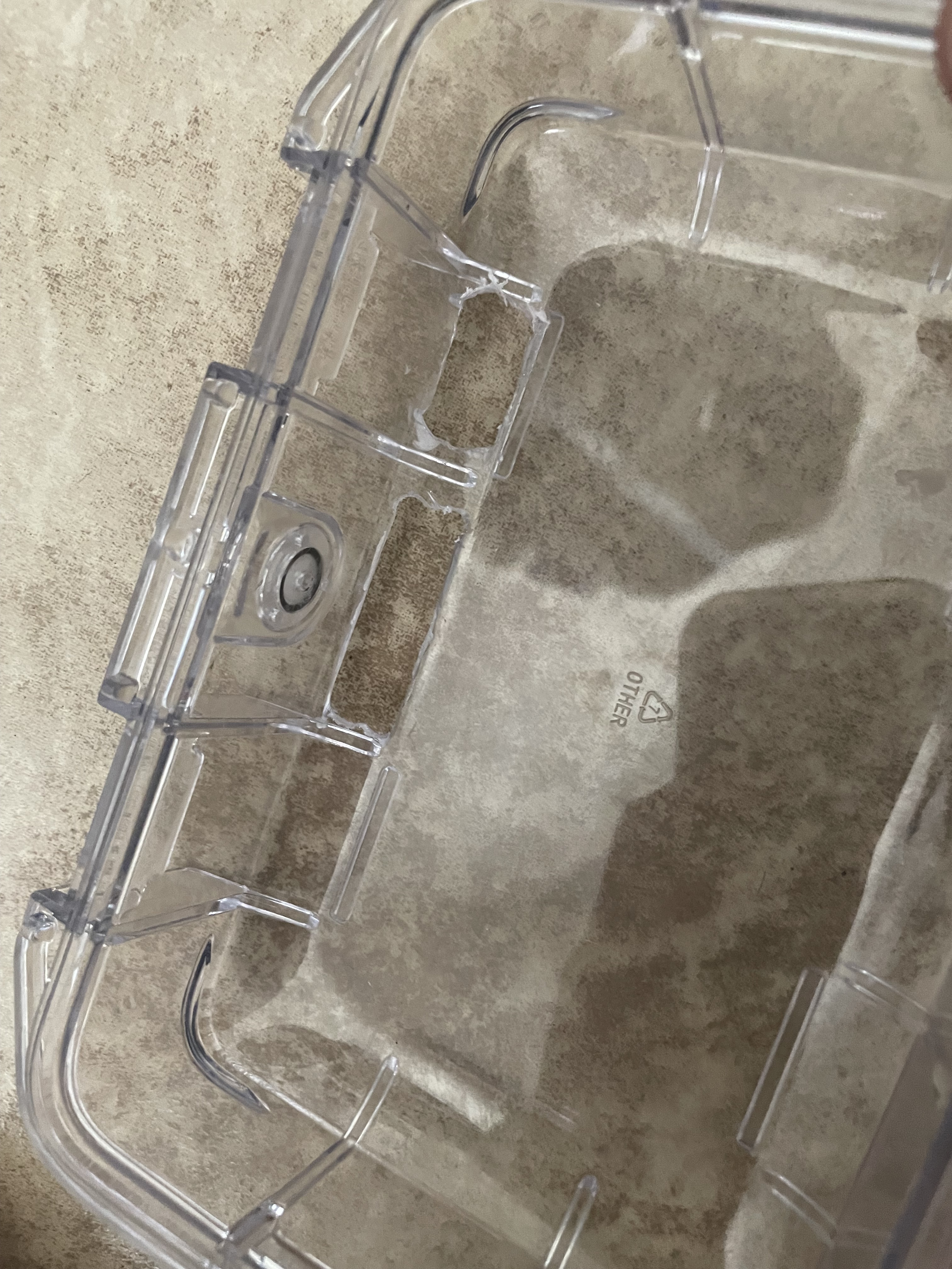

Only one setback so far and that was on the first test ride I was running to the store which is only about 1500ft from my place. Decidedly it was not a great idea bc I didn’t double check my motor current and brake current and it turns out it was up at 120a and -120a so I grabbed some brake after zooming in the parking lot and it locked it up at about 25mph.
Luckily the helmet and gloves I was wearing did its job and for wearing shorts and a t shirt I have no road rash other than some scuffed elbows
Major casualties include Batwing XL Case, Work hat, and big right buttcheek bruise (not pictured, behind $5 pay wall)
New matching case on the way now, wasn’t going to do it right away but you forced my hand puck.

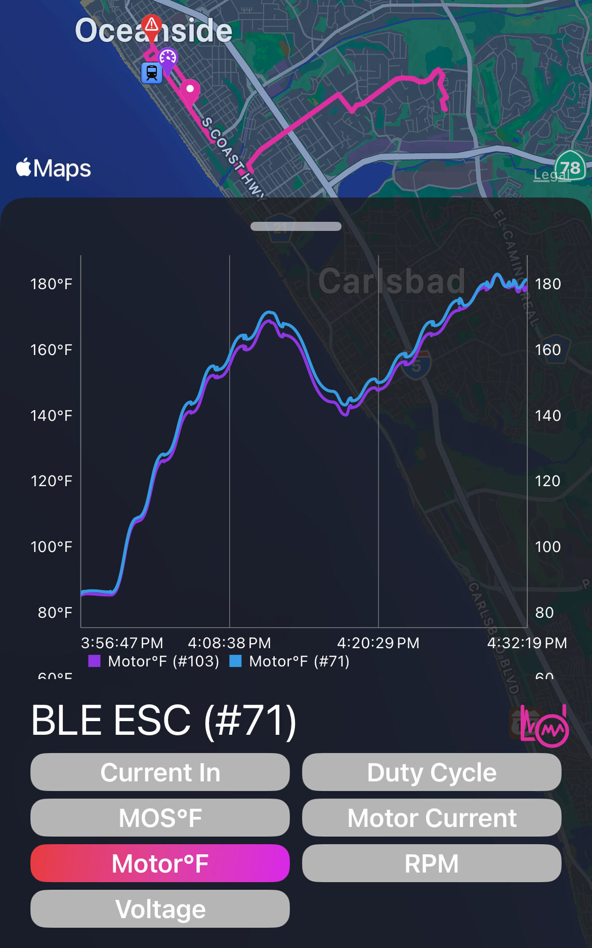

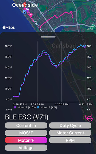

Just over 11 miles and I ended up hitting an Overtemp on one of my motors. Or both
A guy let me go at a stop sign cause he saw I was ripping and when I went to give it power it felt like I had accidentally pressed the M button on my puck, it just barely kept going as I was going up hill and then it started to pick up a little bit.
I got home and noticed my motor temp cutoff was set at 85C which seemed a little low so I pumped it up to 100C and we should be fine now.

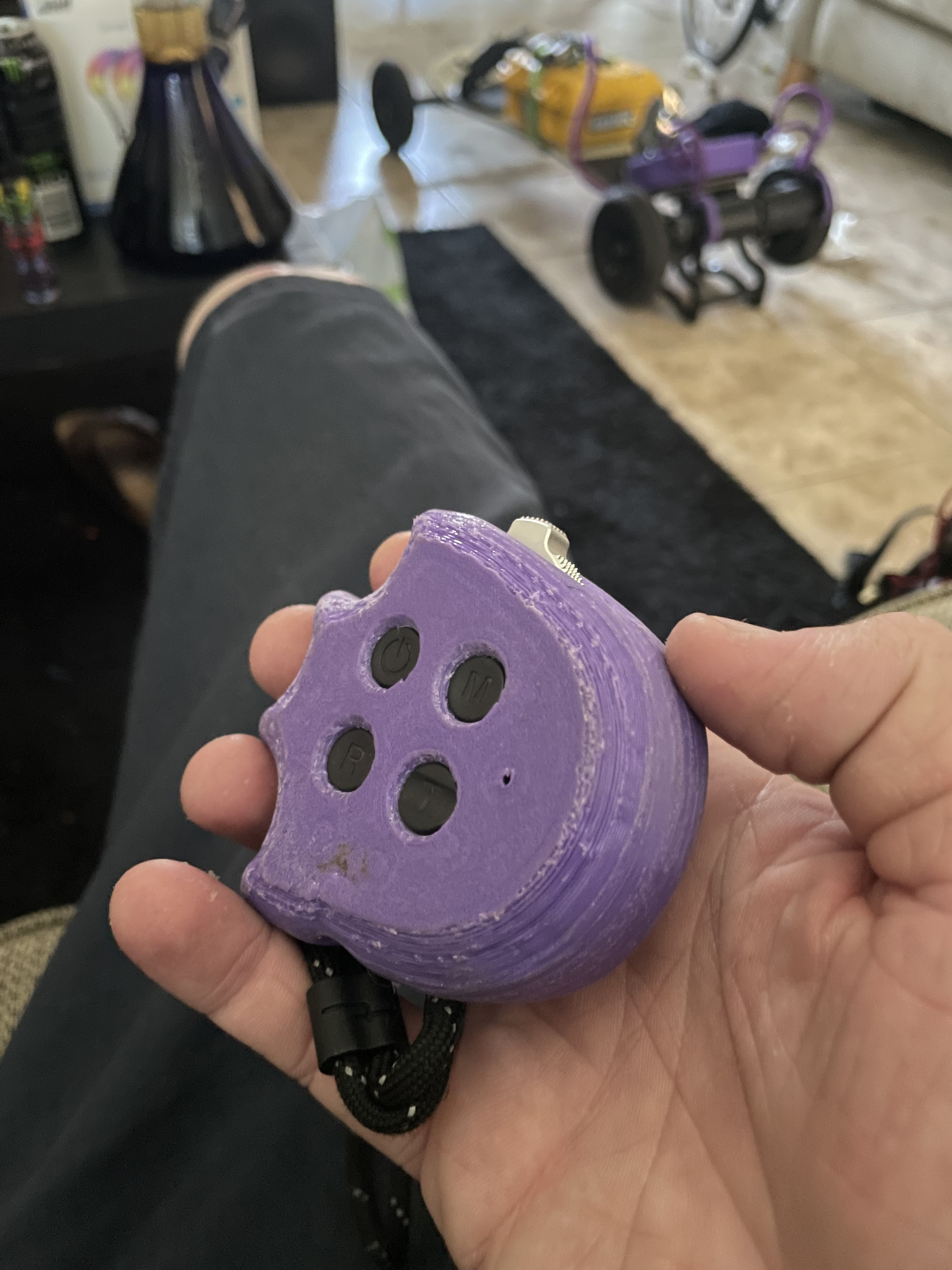

Oh and the Purple Batwing XL is alllll done fits nicely and works well.
Damn these 3d printer things really make you start to hate non open source things, if I didn’t have a puck I would be stuck trying to find a new remote.

Yup, those motors can take high temps. I usually ran mine at 100/110 for the soft and hard cuts and only got close to the hard cut when riding hard in the hottest of weather.
That is what I figured. They definitely seem hot but they don’t seem to care.
It’s definitely hot near me so I put my hard cut at 115 soft cut at 100.
If I hit it again I will probably raise it, I just did it for posterity. It’s been 85F everyday here near the ocean and I work where it’s 95F a little more inland. So better safe than sorry imo.

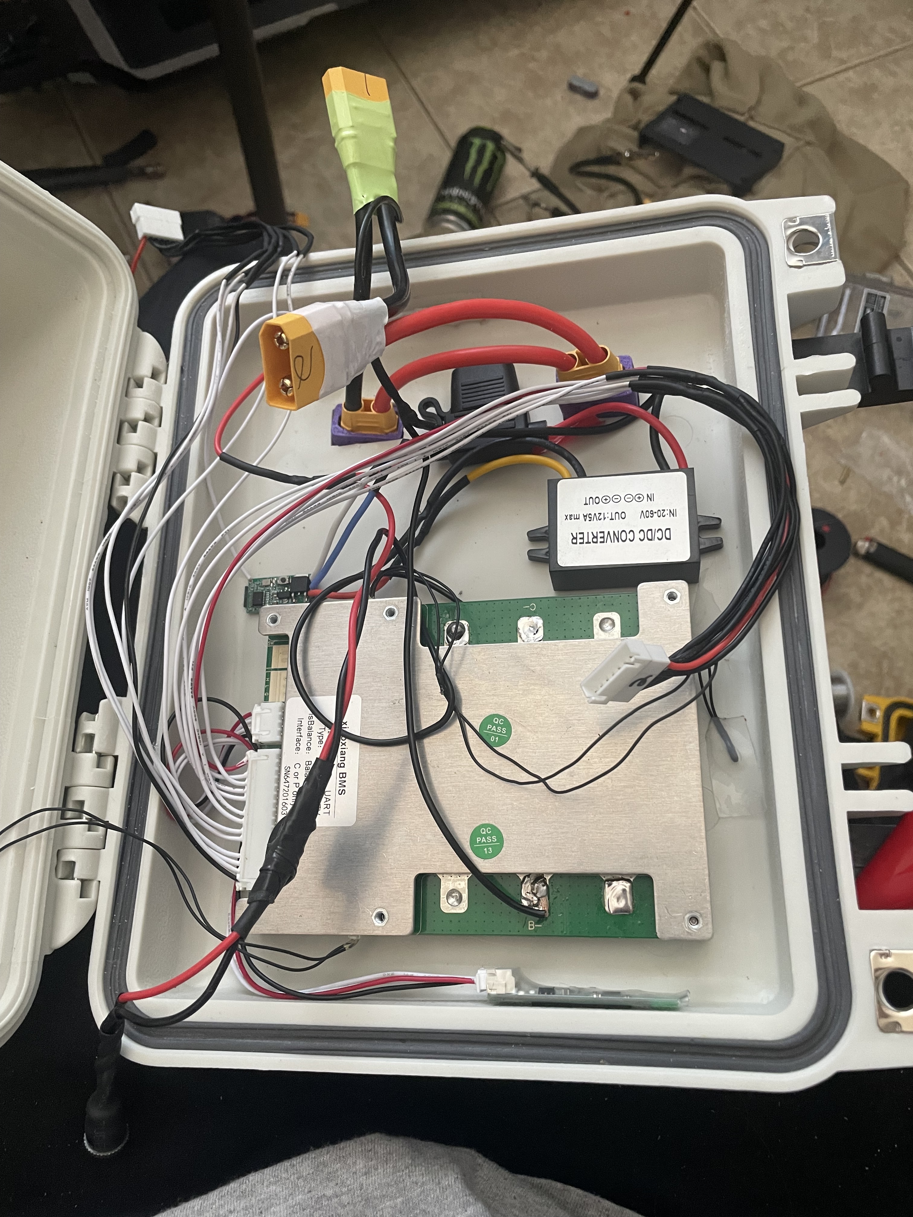

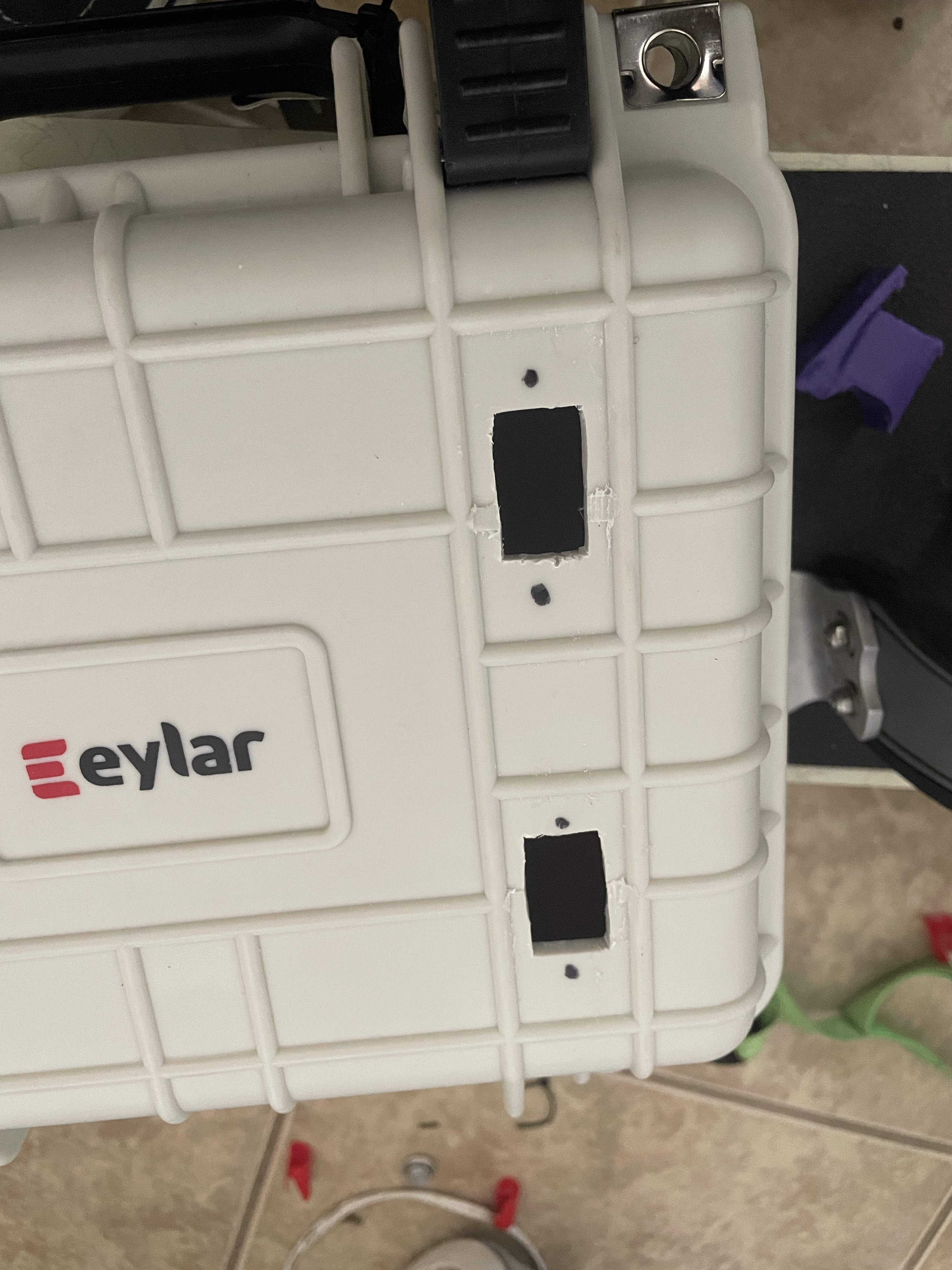

Okay finally got to getting the new box on and converter put in for lights, just needed to order screws so i’m waiting on those and then I will get the lights put on
Cutting the holes out for the loop key and power came out really good imo
I don’t have any photos yet as it’s not all the way done but I did get a photo of everything wired
There’s a lil something in there that I will leave it up to guess what it is until I get the lights put on and finished, but so far it’s sweet.
Now it looks a heck of a lot better and with the lights it’ll be even better :slightly_smiling_face:

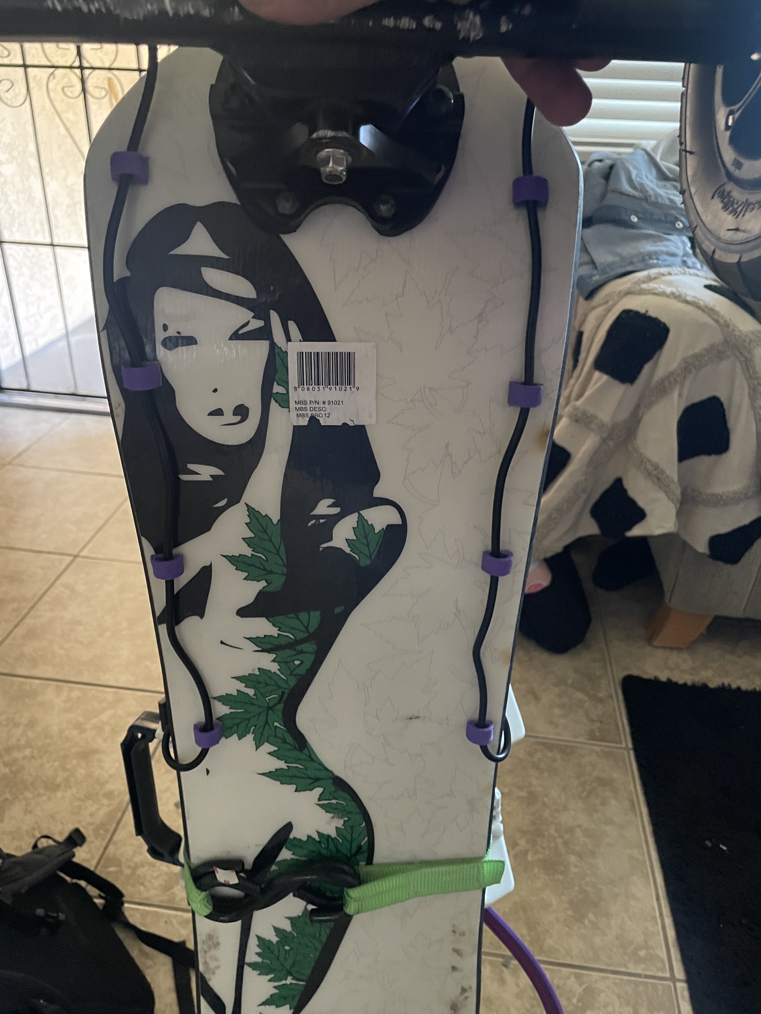

Riding good. I think the deck is too small for my 6’2” stature as I start to get a wobble around 30ish just from my stance. Looking a some deck options and will probably end up with a trampa deck for the size.
You should consider to pickup a tomiboi deck over 40 inches or a flux deck.
Tomiboi can customise the flex for your preference, with the flux you only have one option for flex, but both are great decks and I would choose either before considering a trampa personally
Thank you for the recommendations!
I just checked both of them out and I think I would agree with you lol.
I think I might pick up a flux deck if I can find one second hand, but that big 40” mtb deck from tomiboi is pretty sweet, just a hard bill to swallow for me.
