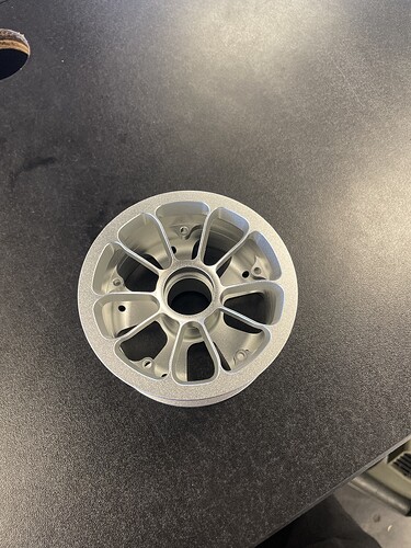

Shoutout @KaramQ for the BN hubs and hangin out makin my shift a lil less boring lol
I’ll be letting you know about those channels/gear drives mf you ain’t helping my wallet at all lol.

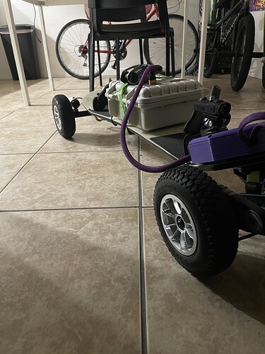

OOOH She’s lookin spicy with the new wheels
I’m going to ride like this for a few days and then pull them off and send the rear hubs to get anodized purple to match the fade.
Then she’s really be dialed in looks wise, before I step it up to 18s
ya that looks super clean!
love me some purp ![]()
