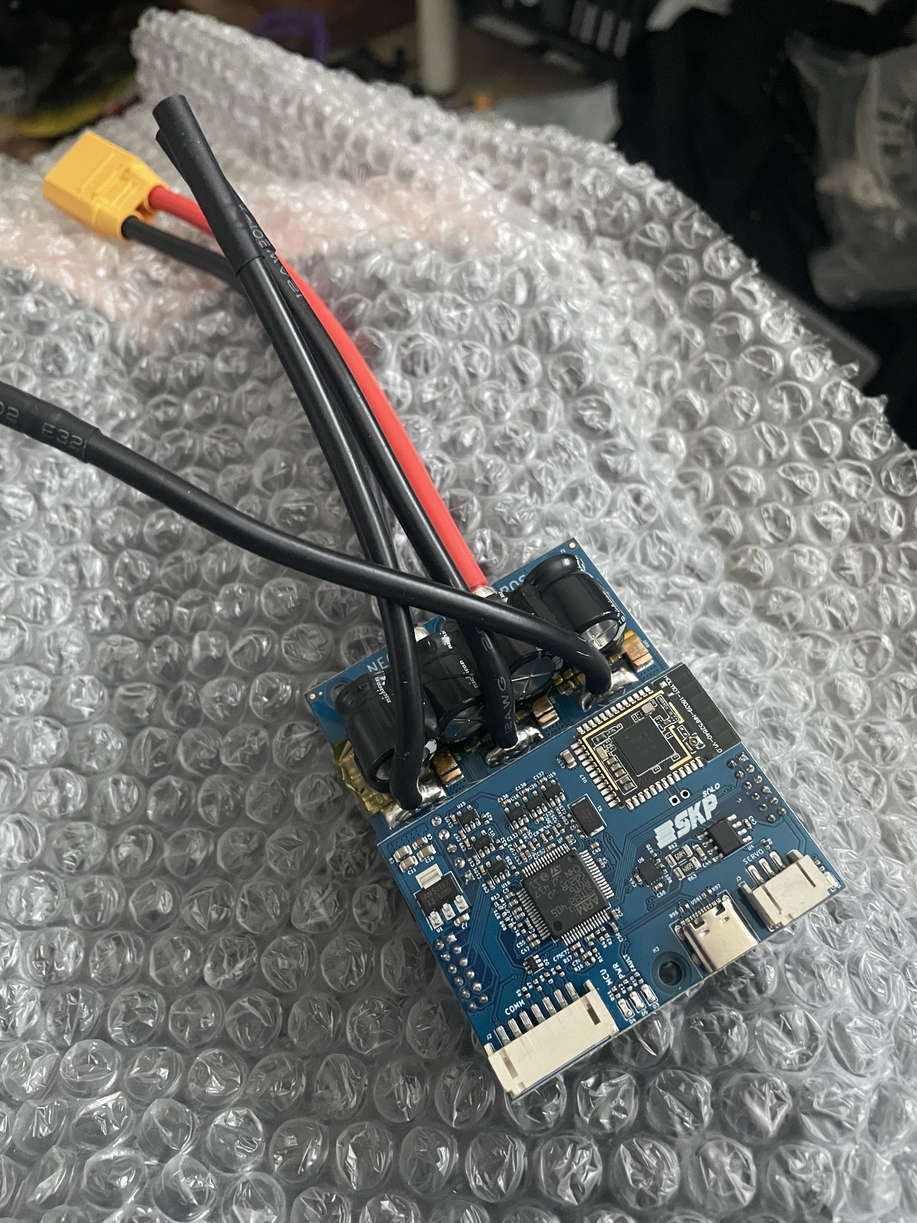

Looks like i’m the first person to lose a bootloader on a solo.
Big huge stinkin shoutout to @Skyart for taking the time tonight to walk me thru some things
Wasn’t able to get the SWD programmer to work right so it’ll be bricked for a couple days waiting on replacement pcb.
Buuuuuut I did get it all on gopro so you can hear me “whaaat nooooo” when it loses power.
That’s that vesc life. Glad to be apart of a community that helps each other out.

Rolled up to a light and just gave it some power up to about 30mph
I hit a pretty gnarly set of bumps and poof no more power.
Luckily I was able to pull of onto the side walk in time.

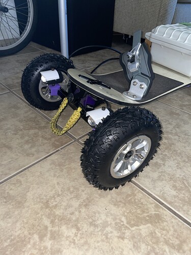

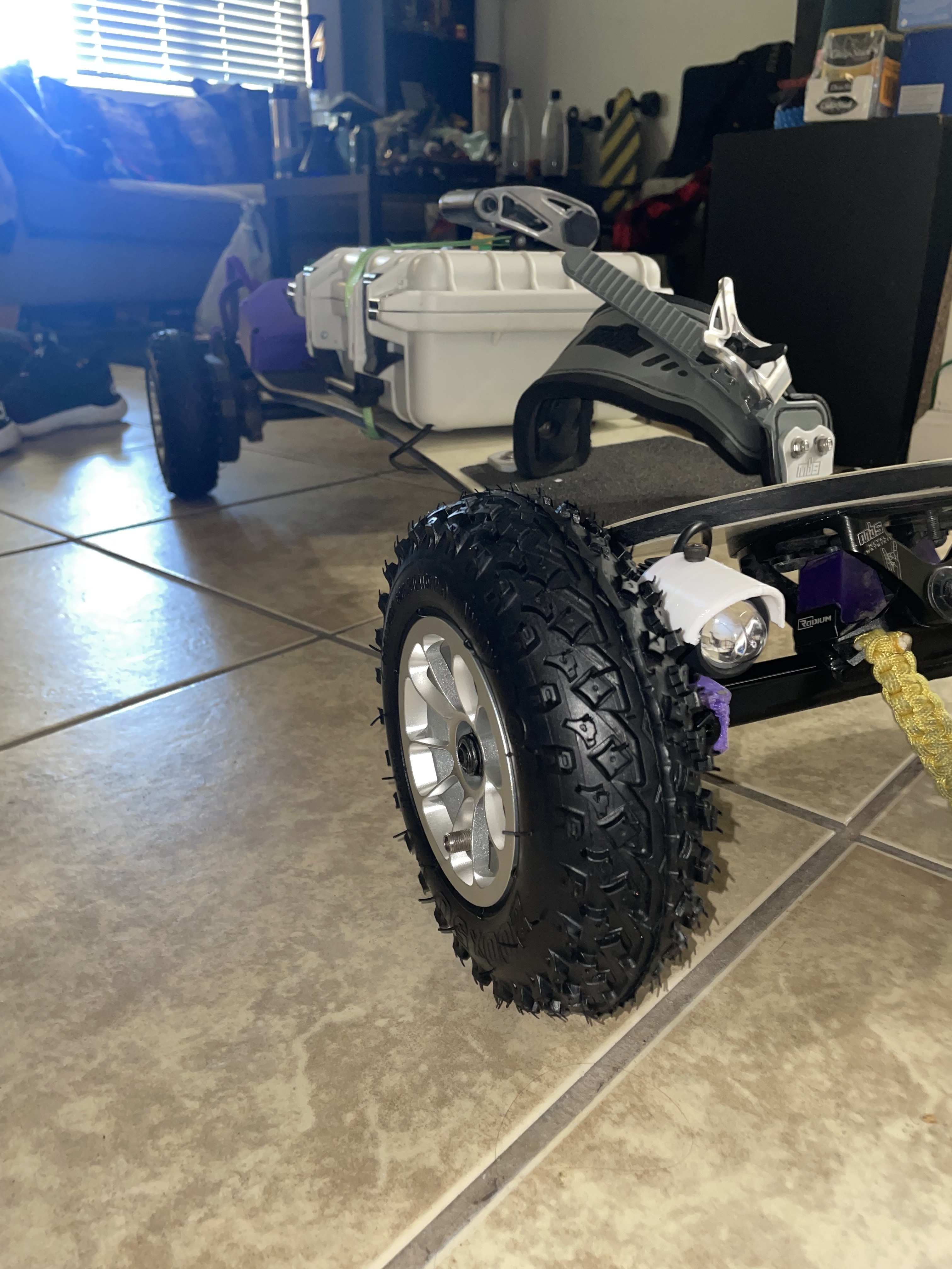

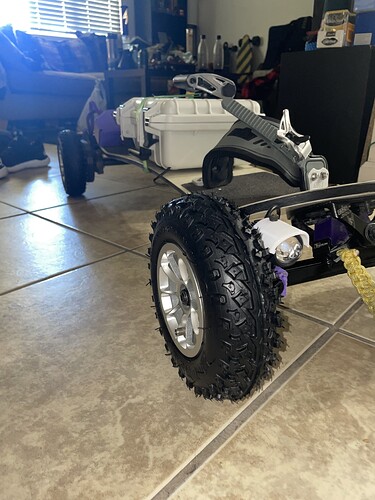

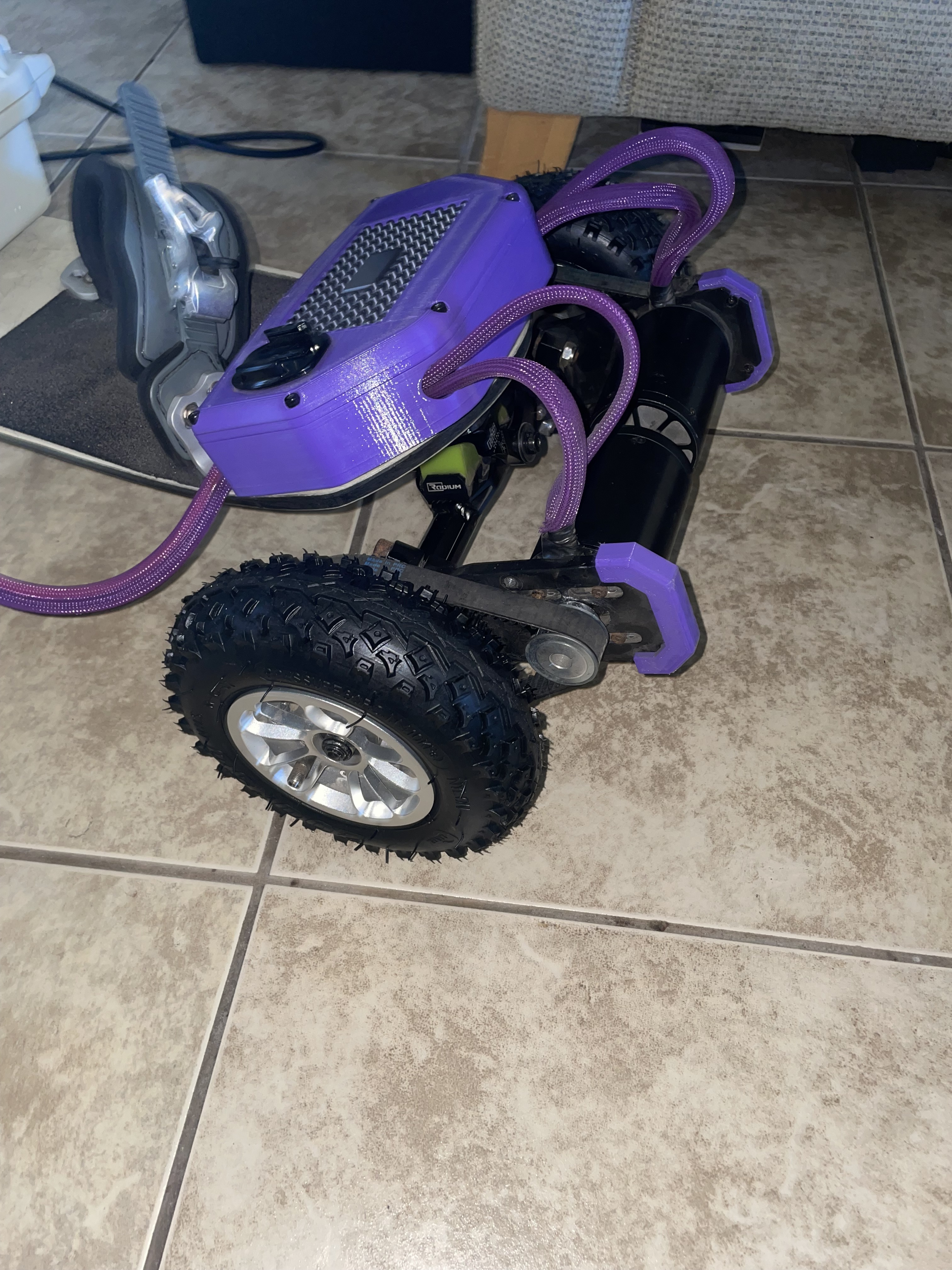

While I wait for that part to arrive I figured I might as well get the new tires tossed on
And ooooooooh they look pretty dang good
I did end up setting up just one side so I had one wheel drive to run to the store and back
But man it’s pretty odd with that one sided power so I was taking it slow
New pcb should be here tomorrow and i’ll be off to the races

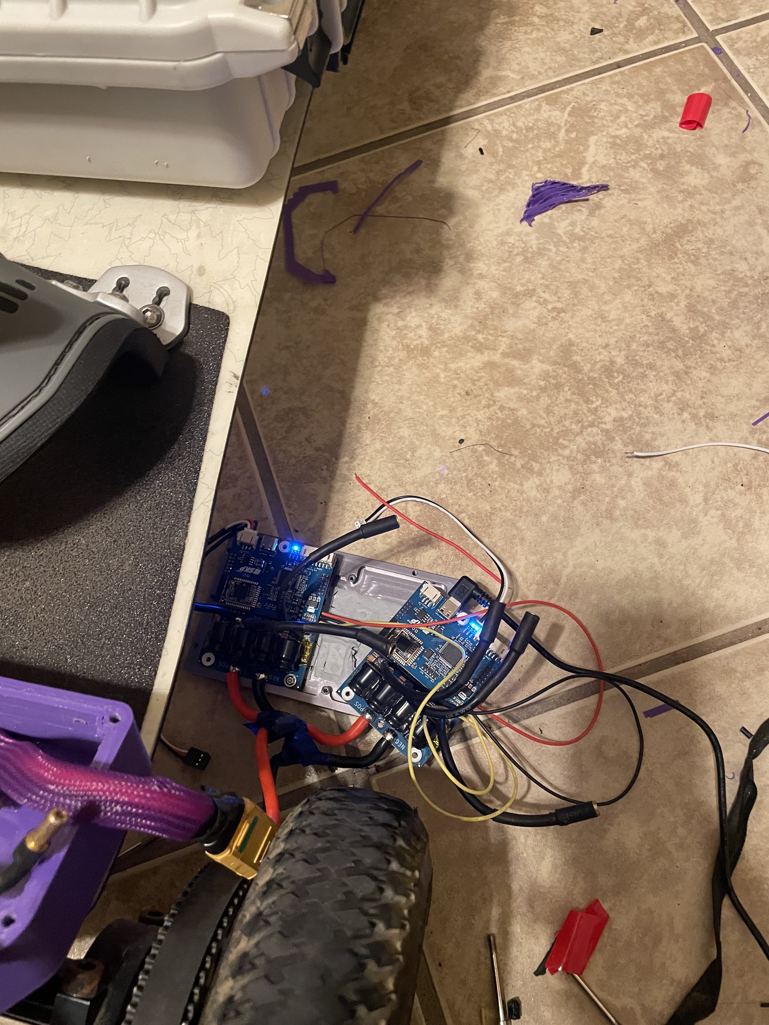

Well as it would turn out I did end up doing some damage to the Solo
Got the new top Pcb on and it had an eternal High Offset current sensor Fault
So I must’ve done something to it, waiting on a couple more things and then ill be back on the board

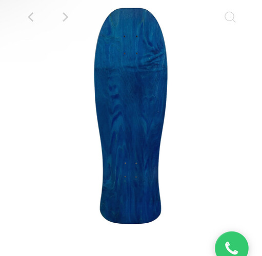

Anyone have recommendations for short board deck?
Looking for something like the big old school decks
Kinda like this but with a wider rear footpad
I’m going to deck swap my backup meepo bc while riding it I realize it sucks doody and would be sweet as a short deck

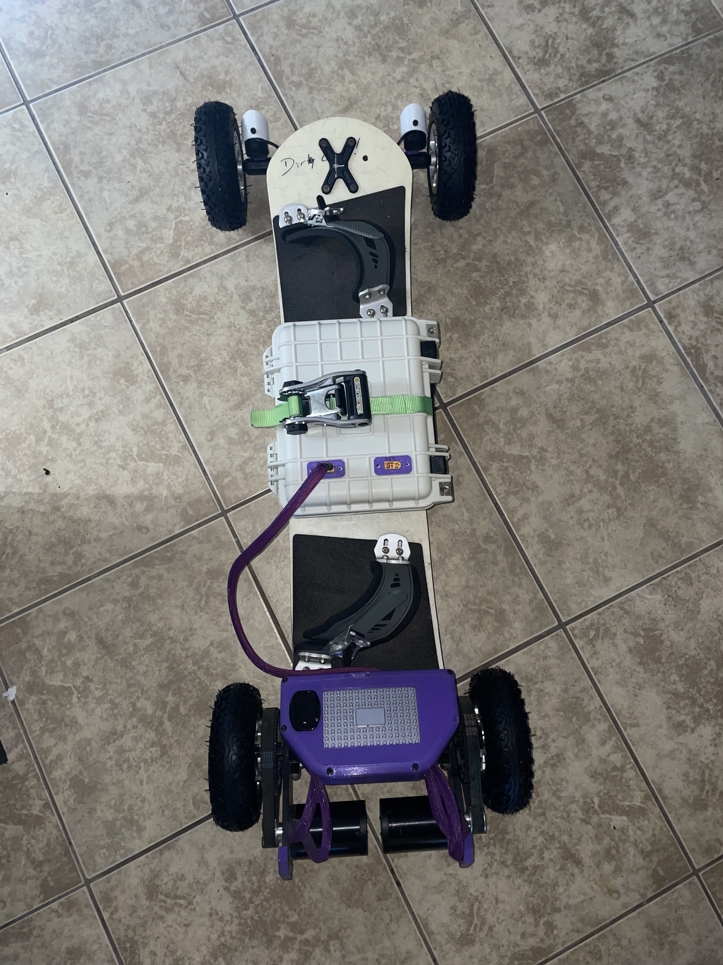

Solo on da way, I am so giddy to ride
In other news I’ve also found the deck ima use for the meepo, they are super local so I can go pick it up in person
Just need to order batteries and bms and figure out what ima do for an enclosure, I might keep the meepo one, but I want to design one to print out and fit 2x 5s Lipos and the bms nicely

I went to leave today and was like “Ih that is right I need to plug in my motor again”
My last ride otw home my motor cable popped out right as I got home. That morning I had shrink wrapped the connectors so that wouldn’t happen but here we are
My best hypothesis is that the plug popped out, and one of the phase wire plugs was just in enough to bridge and cause some damage to the female plug so I was unable to plug it in
I was able to re center the plug but to no avail
So last minute I clipped it off and tried to bridge the phase wires, but I just didn’t have enough time to get everything connected
So just a day away from getting the main board back, I am having problems with my backup
Now I totally blame this on me as I had 2 full days to fix it, but I just looked past it
Tonight I will bridge the wires and hopefully get it all ready for tomorrow
So I can get home and get the solo all up and ready to go

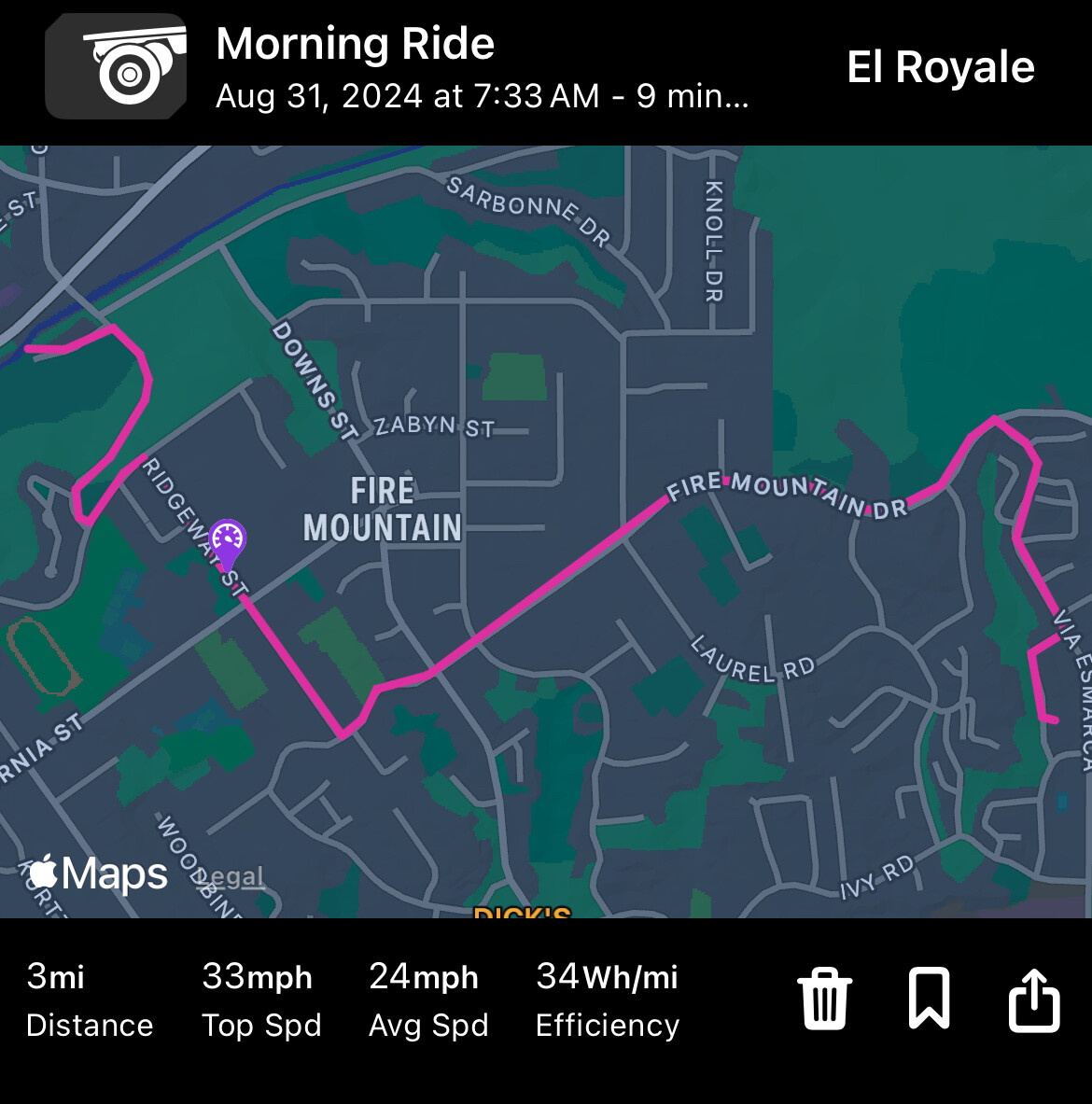

Back on the steed for the morning ride
Glad I have it back, especially now that my gf wants to break up with me
Great fuckin news to get on my biggest work day of the month

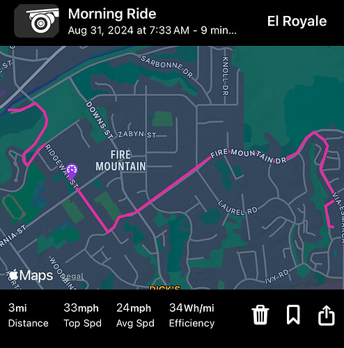

Well it’s been a few days now that if had my steed back and I missed it so much
To follow up my last post board is still riding well, if not better than it was before
I’m running more conservative settings which is leading my riding to become a little bit safer
I think I will eventually turn it back up, but for longevity of the lipos I figured it’s better to keep them low

I hit some off road for the first time today with the new clever tires and I now see why everyone raves about them
They hook great in the dirt and are highly confidence inspiring, along with on the road they feel like street tires, and the line of grip is very easily noticeable where it looses and gains traction
