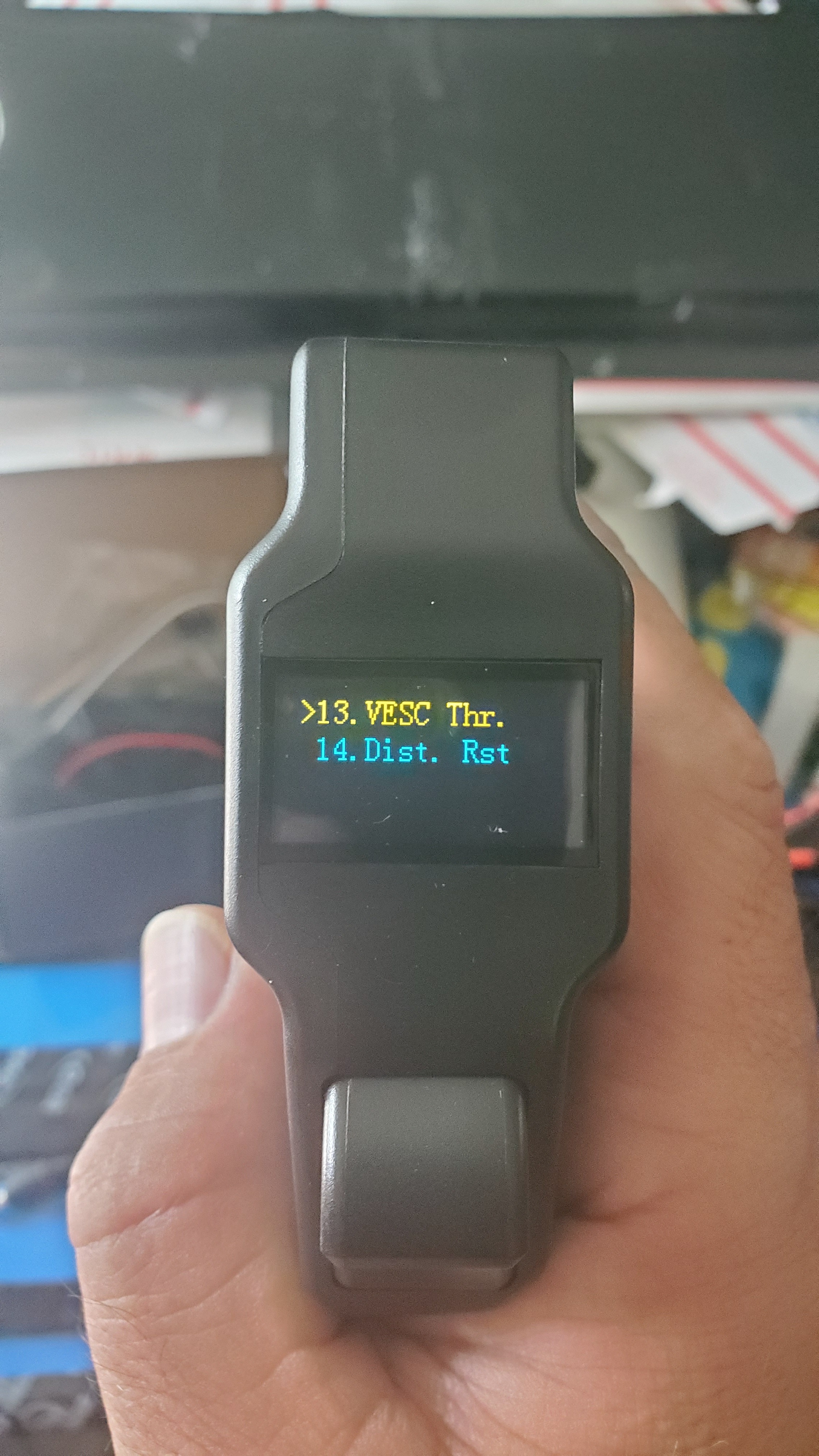

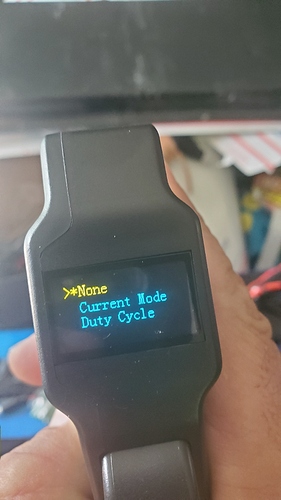

That’s because you’re sending ppm signals and vesc motor commands at the same time

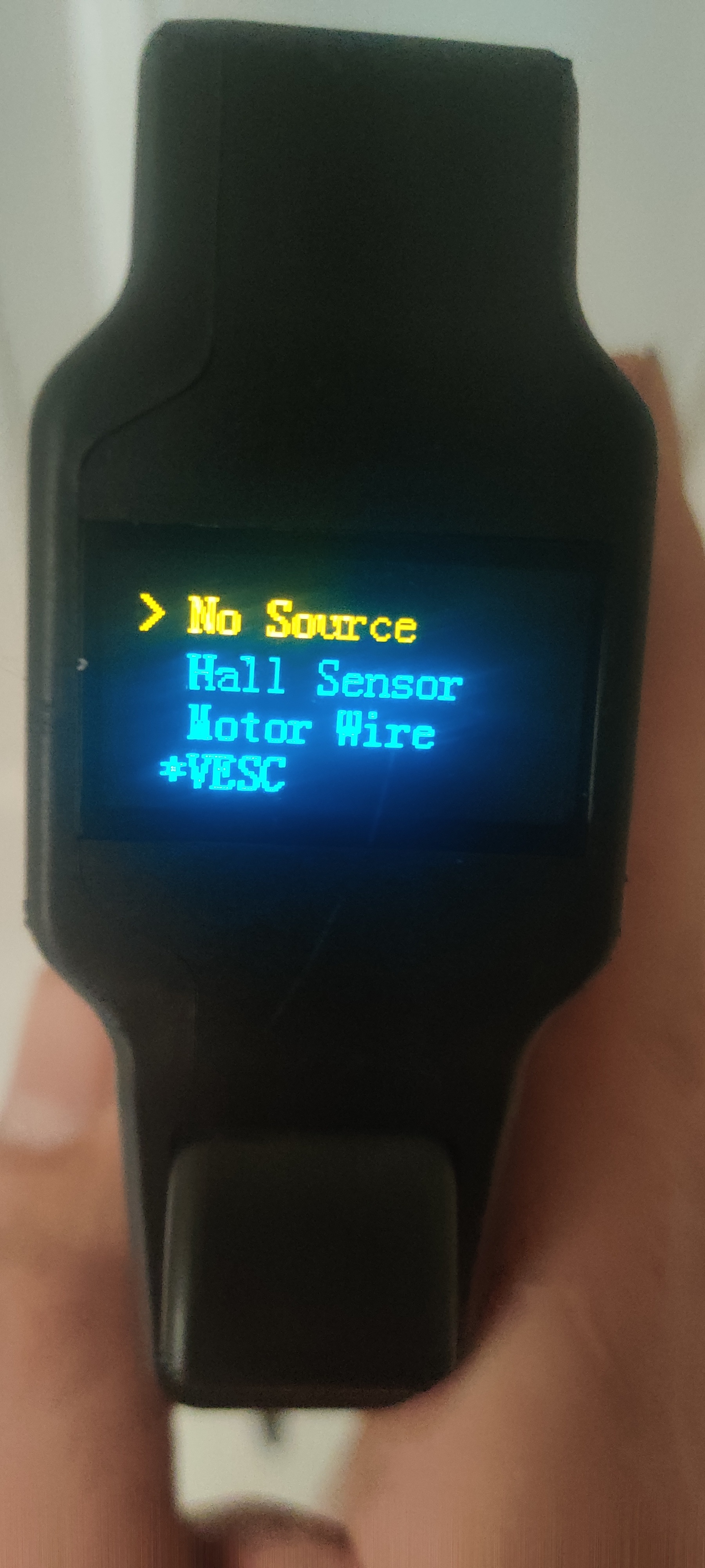

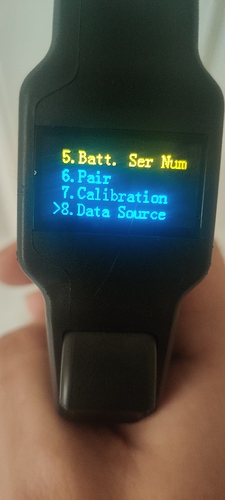

Thank you Kevin! :point_up:This fixed it! I really do appreciate that because I was banging my head wondering what the deal was. Did you try changing this setting? Menu 8 or Data Source.

Yes I did. Doesn’t do a damn thing. I get some data. Just not all.
VESC non ppm works perfectly. Just not hud voltage or speed

Also careful to not set up the menu on the remote to output vesc for throttle if you have the servo signal hooked up. They fight each other
