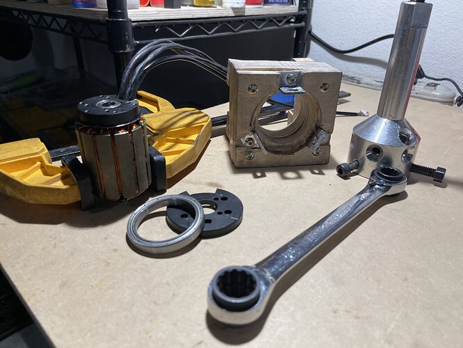

Maytech/lacroix/bioboard 6389/6396 stator support bearing removal
Recently I’ve semi broke several maytech ‘extra tough’ style motors that have a 6809z bearing at the stator/can interface.
(this bearing)
I’m trying to remove adjacent parts to examine the coil termination area directly.
I pissed away a whole afternoon working this out. I made a tool to push the stator away from the bearing.
I didn’t want to mar the black anodized surface that seats the big bearing. Also, windings are precariously close to the inner face of that bearing to try to use a screwdriver, chisel, or something else stupid.
I only hammered on one for 5 mins and stopped.
I used an inverted airblaster to freeze the stator aluminum at first. I didn’t heat the steel bearing. Maybe the temp expansion differential helped, maybe it was the plywood from HomeDepot or the Autozone gear puller. :man_shrugging:
This feels like an extra specific problem related to me, but I did it with semi off the shelf parts and I didn’t do bad things to factory precision surfaces.
Unsure of picture order. Will elaborate if you have the same problem. It did work. Thank you for coming to my TED talk.
It’s also difficult to remove this kind of stator from its bell.
I did this.
The aluminum cylinder with a BLDC looking mount bolt pattern was a trash bin part I used to pull the stator out. I just tried to do it without a disk and failed.
I bought myself a pulling tool for the job. Worked like a charm. The only hack was I had to put a big coin on the black faceplate to protect it and to better distribute the downward pressure.

Opening the motor was quite easy, I just used a bearing puller.
Is there any locktight used to secure the bearing in?
Unlikely.
Nope, just friction.
I left the adapter plate on and carefully widened the slot between the plate and the can with i think some sort of screwdriver.
Then I could get the arms of the bearing puller in, the middle screw thingie screwed down on the axle shaft.
Squeakingly the two parts came apart.
Closing it I just used a clamp, one of these things that can be tightened by hand using like a pistol grip.
