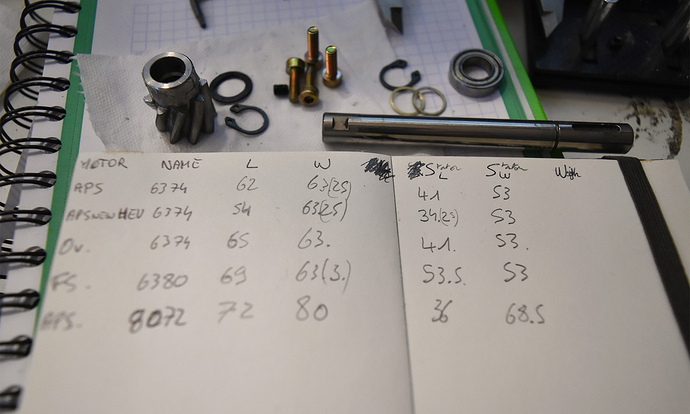

if it can highlight some … :
some old pic and measurements … hope you can understand it
6374 new HEV APS, 6374 old APS, 6374 Overion/Maytech enclosed, 6380 FS, 8072 APS.

So, regardless of the motor lenght, the first four motors (APS, APS New, Overion, Flipsky) all share the same exact stator width (basically the can diameter is pretty much the same standard across different brands). Interesting. :thinking:
ergo: same Chinese factory doing all these motors

All the 63xx motors I have serviced from all brands had 53.00mm stator outside diameter and 53.75mm to 54.00mm rotor inside diameter
