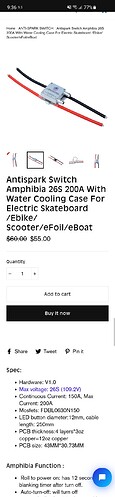

the moment u plug in the the 16s battery into that 13s AS, its gonna pop. y not just sell it off if u r not using it, instead of…basically instant kill it
There’s no other alternative way for me to get roll to start and auto shut off on my board? I’m
It’s weird that they say 60v but 13s when 14s 58.8V. That makes it seem to me like it’s a rough cut-off like their motors so it’s more like what boardnamics said about the FS 13s motors “I think Flipsky just tells people to run less voltage to reduce customer damage rates because 16s”. I also messaged flipsky yesterday on facebook and if I here from them that it’s okay or for sure it will fry immediately then I haven’t opened the packaging yet so I’ll sell it.
For 16s roll to start? Ur best bet is stormcore100D
Motor works differently than AS or ESC, there is no MOSFET for u to pop in the motor, but there are in AS and ESC. That’s why it’s possible to go over the rating on motors but not AS or ESC
Voltage will spike well above 60V in transient conditions.
12s/50.4v is the maximum safe option for components rated for 60V absolute max. This is to account both for manufacturing tolerances and voltage spikes longer than a few microseconds that don’t get filtered by any capacitor and reach the entire circuit.
In short, it will pop even at 13S. Not when you plug it in, but when you slam the brakes because you’re about to crash into a car. Don’t risk it, not worth it.
Stormcore 100D should be the closest thing to a high voltage roll to start option you can get
Also keep in mind motors are just dumb components. In theory, and with enough cooling, you can connect that same motor to 3 phase 480V mains and it will spin. (No, don’t do it. Just no)
The only reason they are rated for only 13s is to limit the rpm within long service life levels. You can absolutely run it at 16, 20, even 22S, but when magnets explode because it’s spinning faster than a jet engine turbine, you should know why

Thank you both for the explanation. I will sell it. I already ordered the ubox and the storm core is far out of my budget. Can I get this? I haven’t seen anyone talk about it. I am confused by it sorry for my incompetence but do I fill this with water? Lol there are these two ports on the right hand side - what are those?
The two tube thingy is for the water cooling loop, mainly for efoil and other water related device (I think I’ve seen someone use it in ebike as well). If u r only pulling little amps, then maybe the thermal mass alone will be able to handle it, but 100% not 200A at 16s without any cooling. It will probably work, but only probably
It’s meant to have a watercooling loop, either closed system or straight from the pond the efoil is swimming in. Not really meant for esk8, but if you don’t intend to draw much current it will be ok. I recommend against it though

So do I attach a loop to it and fill it with water? Though I have to be very careful because if that water spills it will mess up my other components. Actually since this goes in between my battery and esc. My battery will be at the bottom and esc mounted on the back truck so I’ll put this outide and in between the enclosures and it’s waterproof?
sorry i don’t, it was quite some time ago, not even on this forum
yes, but from a pc building standpoint, usually u will also need a pump and reservoir. i don’t know how much would that trasnlate to esk8 use, or if at all. I only know it has to be filled with water, mounting method / other required hardware I have no knowledge of. i don’t think i can help further on this matter

Don’t forget the radiator, since all that heat soaked up by the water has to be dissipated somehow. That would probably be the tricky part on a board, since you need to get airflow to it yet protect it from rocks and stuff.
I talked with flipsky and they said just to attach a pipe in a closed loop between two ends. I cannot add a pump.

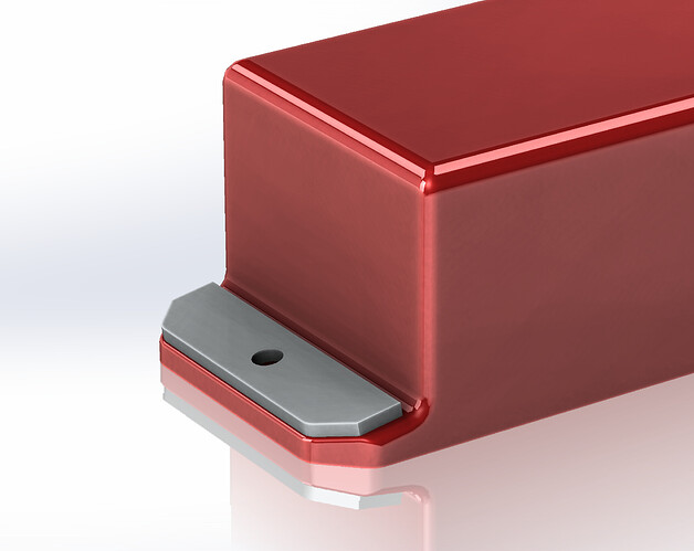

Printing in the orientation you have shown will be very prone to delaminating. My suggestion would be to print the enclosures on their sides, and change the mounting system to a flange with a strip of metal across it. This will spread the force across the print and all the layer lines will be running in their strongest direction. I have been running a 3D printed enclosure with a similar system for years and its still going strong even after many impacts and the whole thing is only held on with 4x M4 screws.
Thats awesome @Tony_Stark. I was thinking that by coating with Polyurethane wood finish that would help. How would I go about getting these metal strips?
