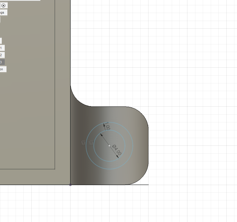

Oh yeah of course I was going to add rolling ball to all the corners of the box, after prototyping. I’ve only ever used rolling ball though so I wouldnt be able to make that mount so I’ll look up the other types of fillets
I mean some sharp corners are okay as long as you know what you’re doing
nah its ugly. I was never planning on the sharp corner for the actual one
No of course. I didn’t mean that as a rule. But in the very harsh environment of esk8, rounded edges are your friend.
Right, I mean again, it depends where it is lol
I like aggressive looks
Wait would you use just a variable rolling ball fillet or make two arcs or curves in sketches on two adjacent faces then loft it together with one of the arcs being a guide rail?

You’re overthinking it.
Step 1: Make a box, with tabs
Step 2: Add a double length radius to your worst stress concentration (inside corner).
10mm long tabs get 20mm radius fillets
Step 3: Radius the rest of the corners
Step 4: Add fastener countersunk hole
You could radius all the sharp corners to reduce stress concentrations further, this is just a start. Also, all these numbers are random. Again, if this is new to you, I highly suggest you spend a month playing with fusion, designing, before you jump into printing enclosures. You will miss lots of things and waste lots of filament.
I echo the other sentiments expressed here - if you’re not already well versed in designing structural components to take serious repeated stresses, an esk8 enclosure holding a bomb going 30 mph is not the place to start. As tempting as 3D printing is… hammer… nail. etc. Fiberglassing is a better skill to pick up for this if you want to DIY.
I was definitely overthinking it. That’s why i wanted you to share the file. Thank you so much.
Another solution is to just print the walls and have a cutout plate on top, shut tight like the trampa box.

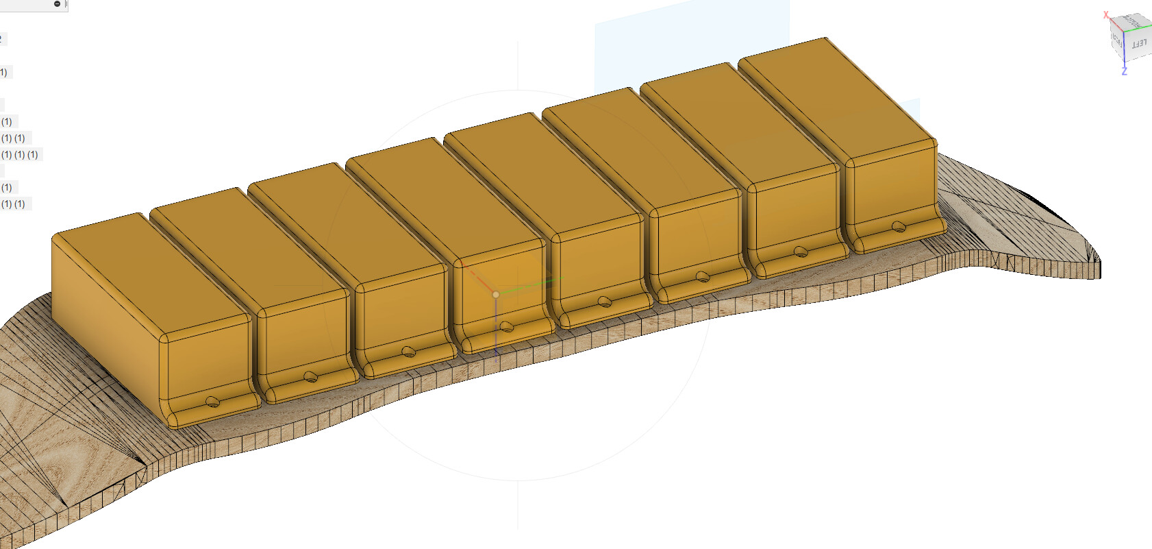

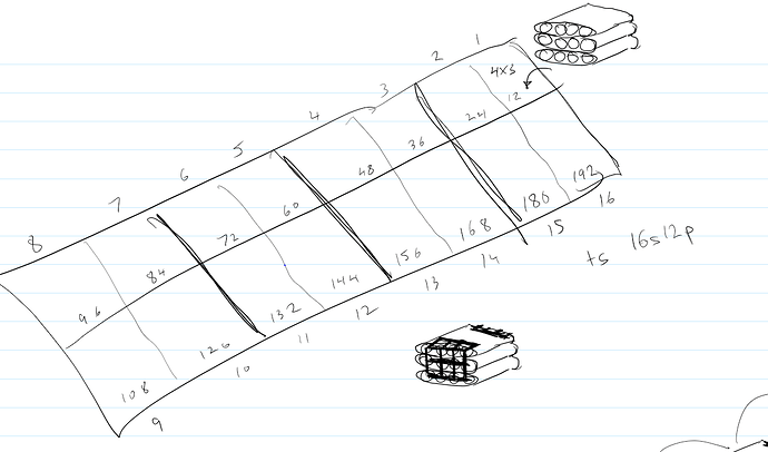

After a lot of thought, I have decided to go with a 16s12p instead of 12s16p. A big reason for switching is so that I can fit a better enclosure under the deck. This one will have 16 m4** (now m5) screws. If it wasnt for all of your feedback on my enclosure and plan, I wouldnt have made the switch. How do you feel about this enclosure? I could make 4 sections instead but I feel like this would be better for flexibility? There will be some form of cutout between them for the balance + main wires
How do you feel about this instead for the mounting part?
Interesting change. Seems like it would be a lot stronger, however if you are going only two screws maybe M5 would be better. I have 10 M4 screws holding up my 12s7p 18650 battery and they still tend to want to work themselves loose even with such a small load.
