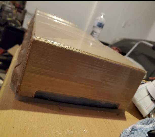

I covered my enclosure in a coat of jbweld steel epoxy to strengthen it :crossed_fingers: After I make sure everything works, I will spray paint and wrap the enclosure in a clear vinyl wrap like my battery enclosure. Then I will replace the DuPont connectors with soldered connections and seal everything with silicone like the opening for the accessory wires at the back and the xt90s. After that, I will take my battery off of the board and print top covers (that I originally had designed) to completely seal off the battery with silicone to make it waterproof to a certain degree. With all the taping/wrapping I did to the p groups themselves, sealing the battery enclosure will really seal the deal :wink: and I shouldn’t have to worry about riding in rain or snow. I sealed my old board and rode in the rain+snow successfully.
My enclosure is spray painted and wrapped. I already tested the fit of most of the components. Need to put everything in and test the software I made. I sealed my battery today.
It was a challenge to apply silicone between the segment gaps.
Should be pretty waterproof now. I 3dprinted covers for the top and sealed them with ge silicone II.
I hope to go for a ride tomorrow :crossed_fingers: more pictures coming :grin:
Also charged the battery for the 2nd time. Group 3 tends to charge to higher V and deplete to lower V but it’s usually within 0.03V of the others. The other 15 s groups are usually within 0.005V.
