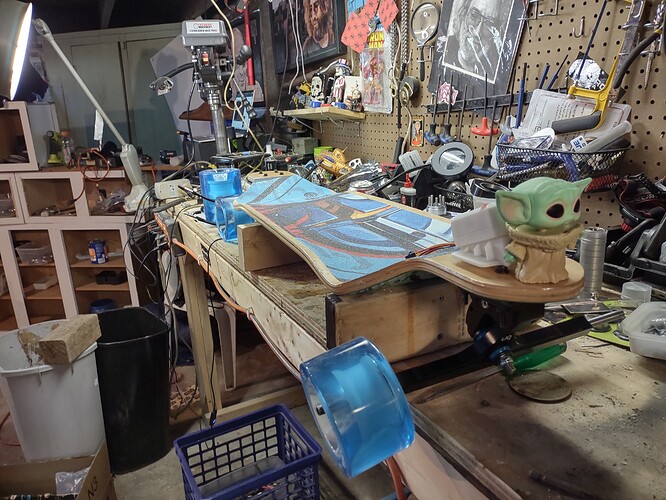

Yup. That’s the deck.
Here’s the groku.
Wow his eyes literally light up! (Saw the first pic) That’s wild! I bet you’ll have the sickest board in town
I dug his head out and his eyes light up. You can see the wires in the one pic

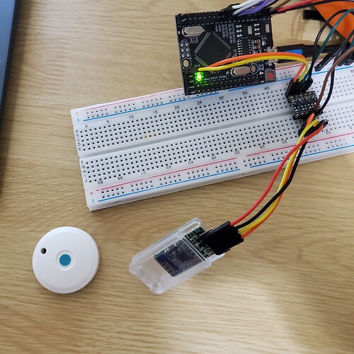

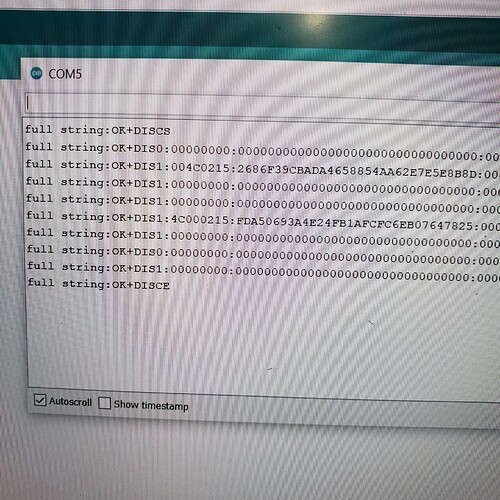

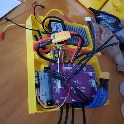

Working on parsing data from my Bluetooth module which is scanning for my ibeacon. Aka setting up security system so that board detects when the remote is in range. I was going to have my board security system work with my phone but I just learned/remembered that my phone doesn’t output BLE advertising. I think having it paired with the boards remote makes sense anyways :man_shrugging:
Figured out how to use a bidirectional level shifter (in between arduino and Bluetooth module) :man_facepalming::joy: I didn’t supply power to both sides, I thought the shifter takes power from one side and converts it to the other voltage like it does with the data lines. Now that I know how to use the converter I’ll be using a second one in between the ubox and my usplit. I had fried my usplit 3 months ago because I gave it 5v. Now it will be protected :slightly_smiling_face:
Once I connect my usplit I can setup the all the sound effects to actually work with the board. If you remember I demonstrated them before, but the tracks were just on loop instead of responding to the ubox.
Wahooo! I finally have the vesc talking to my arduino through the usplit! The vesc data sent to my arduino is in sync with the davega! Yay!

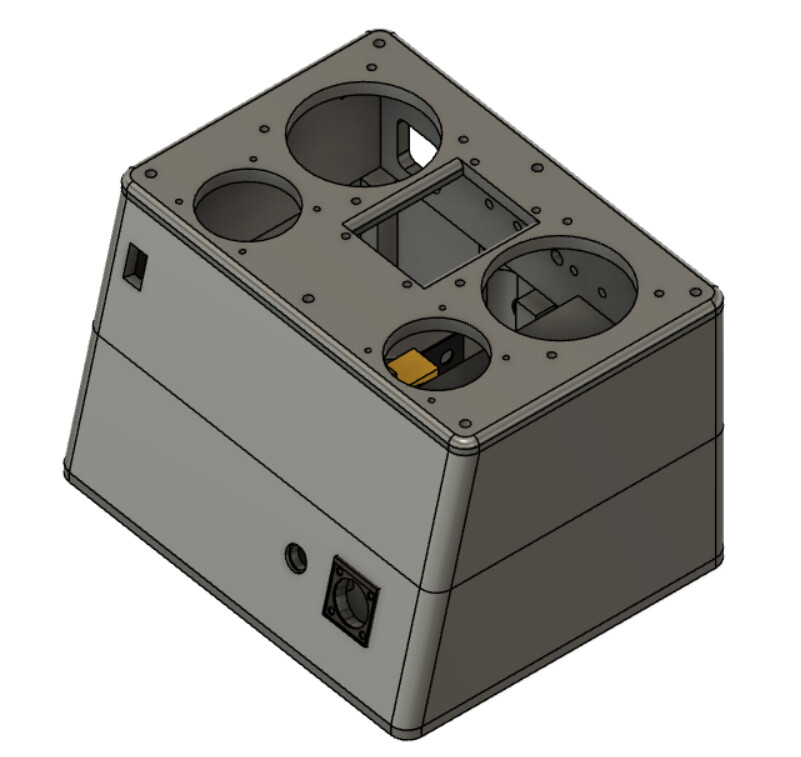

In terms of coding the biggest thing left is making the touch screen talk with my arduino, won’t take that long. The biggest thing left in terms of the whole project is finalizing and printing my enclosure V2.

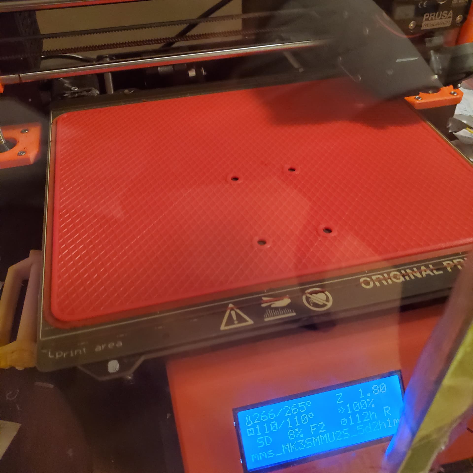

I think I’m close to finalizing my electronics enclosure V2. Might print small sections to test measurements. Definitely going to print a slice of the lid to see how the speakers and touch screen fit. Going to look through all elements of the design of this again because it’s been a while. It will be tedious :weary:

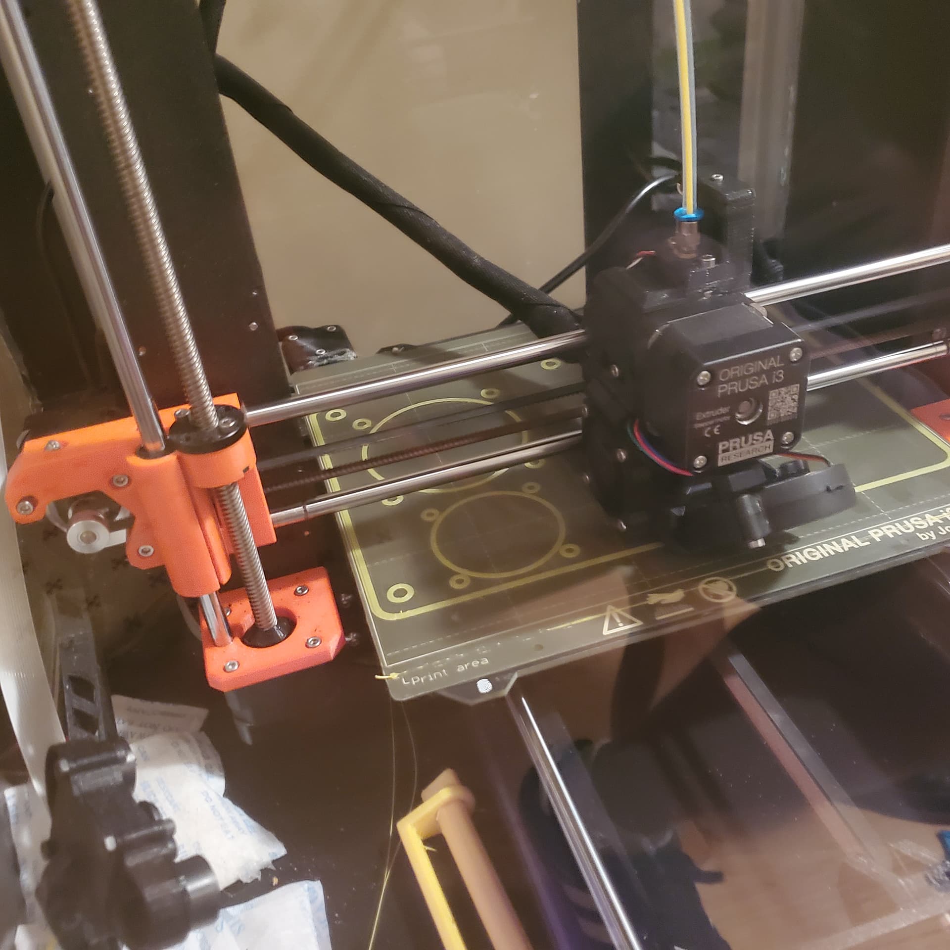

Will be printing really slow (relative to what I usually do). This is how long it will take at 30mm/s: 5.5 days. Will use a full spool.
Printing a slice of the lid rn
I printed a section of my enclosure and found some problems. I think I caught them all now.
Printing the final enclosure v2. This is it. In 5 days I will know i just wasted a week and a spool or not :crossed_fingers::grimacing: will still need to print the taillight mount and tpu remote sleeve after this. Also need to seal off the ends of the battery enclosure. Might just use silicone.

Update on printing: 3days left
