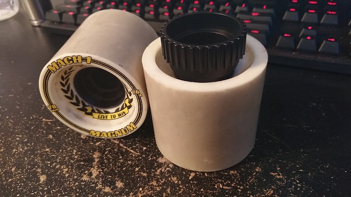

It’s been a while since I skated or updated this build. With the dd’s needing some work that I don’t want to deal with or figure out at this moment, and the desire to go with smaller wheels and a belt drive some things are changing.
Already finding problems with hanger length lol. 200mm SR here. This stance would be way too wide for practicality. I need something shorter; at least in the rear. @moon do these clamps fit the 150’s?
Bruh those wheels side by side are probably wider than the deck lol
