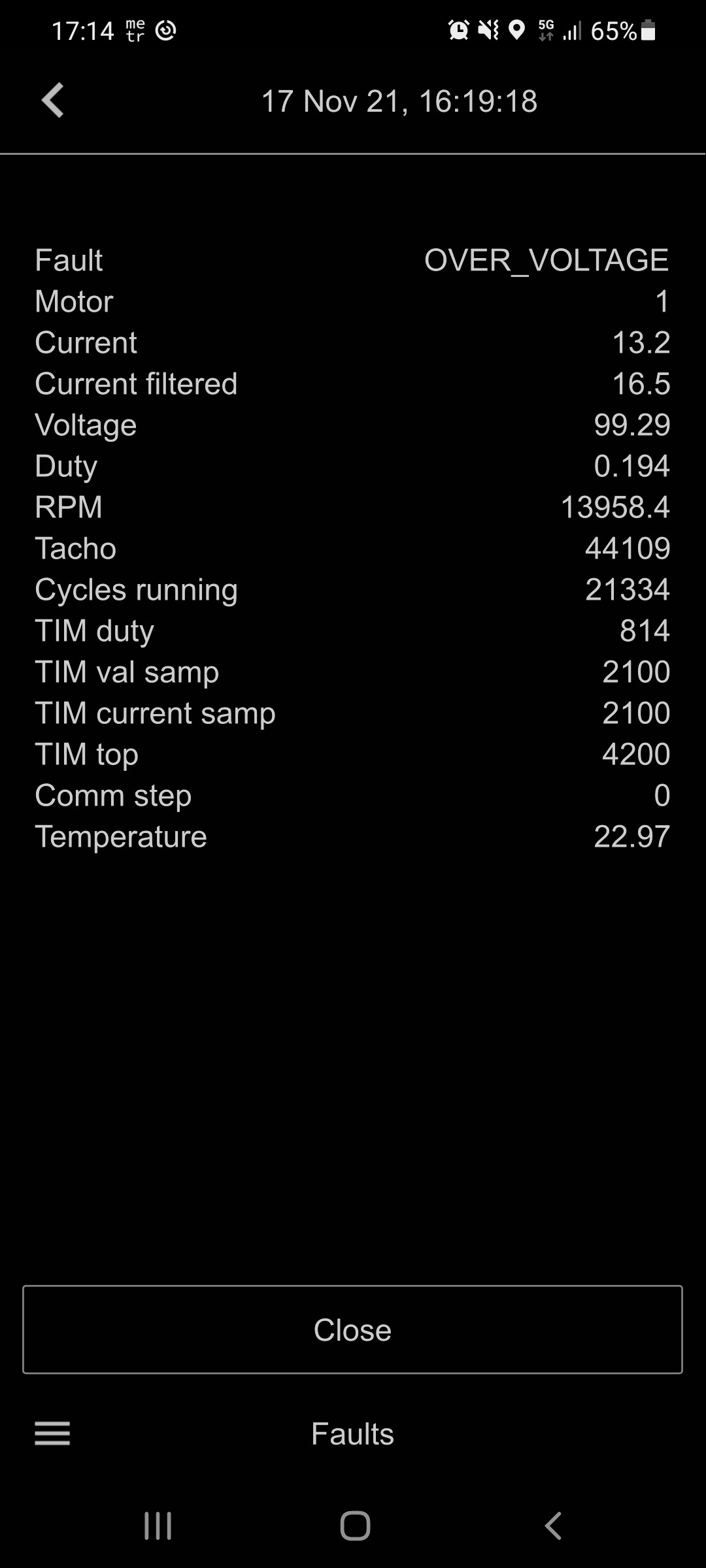

I have some trouble with the 100/250 VESCs. They give me the fault code “over voltage” and behave strange on the throttle. I tried and used VESC tool 2.0 and 3.0 and FW 5.2 and 5.3 and it’s the same thing. @YUTW123 doesn’t have a solution for that problem.
I wonder if they need custom firmware?
But there is no custom FW afaic.
I saw Vedder get this error on one of his YouTube videos and he increased the switching frequency to fix it. Maybe that will work?
Thank you will try it
