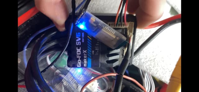

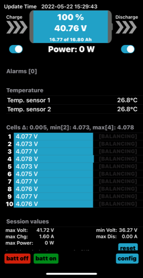

I have a SV6 on a flipsky 6384 which I just put together and ran for my second test ride. I was 3 miles in and lost power completely to my motor (brakes and accel) while coming down a bridge going over highway (minor grade). My motor I had felt a few minutes prior and was warm, not near hot. After motor cut I removed loop key and powered off remote. Checked BMS app and said battery (10s4p) was at 100% but after putting loop key back in, remote (VX1 pro) battery indicator light read battery as dead and trigger was unresponsive.
BMS App:

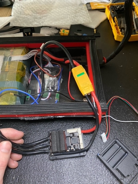

When I got home and opened up enclosure, the board for remote that connects to VESC had blue LED light turned on, BMS light was on, but VESC light is not turning on (see image).
lights
I then proceeded to plug VESC into computer but VESC tool could not connect.

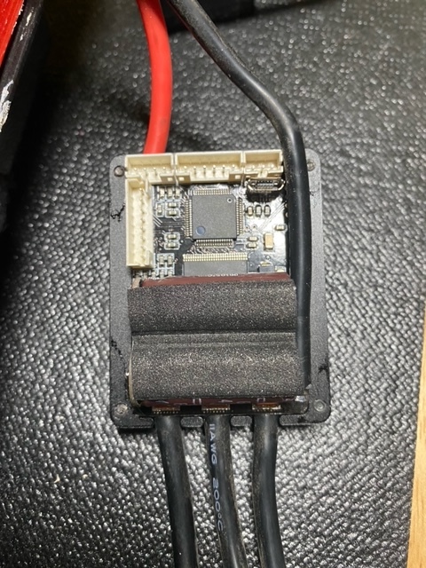

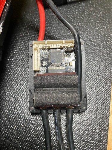

From here, I opened VESC to observe any potential fried stuff. Looked all clean to me (pictured is VESC board while loop key is plugged in but no other connections are attached)
So it appears battery is fine and fully charged but VESC is not receiving power in some way.
Please let me know if you have any ideas how to troubleshoot and if you need any more information.

Yeah real odd, the SV6 has LEDs on right? Like any other vesc does? I wonder if something fried the logic stage, nothing seems to look amiss other then the LEDs not lighting up
Emailed MakerX a version of this post.
If the LEDs aren’t lighting up and you can measure at least 36V from your battery I think you fried the VESC.
Sounds like too high of brake current coming down a hill at full battery.
Wouldn’t there be visual evidence of it frying when opening it up and looking on the board?
Not always, and not in this case in my experience.
And idk if that’s what actually happened, just from your description that’s what it sounds like.
I’ve fried a couple VESCs before this way.
