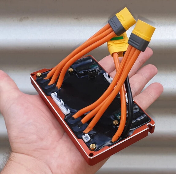

The DV6 can pull 80A battery / side comfortably, the absolute current is a changeable software limit anywhere from 1-130A but is in no way indicative of the performance of said VESC.

is this self tested? with or without exposed heatsink? a physical hardware limit? Or a guess because its based on a VESC 6?
Just by running FOC openloops and determining what triggers ABS overcurrent (regardless of set value) / heat saturation within reasonable time frames.
@mynamesmatt, without an exposed heatsink, just self tested. Hardware limit should be around 150A for both the mosfets and current shunts but you’d be spending more time fighting errors and faults than actually riding.

so with a heatsink you probably could run 80a battery and 80a motor per side hey
