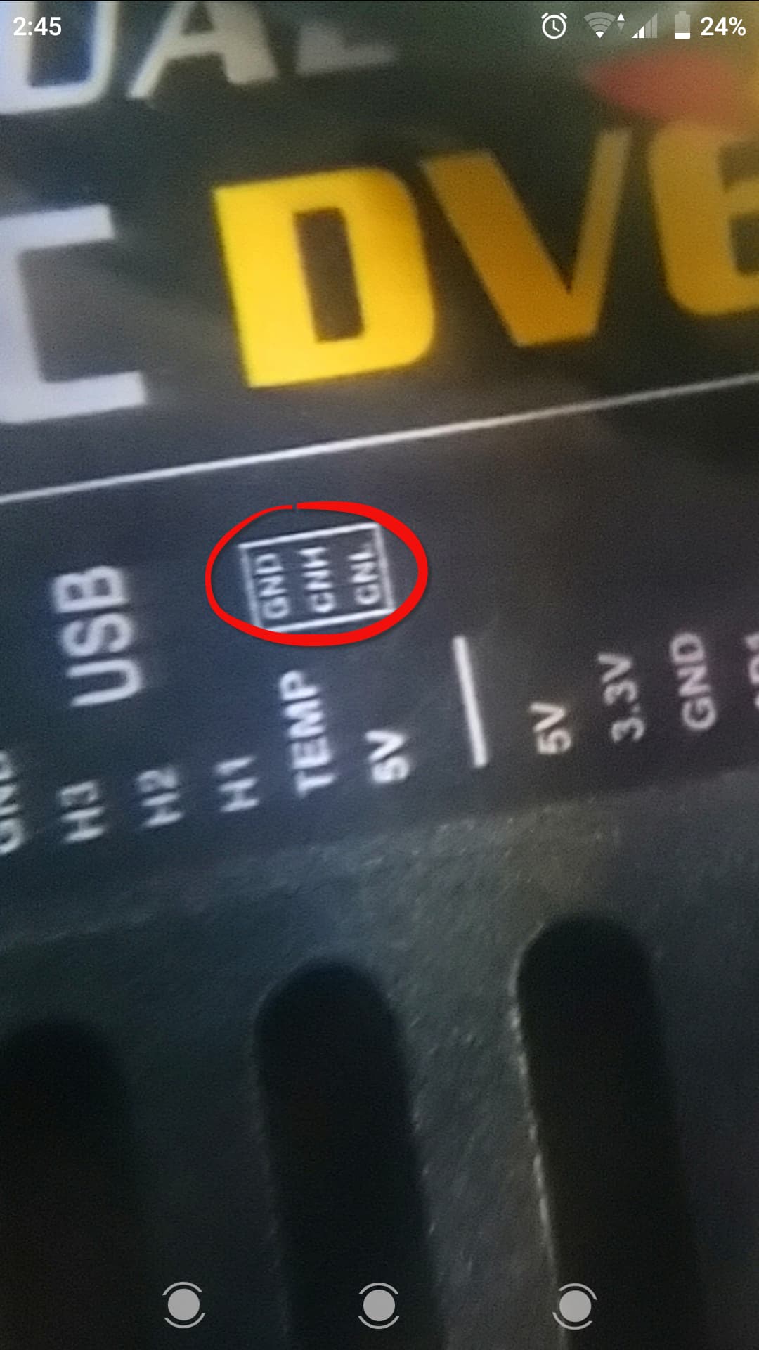

so I’m looking for info on DV6 canH and CanL, I understand I’m supposed to connect these but I cant seem to find much info on what they are, what they do and which ones they are on the canbus port, appreciate any guidance, I have shot maker X an email, but might be handy to have a searchable definitive answer here.
The CAN port of the DV6 is located on the right side of the GH1.25 socket.
found the damned thing, had to use a magnifying glass to read it, explains why I couldnt find it, just looked like a tiny blur to me :upside_down_face:
Yeah - also its worth mentioning that if you need it for a device that needs 5v, you’ll have to pull that from somewhere else (iRemote for example)
