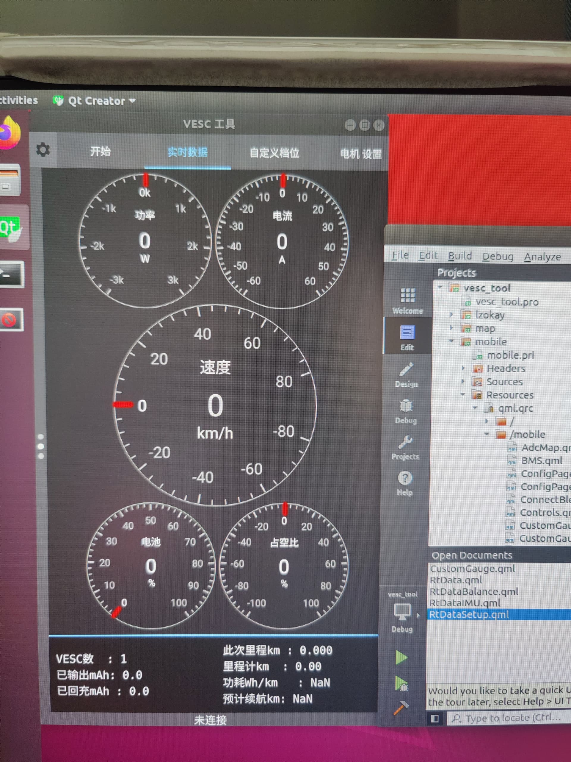

I got QT to spit out a .TS file containing the strings, after translation it’s going to output a .qm file. Not sure how to plug it back in. There are 1300+ strings lol

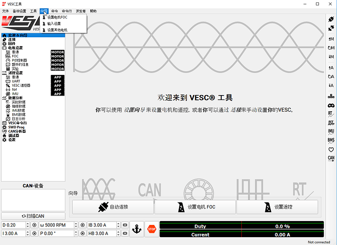

after spending the whole afternoon translating stuff. here’s the file containing translated strings. i have no clue how to compile the vesc tool…project_cn.qm (105.6 KB)
After finishing the translation and exporting a .em file, I’m facing a big problem.
I got a prompt set up that will let you select language on start-up, buttttttttt I’m unfimiliar with C++ let along Qt.
I can just edit the stings and call it a day but that’ll be a hard fork and I don’t want to start over again with every update.
Now the problem I’m facing is that in the tutorials I’m following it has a.InstallTranslator(&t) where t refers to the translated strings. And in vedder’s main function “a” is not declared where as in the tutorial a is referred to as return “a.exe” or something like that.
So, I’m very stuck and I hope someone on the forum that’s familiar with C++ or Qt can give me some help with it.

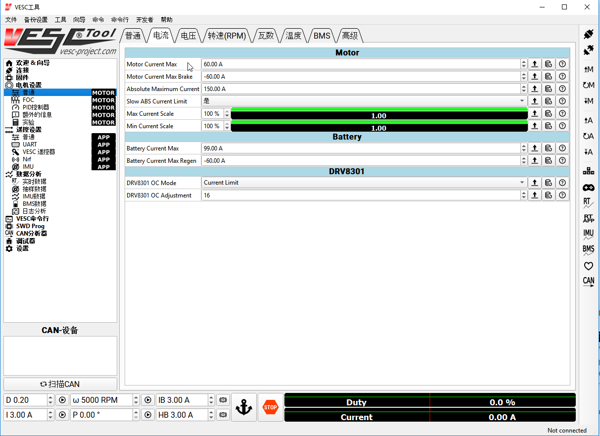

Good news and bad news.
The good news is that Vedder wrapped all of the GUI text in Qt with tr() so it could be translated in the future, and the .qm file you provided did exactly that.
The bad news is that all of the settings are firmware version specific, so they are located in the XML files I posted above. They are separate from Qt. The only way to translate that at the moment is to change the text directly in the XML, and that would prevent you from switching between languages, but we could compile a separate English and Chinese version for example.
I’m thinking if we submit these minor code changes and the .qm translation file, that may motivate Vedder to find a way to incorporate the firmware settings into the translation files.
“a” is used in examples to refer to the application itself. In the VESC tool it’s already initialized as an object as qApp so you can just use that instead.
Place this in main.cpp on line 263ish after the fonts
        QStringList languages;
        languages << "English" << "Chinese";
        QString lang = QInputDialog::getItem(NULL,"Select Language",
                                                  "Language",languages);
        QTranslator translator;
        if(lang=="Chinese"){
            translator.load(":/res/translation/language_cn.qm");
        if (lang!="English") {
            qApp->installTranslator(&translator);
in Qt Creator (with Qt version 5, not 6) a new Qt Resource File with the .qm files linked will need to be created for the code above to work.
  • Resources → right click → Add New → Qt → Qt Resource File → “res_translation.qrc”
  • Place .qm file named as “language_cn.qm” in vesc_tool\res\translation
  • Right click res_translations.qrc → add existing files → locate .qm files
Then just set the compiler for release and then hit the green play button and it will compile & run.
You may have to run windeployqt.exe on the compiled exe from the qt/bin directory if you get .dll errors.
vesc_tool_3.00.exe (30.4 MB)

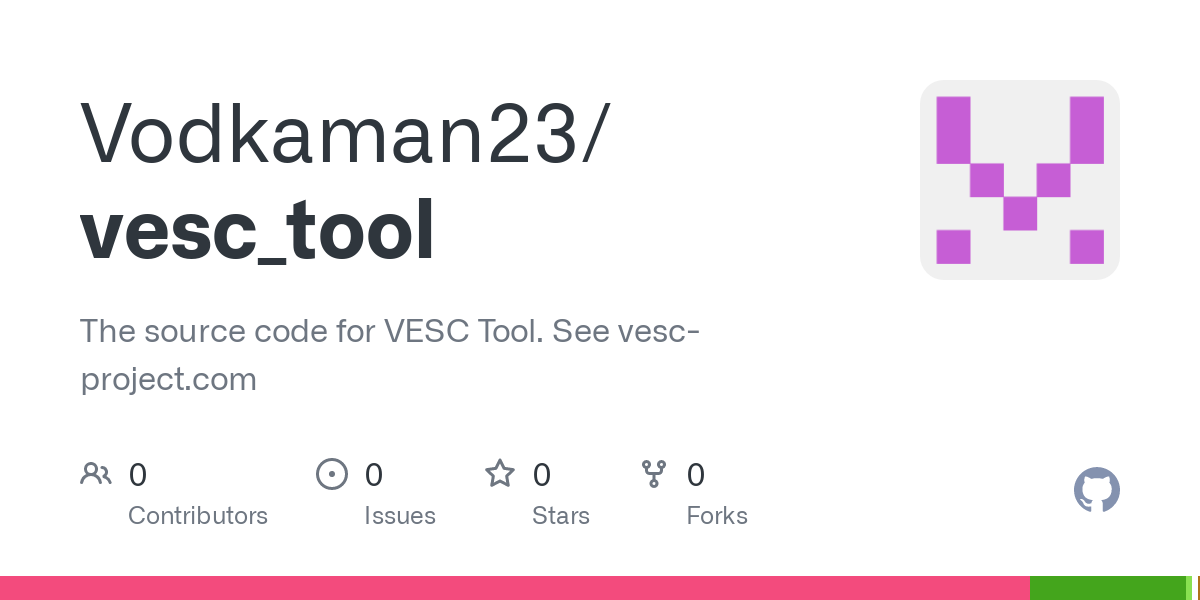

Integrating into the official release is the goal, we will submit it to Benjamin once we got it figured out.
currently it just contains a .qm file and about 10 lines of code in main.cpp
Next step is to figure out translation for xml files and how to properly load each language.
And finally how to incorporate it into the current UI.
Once we got a working prototype of sorts, it’ll be easier for vedder to merge it into his main branch.
