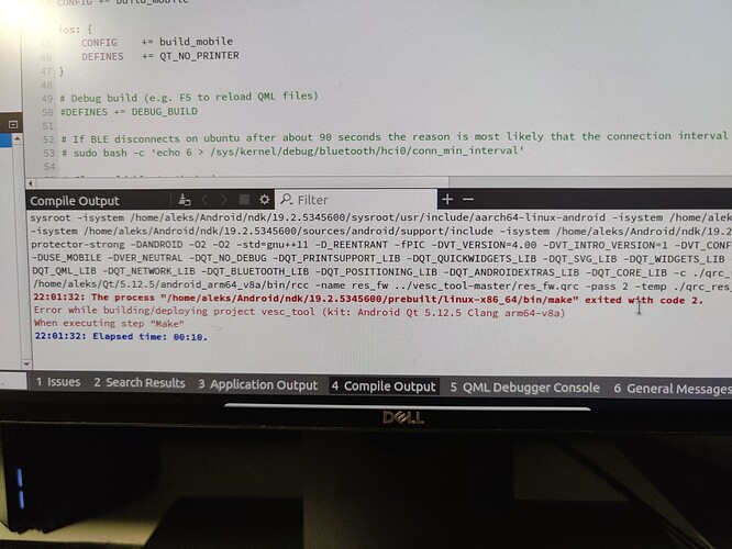

I’m trying to build the new app, but I’m getting this error.
The previous version compiled without any issue so I’ve got no idea what’s going on.
