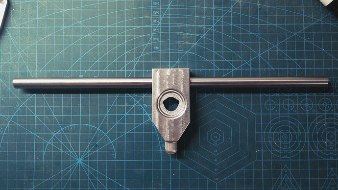

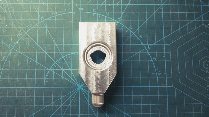

Universal pulley + Kegel adapter

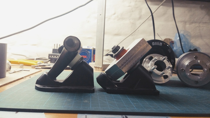

Currently attempting the truck
Long story short…Few months in between and…Final result
image image
It’s finally done! Today full immersion to finish this thing. Happy…Yes. Satisfied…ibwilk tell you when it’s on a board. Are you gonna do it again… Yes but need a break :laughing:
