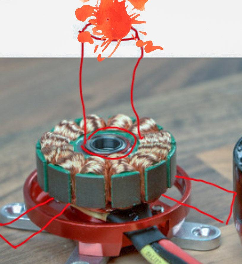

How did you manage to remove the stator from the original motor without damaging it? In my current plan I would get a slim arc saw and cut it in a few places from the inside out until I can break it free
Thanks man! Believe or not I still have to test them. Took my life to make it but didn’t test it yet, only on bench! I feel so fool! Too many things I guess.
Anyway to remove the stators from all the motors I have done it is a metter of hammer and a pipe of similar diameter of the internal pipe. Most of the time the stator pipe has a keyway and some use retainer as well. In that case you need to heat it up and hammer it step by step from the opposite side. I still have all the stator pipes, never broke or cut one to remove it. If they could assemble it, you can definitely going backwards.
That’s too bad, but I understand, more projects than time as always :grin:

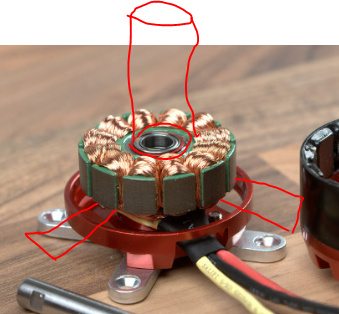

Thanks, I will definitely try the non destructive method first, what I didn’t get on how you do is how do you support the stator without damaging the windings?
Pardon the poor drawing, but in my head I would have to put something between the stator and the face of the motor and them use the hammer on the tube
ahahaha Amazing drawing :sweat_smile:
Anyhow the stator has a decent weight, so it will acts as static mass. You first remove the front bearing. the nyou will see the staotr pipe and you can printo r better find a alu or copper pipe with similar diameter. Then if it is glued, heat gun pointing the base (most of the time is where the glue is) and when it is hot then gloves, thick tissue to do not burn your hands and start hammer from the front. You should see the back rear pipe coming out.
That makes sense, I will try it, I thought it would be glued really tight after seeing some videos of people trying to remove it
Thanks for the tips
You have to give it a good 2 minutes hot gun job to start. Better heat it up slowly and even distributed.
I will see if I can borrow one, and no damage to the windings or the green insulation by heating up a lot?
never saw any sign of damages. is not that you have to melt it to liquid form. It will get hot but not too much in my experience. Target the bottom. Anyhow are you sure that they used glue? I had motor without as well.
