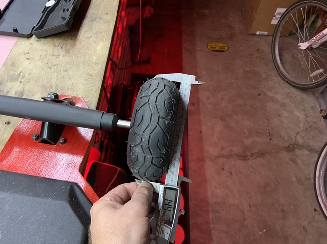

Are these wheels that y’all are making 145mm’s? I know someone said like
6”x2”
I’m using bergmeister tires which are 145mm (according to the tire)
lil bit smaller ofc since they are stretched
this is with 60 pounds in the tubes so i can feel like urethane but grip like rubber.
And those are on the wheels y’all made? So it’s not like a specific sized wheel that has to go onto these hubs?
