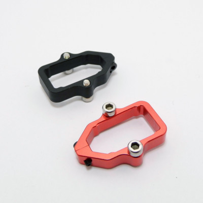

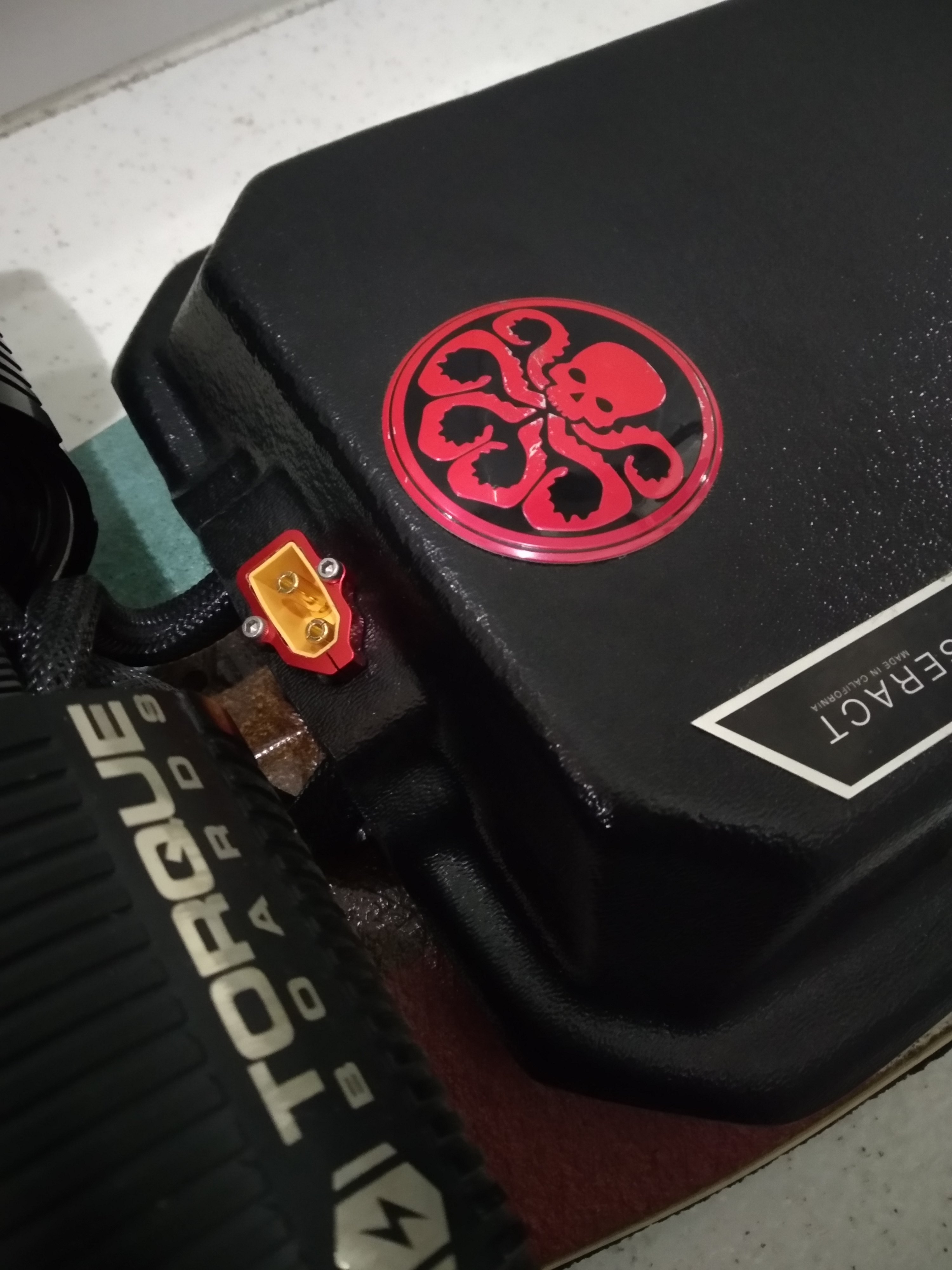

I use Overion Power Switch antispark key kit.
He is the only one I know from a shop that provides XT90S system for years, with a great PCB for setup etc…
(now he use black XT90 key, not yellow one)
https://www.overion.fr/produit/powerswitch-overion/

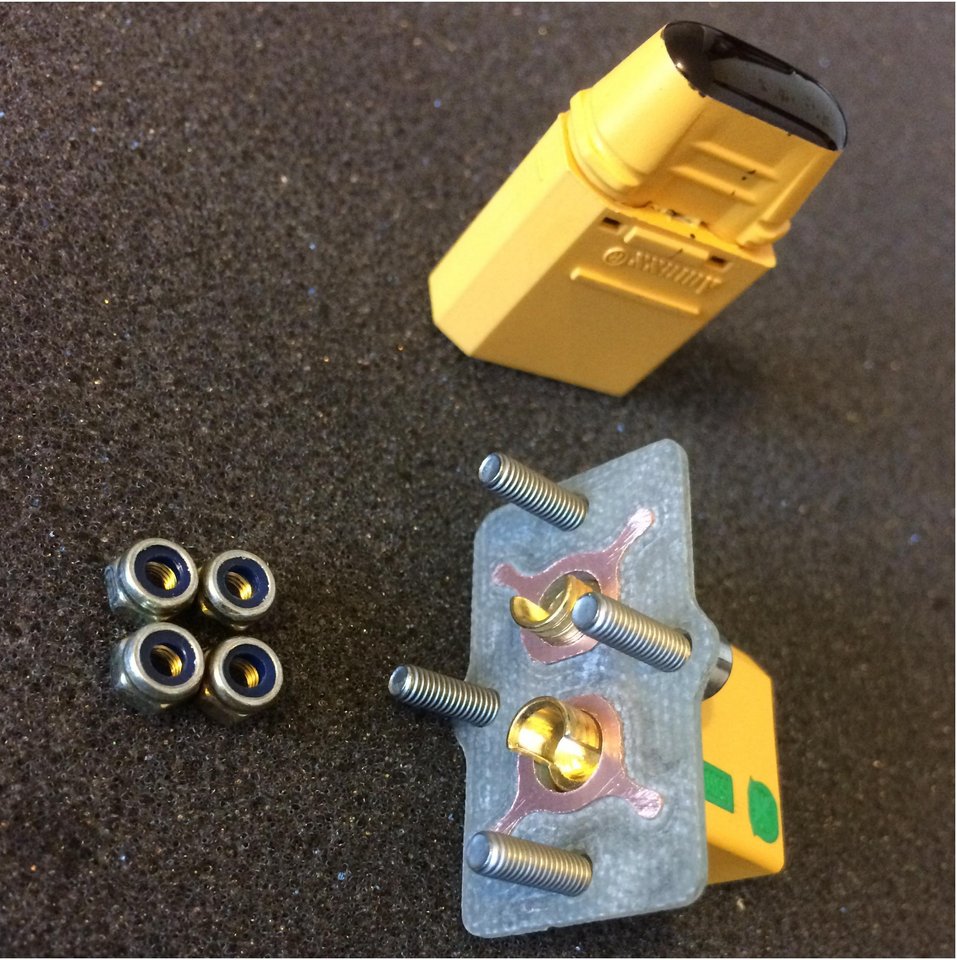

It be because you can twist the male pins so the cups face each other. Can’t do that if you use the Female with the resistors as the key. The resistor stops you twisting it around.
Planing on trying to dermal/ drill out the back of the solder cup see is I can place a bit of solid 3mm copper bar there.
Don’t know if it will work as copper bar will wick the heat away pretty quick so might just end up with a molten mess by the time it’s soldered in.
:open_mouth: i did that on mine :open_mouth:
Ok, maybe only the one without resistor :thinking: don’t remember, but as min one pin I turned around in the female plug for sure
If you have a male and female plugged together while you solder them, then the pins will stay straight and true even if the connector housing melts a bit.

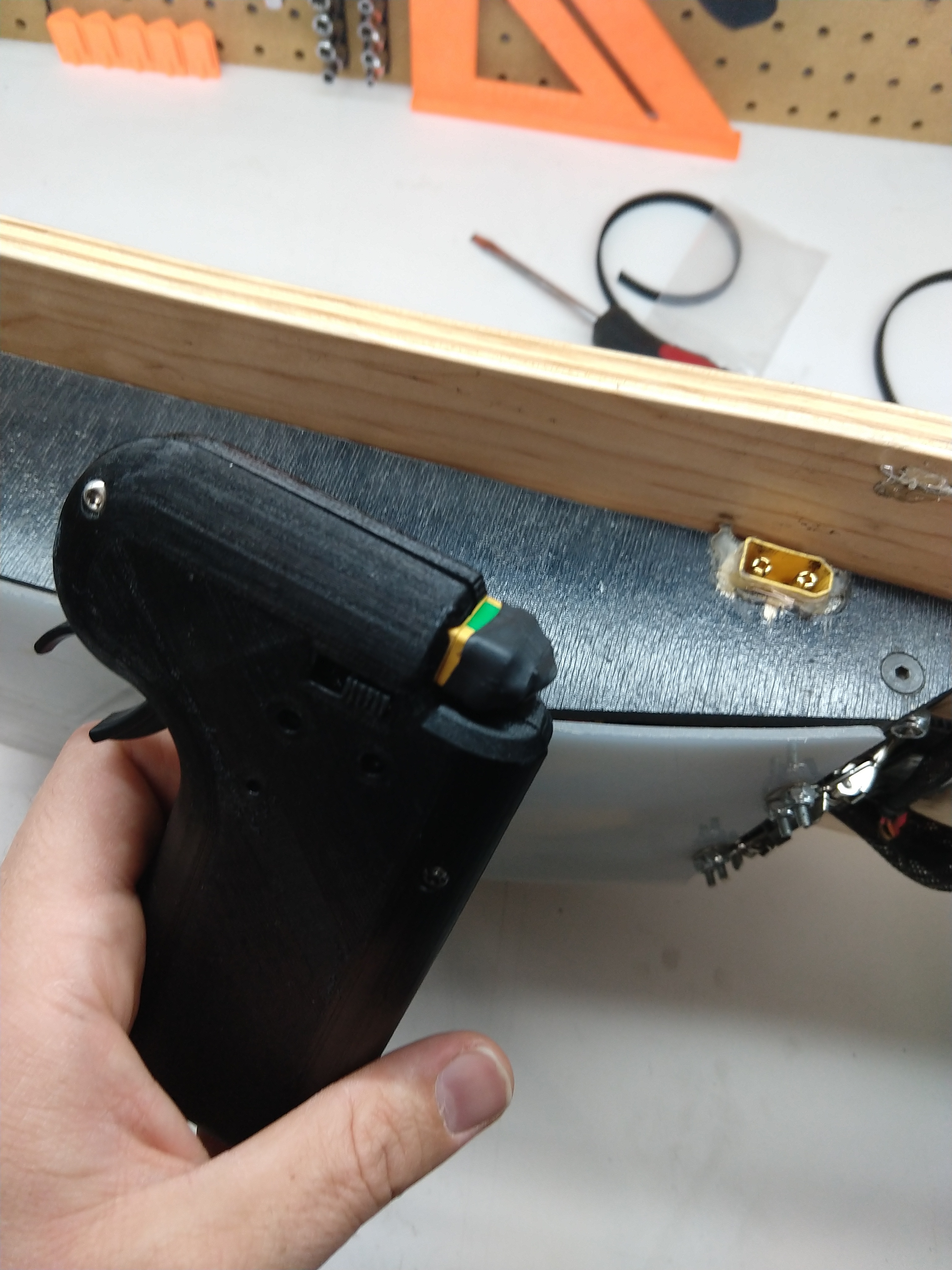

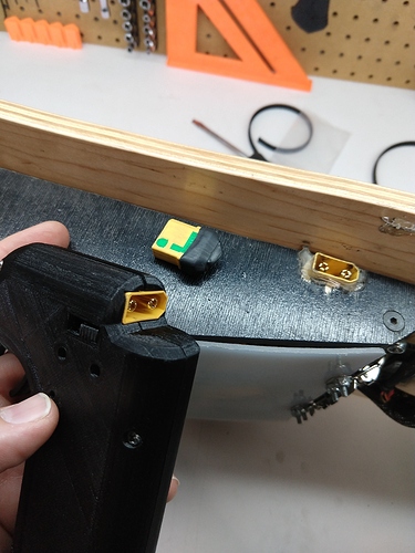

Made this about a year ago for loop key storage and its been super nice. It’s a mod of the badwolf gt2b mod.
awesome!
