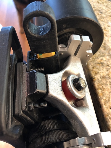

@evoheyax has the best system I have seen so far. Hides in the truck baseplate and levers out. He will have to spill the beans on how or risk the wrath of Skatan.
Edit; Probs only good for drop through but still very nice.
c9ed3c7112d1feac73a09aa03accdb79ddefbc9d_2_375x500 83ccd7f97795ac3e87b060598ad8ac407e6d0a88_2_375x500

@evoheyax has a nice one
