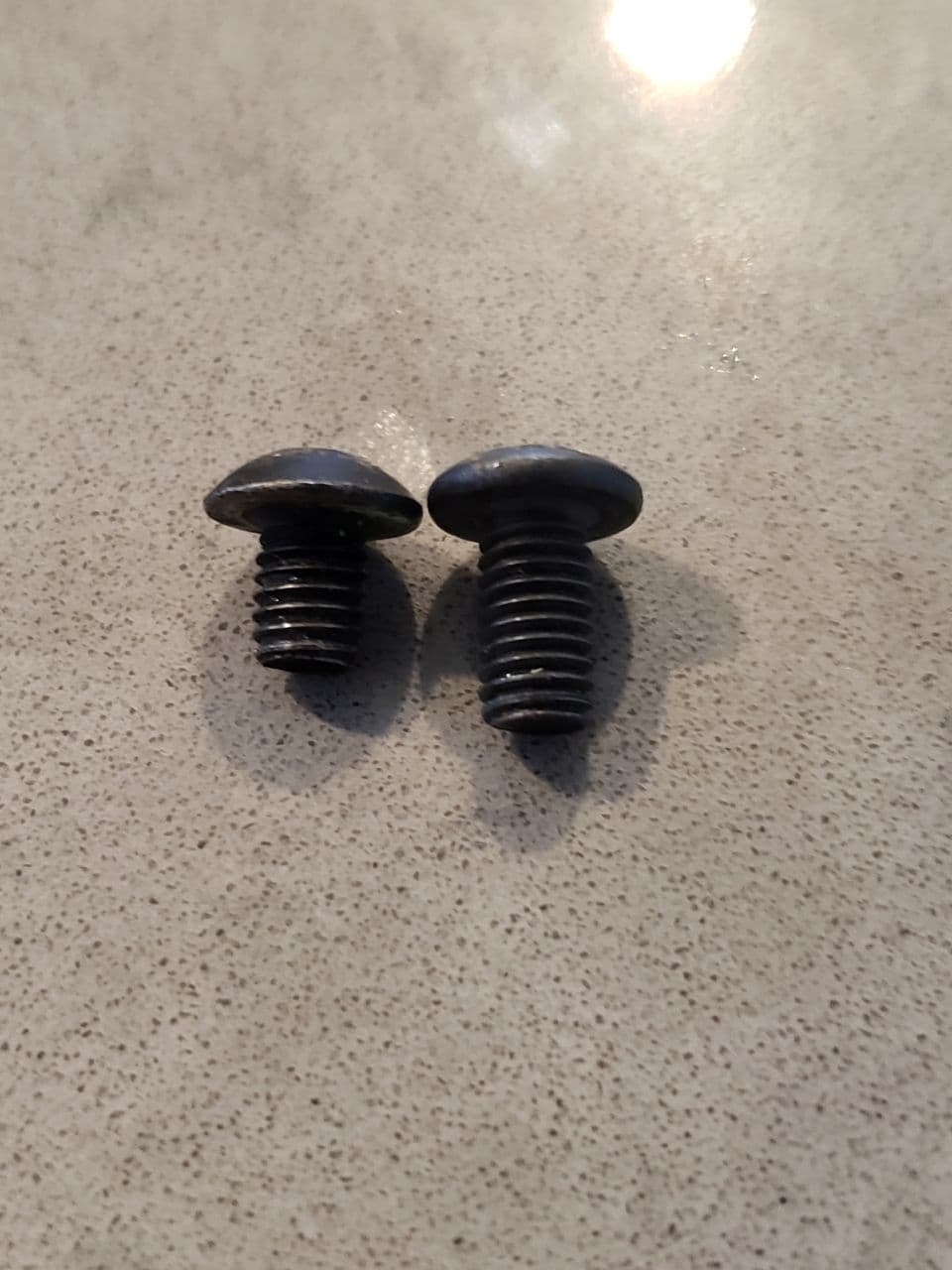

Anyone happen to know the screw specs on the motor liner cover? I think its m5x6 but the m5 bolts i got don’t thread. Maybe fine pitch or imperial?
I think imperial actually. The outer green metal ring is defo imperial. Don’t know the rest for sure.
Thanks. Confirmed it’s 10/32 - the length was ambiguous.
The smallest I could find compared to the actual size. Hoping that the extra length won’t affect anything (Never pulled off the motor liner or cover, so idk what’s down there) but I have some lock and flat washers to take up the extra space if it fouls.
McMaster has almost every Imperial bolt you can imagine. Metric, not so much.

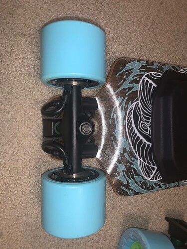

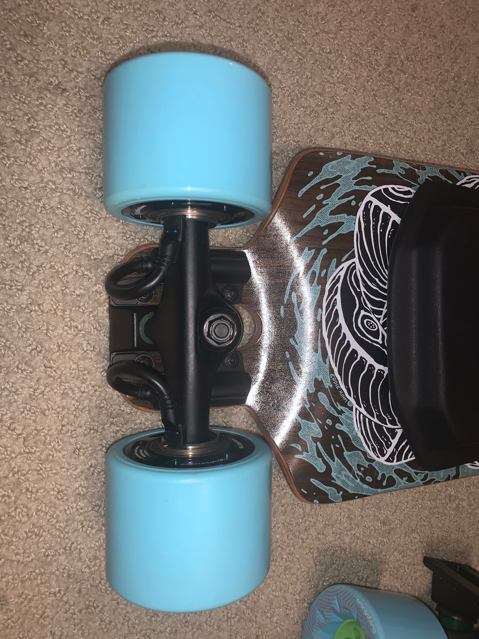

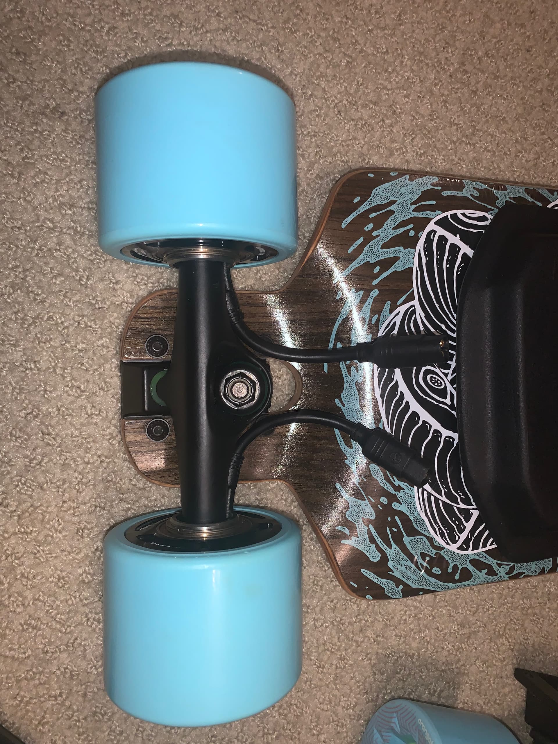

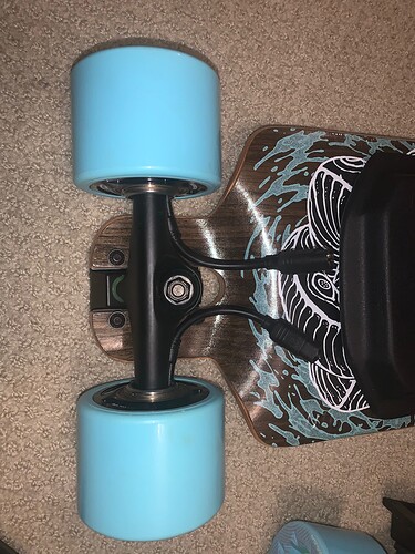

Preference of wire route 1 (out then in w/ connector clamp) or 2 (‘straight’ forward)?
  • 1
  • 2
0 voters
The default connector clamp sucks
I’m kinda torn, on the one hand the first is how Loaded intended it to be, it’s a lot neater, and this gives a lot of slack for the motor wires to move in turns; but on the other hand that was supposed to be for RKP trucks not narrow TKP so it’s a lot more stress on the wires than their should be, the plastic connector feels like junk and since it’s the old school pattern I only get 1 proper hole to hold it, and it makes it more obvious it’s electric which I wanna avoid
