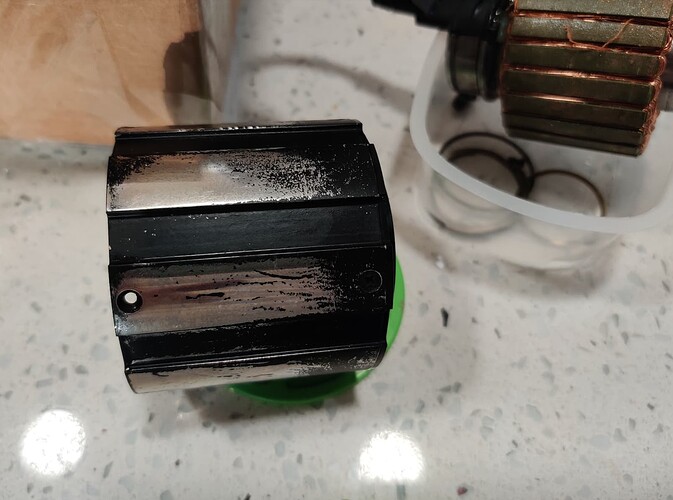

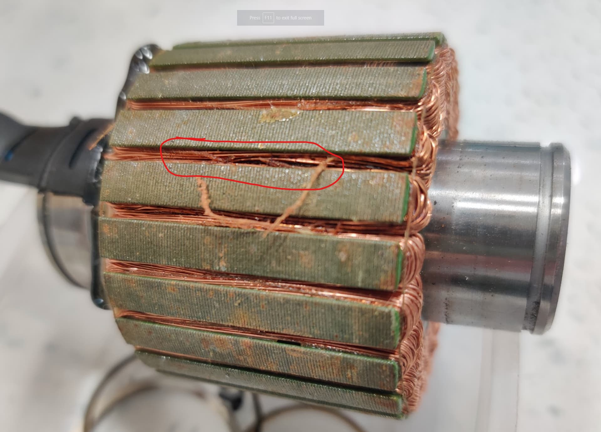

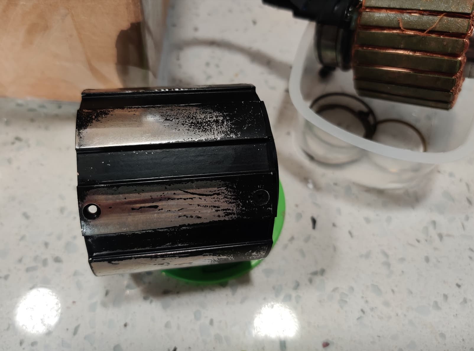

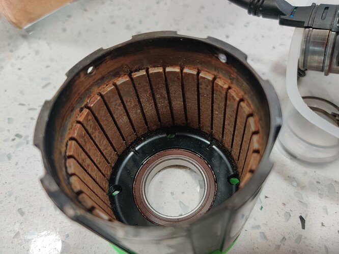

At this point I figured I’ll try to fix the motor they sent myself. I was initially thinking, maybe hoping, it was a short where the three phase wires culminated into one- somewhere on the stator.
Though after opening I found there were much worse problems. And the short was clearly visible in the stator instead.
this amount of wear should have been a red flag immediately, the other “demo” motor does not look like this
Bummer outcome, but guess you can’t win them all. Sad the condition of two “demo” motors I received was so different.
