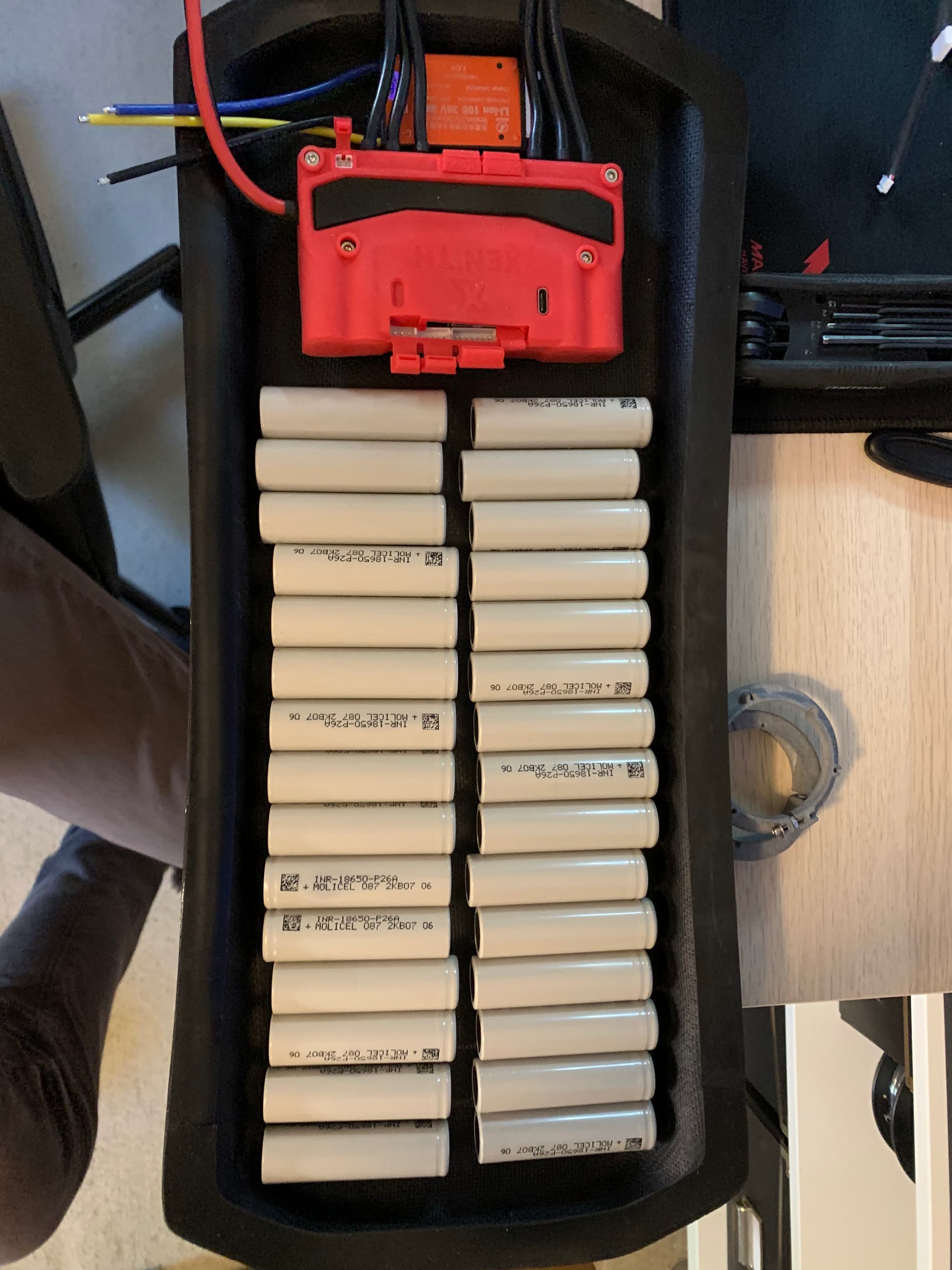

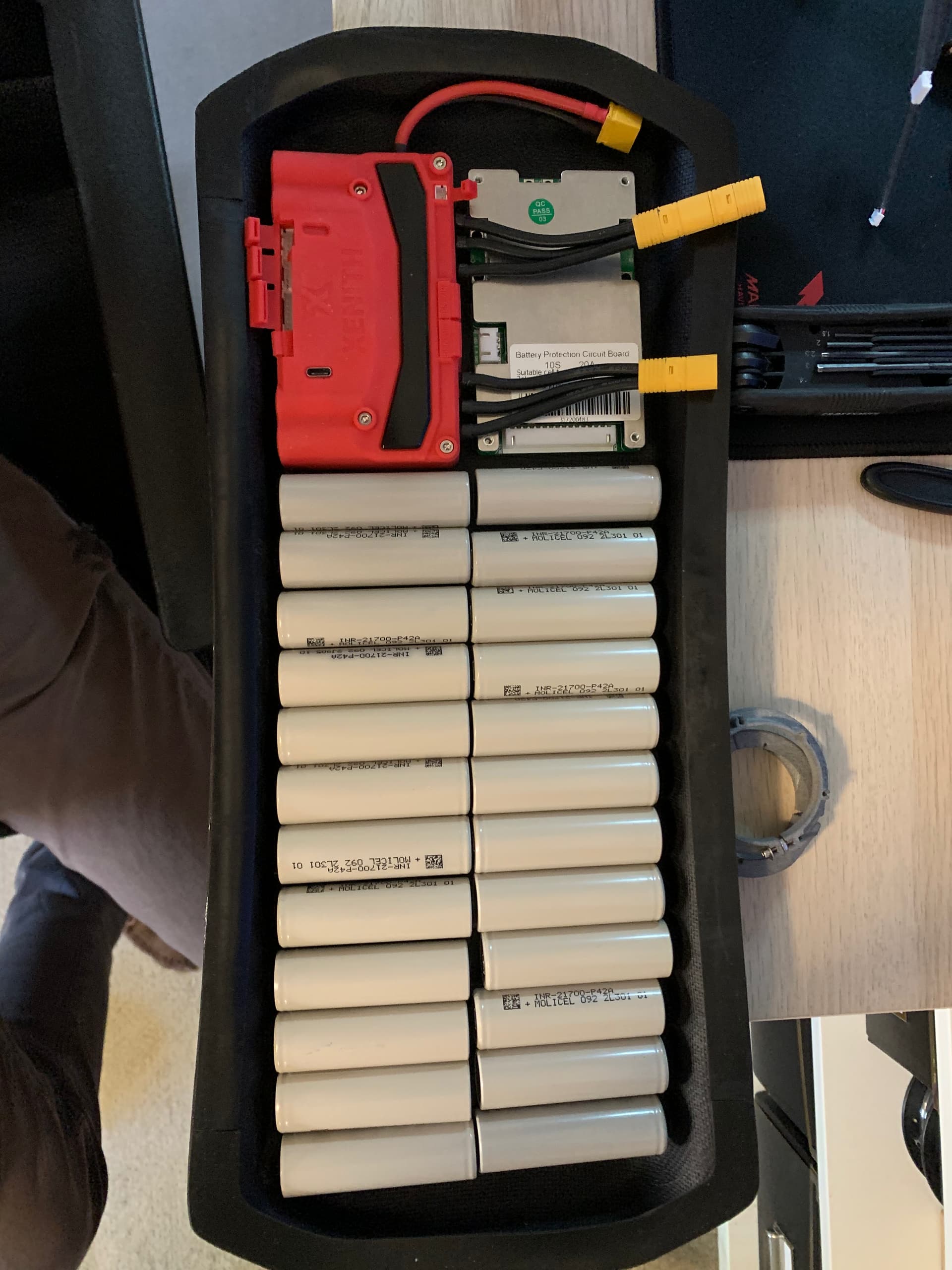

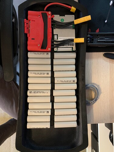

What are y’all’s thoughts?
  • 10s2p P26A w/ LTT
  • 12s2p P26A w/ LTT
  • 10s3p P26A w/ Daly
  • 10s2p P42A w/ LTT
  • 12s2p P42A w/ LTT
0 voters

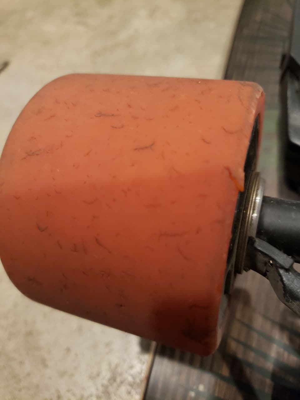

After days of haggling, I caved. Fought hard for the battle of $450, lost. $500 all in total. Took it for a short 5-mile run, felt good, and everything felt settled. Weird plastic on the motor connector but I am not putzing with this board. I’ve been dreaming about a quality street set up and this thread pushed me over. Of course the day I buy the motor liners are out of stock… Will just have to wait and press f5 or cave again for the wheel upgrade pack.
edit the rip in the motor liner had a piece of glass in it. superglue it back?
Fill all the cuts with CA glue, I’d recommend cleaning them first though (wash by hand then top rack of the dish washer, give it a while to dry)

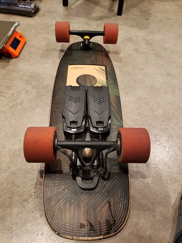

Just switched to these hubs from belts/6354s on my shortboard. The freerchobby motors were rattling too much and I didn’t feel like dissembling the whole drivetrain to shim the axles.
That may have been a mistake :grimacing: . Got hard brakes 3mins in on the first ride. Left side motor internal short seems likely. Lots of resistance still without it connected, unlike the other side.
…I super high hopes for these, they look so pretty on a narrow polished set of Paris trucks. But alas, I’ll see what Unlimited says. Hope I can swap it before they are gone forever.
