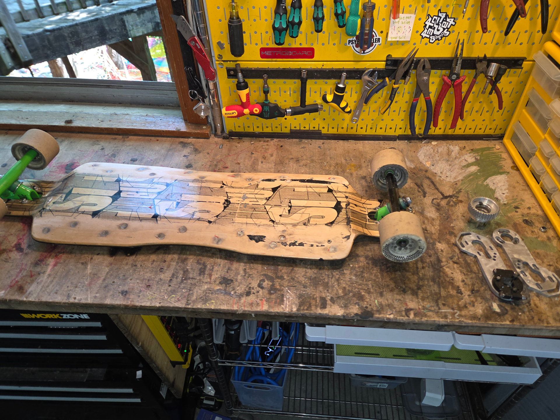

I needed a distraction from all my other distractions…

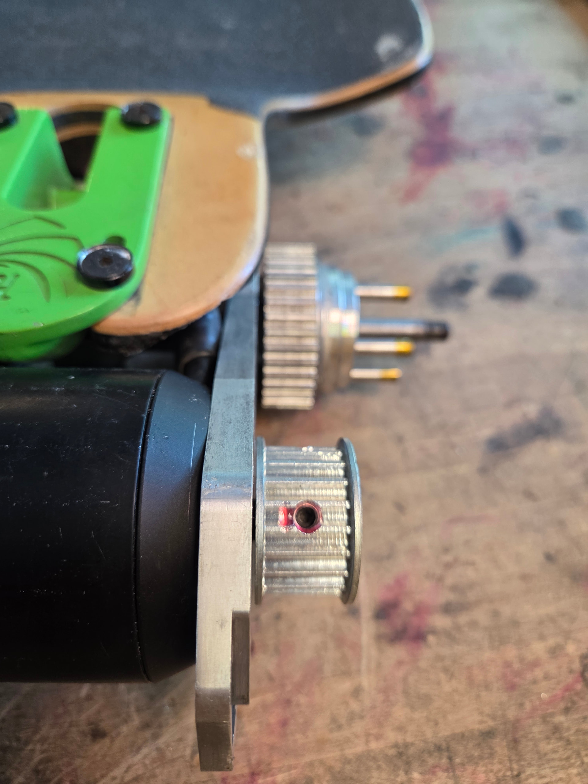

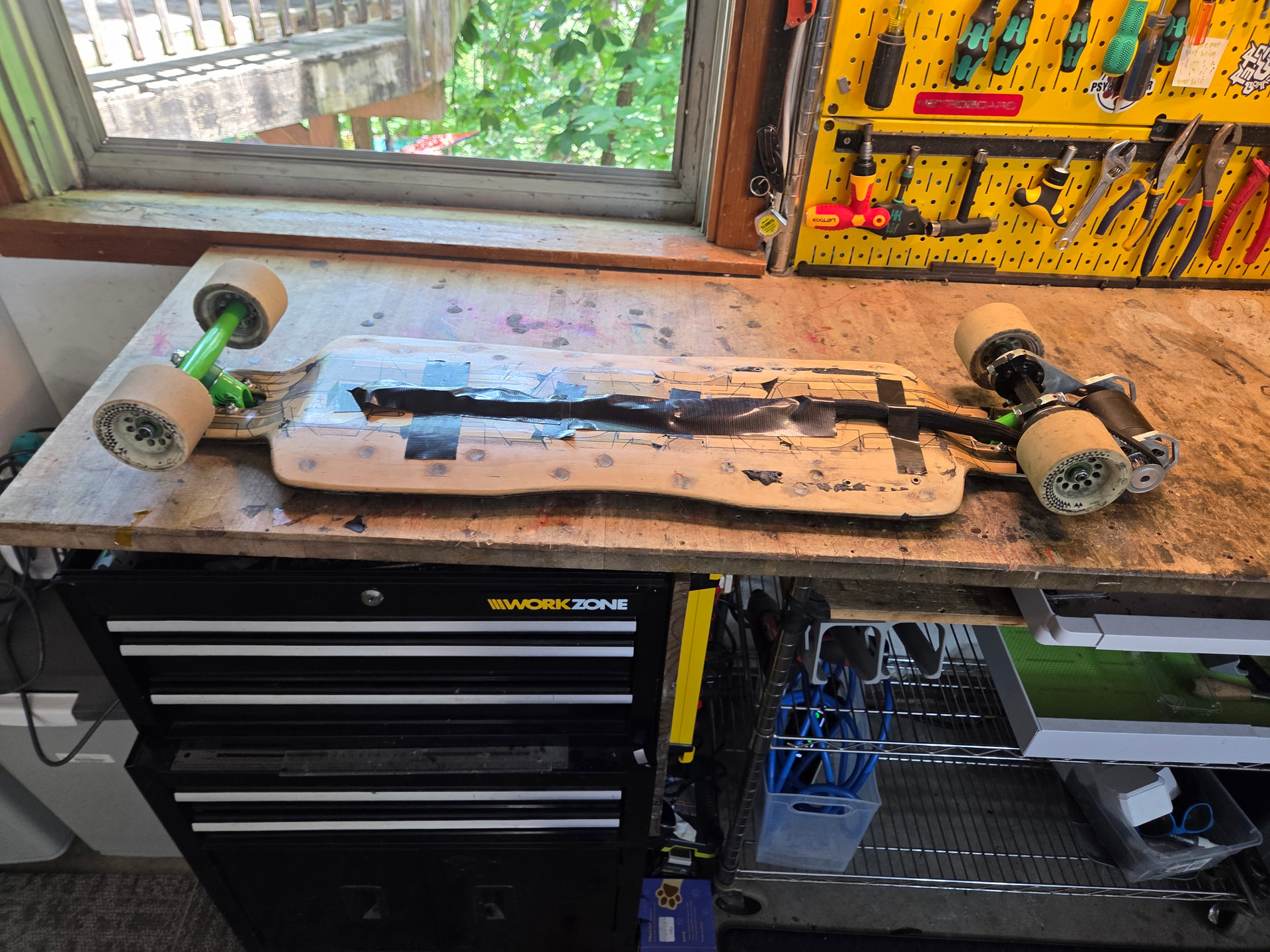

So the Sportster finally made it back on the bench.

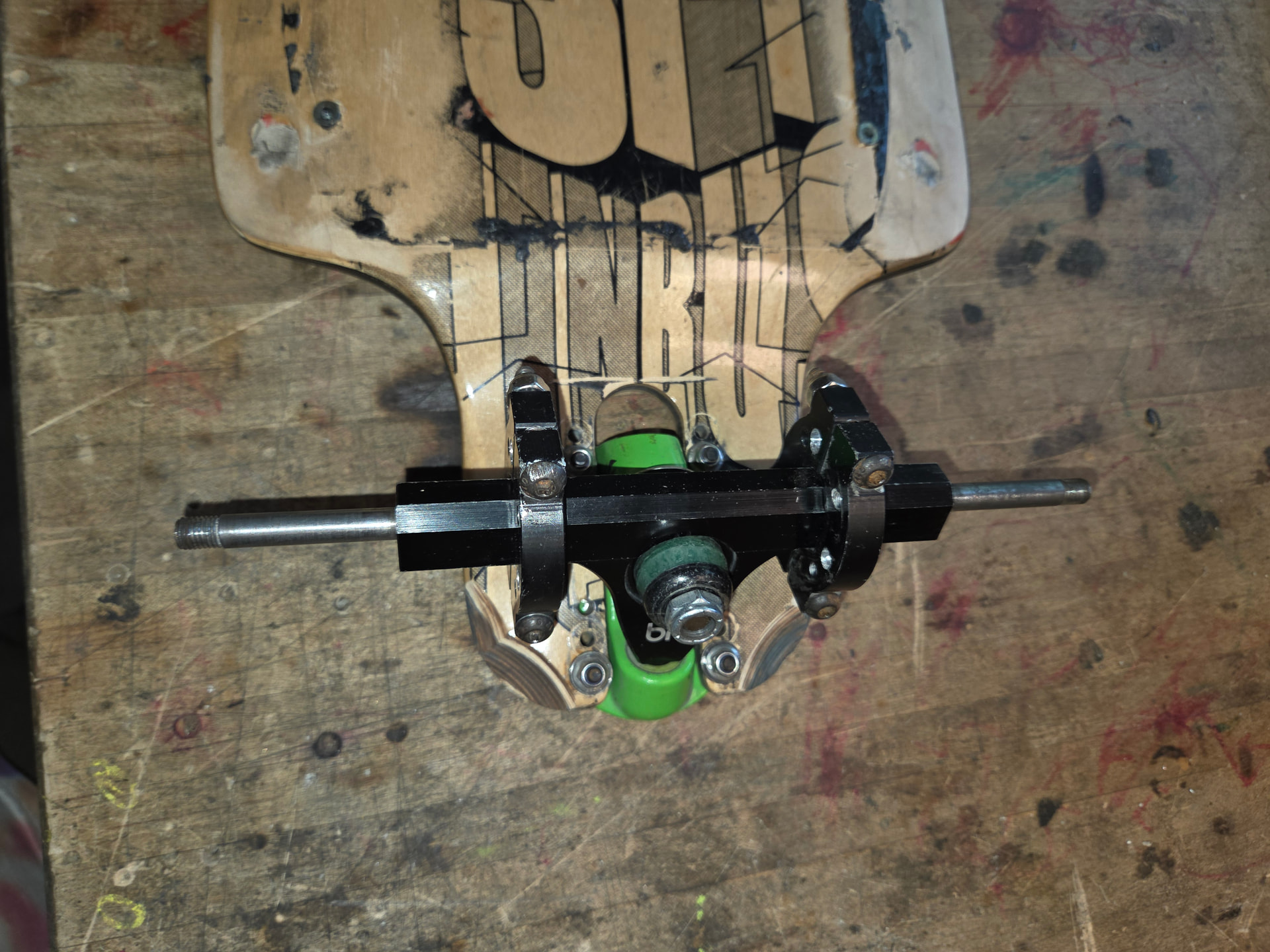

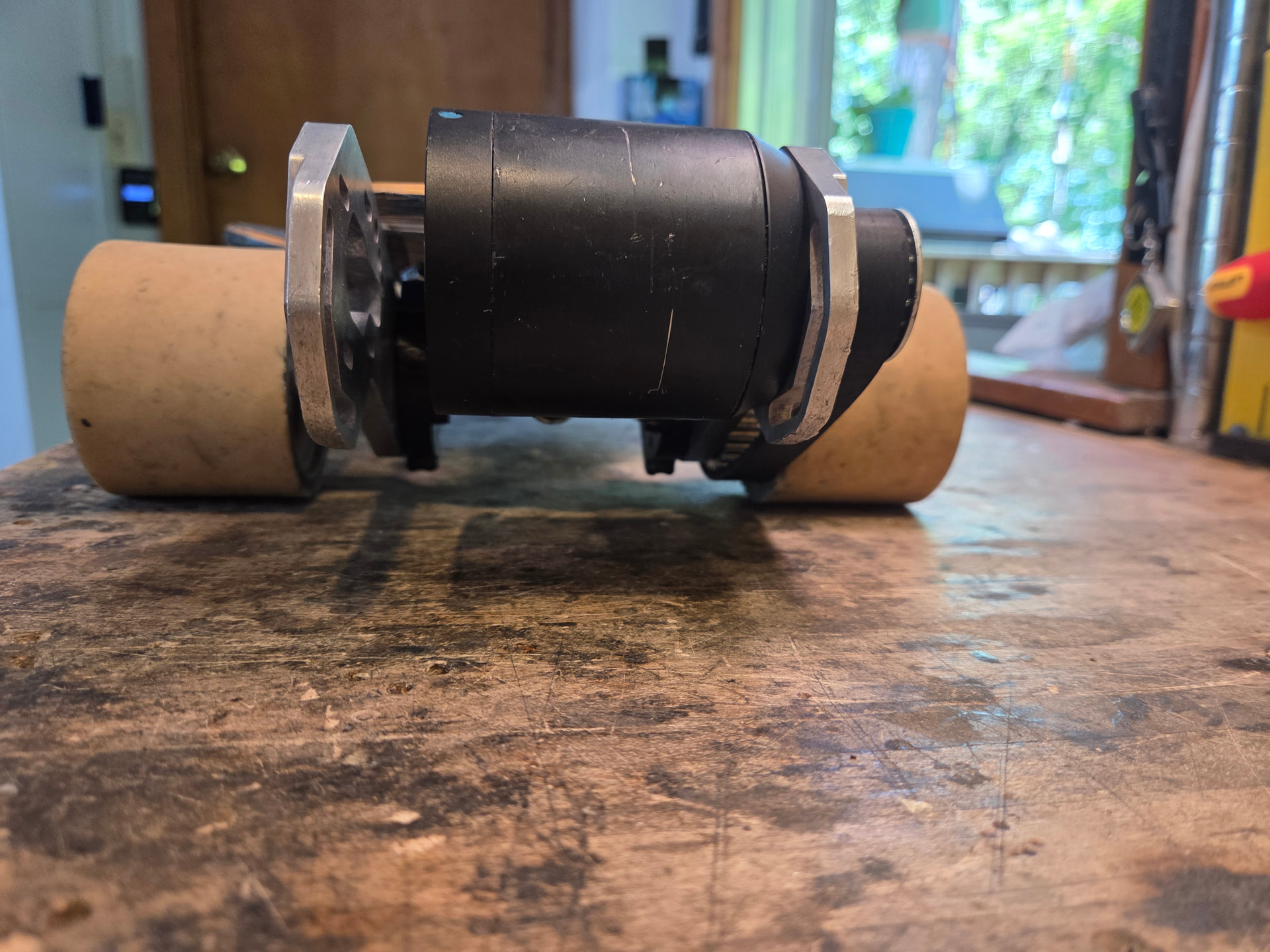

Basically going back to the beginning of figuring out the mounts and motor position to finalize the drive.

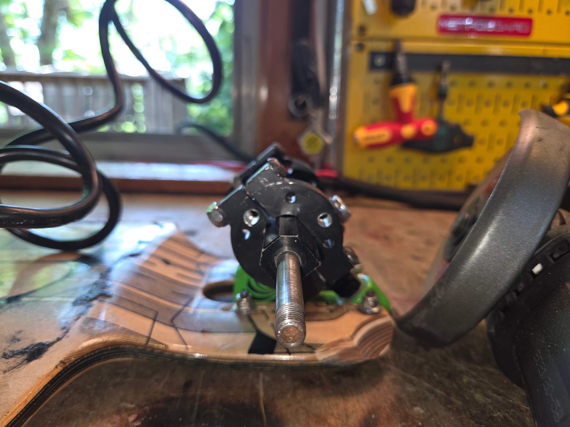

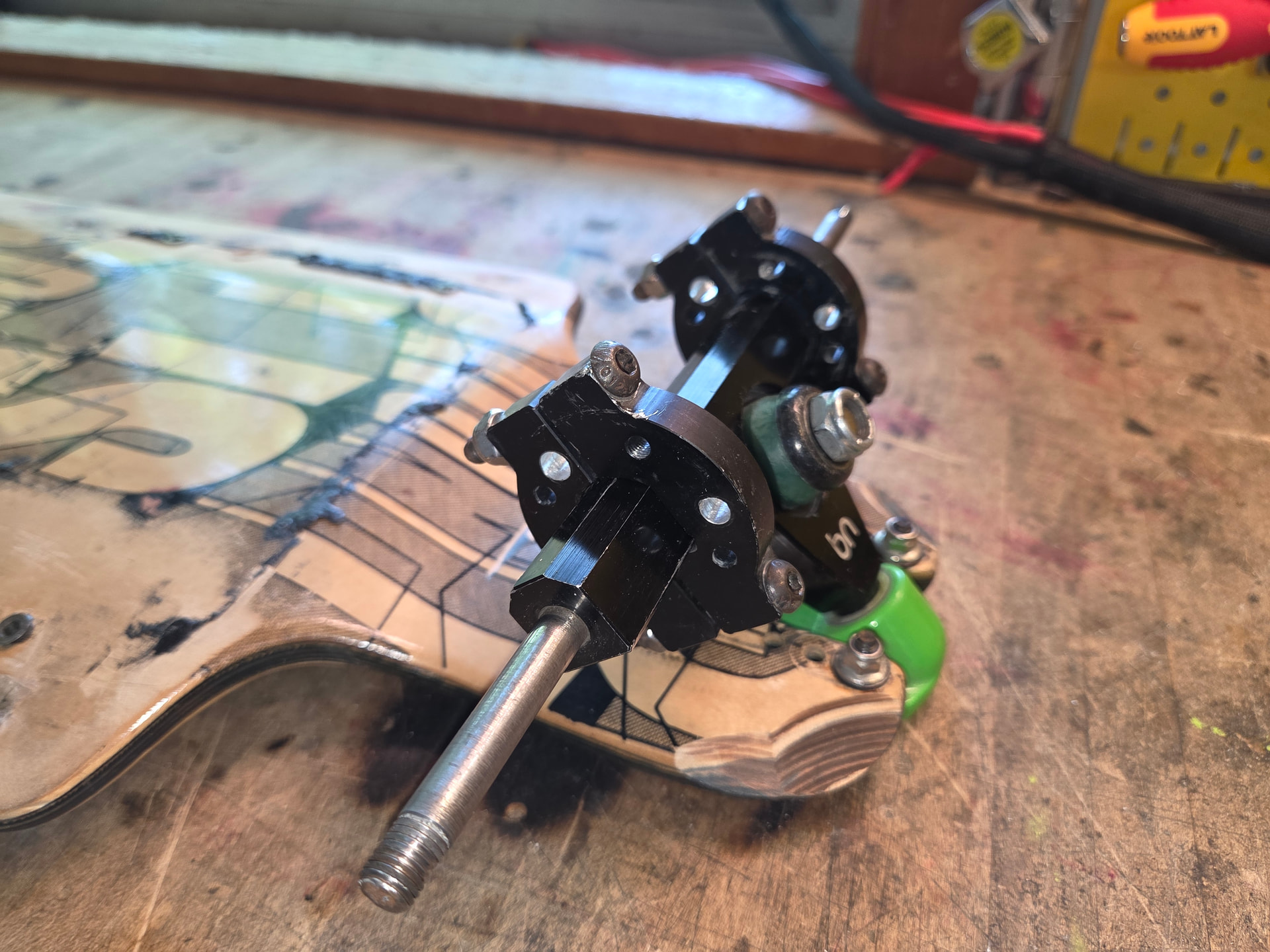

To move ahead and hopefully have the motor a smidge higher I am using the two piece BN clamps with a couple of extra holes added.
These stick out close to the ground a bunch…

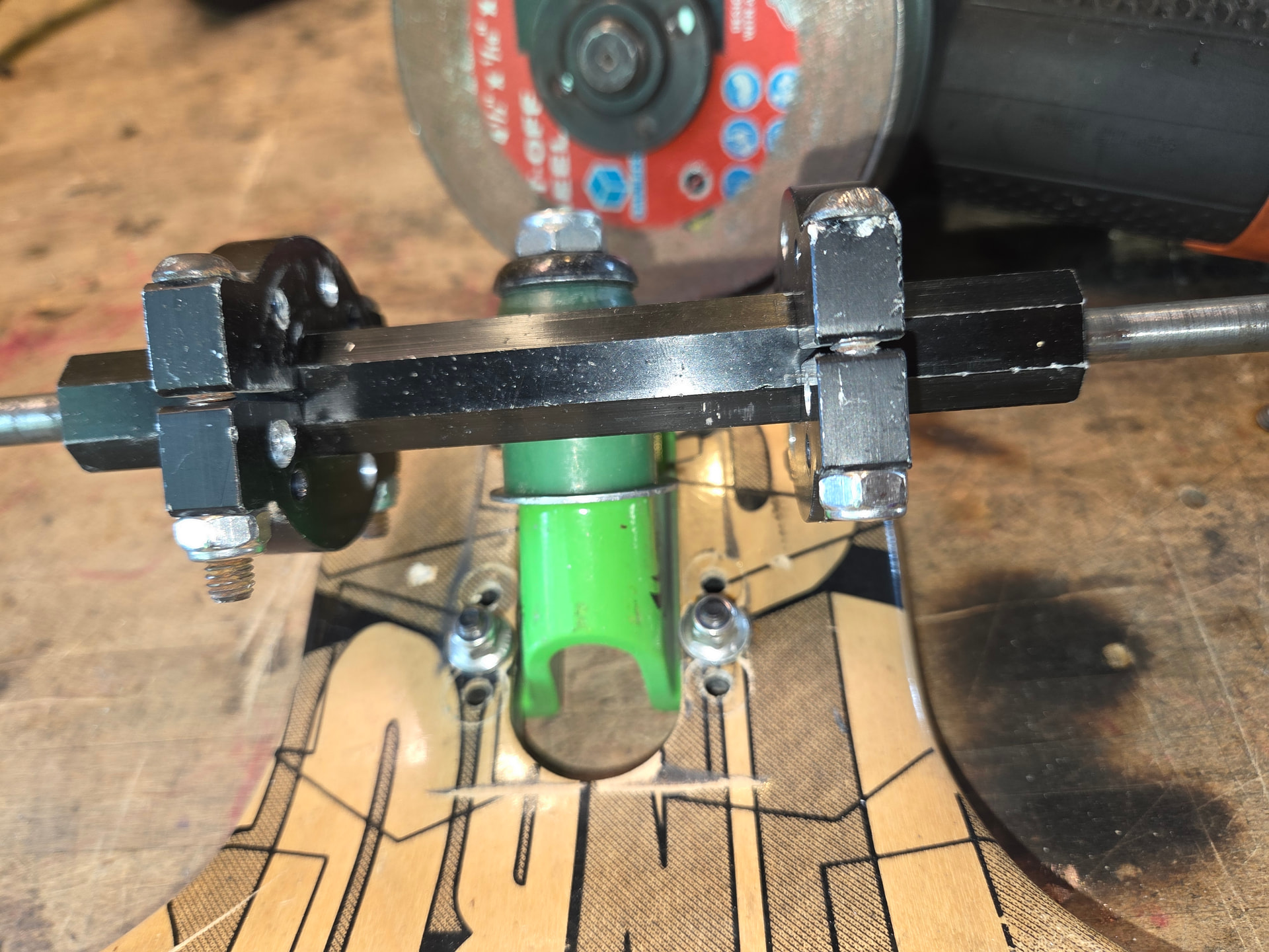

I did get out the angle grinder to cut some bolts and take a couple milimiters off the bottom of the mount clamps…
Note the bolt on the right is no longer sticking out from the nut.
I need to get a picture of the clamps ground down.

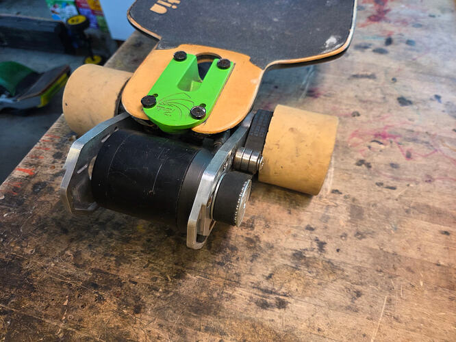

After that I started playing with the angle of the mounts.
The new clamps and holes worked well to give me some range to move up and down.

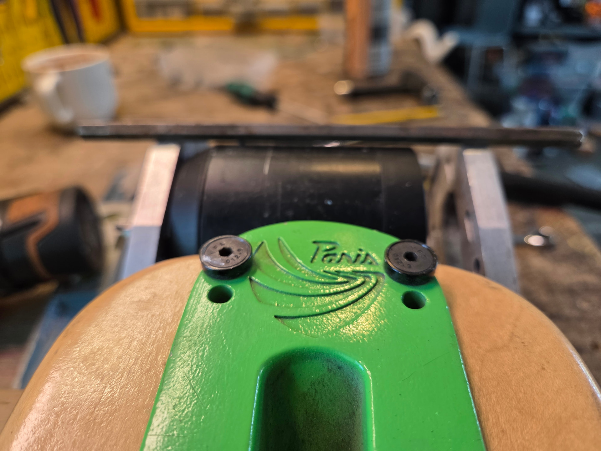

I figured out a clever way to align the mount without the motor.
Just needed to make sure the alen key was even with the motor.

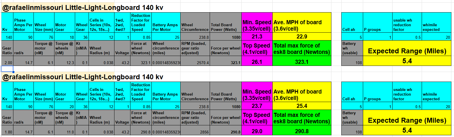

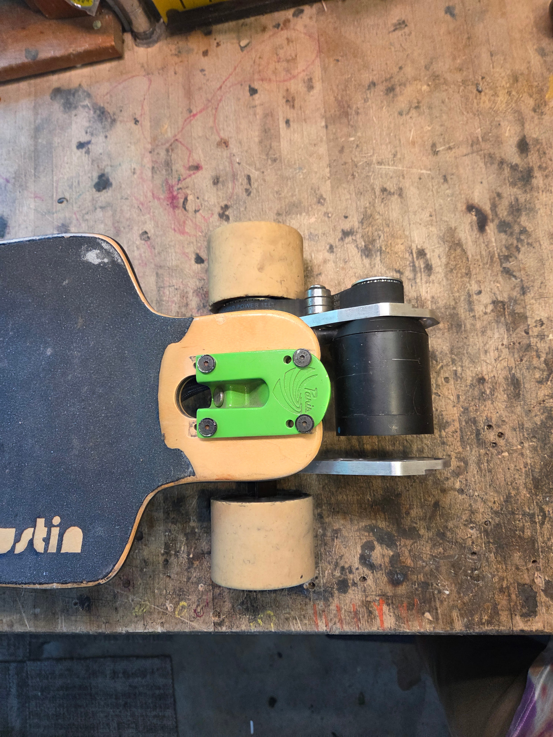

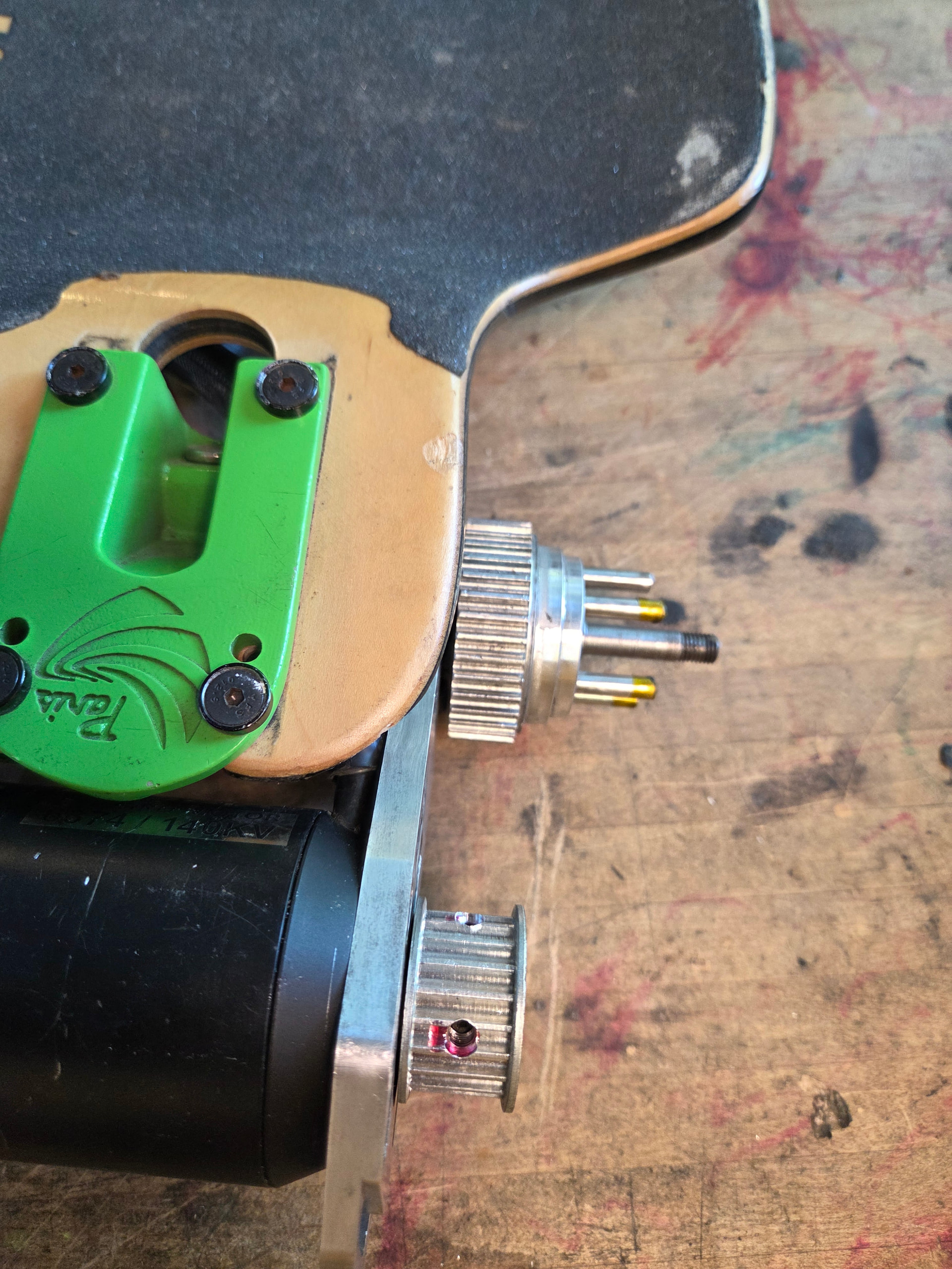

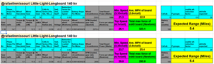

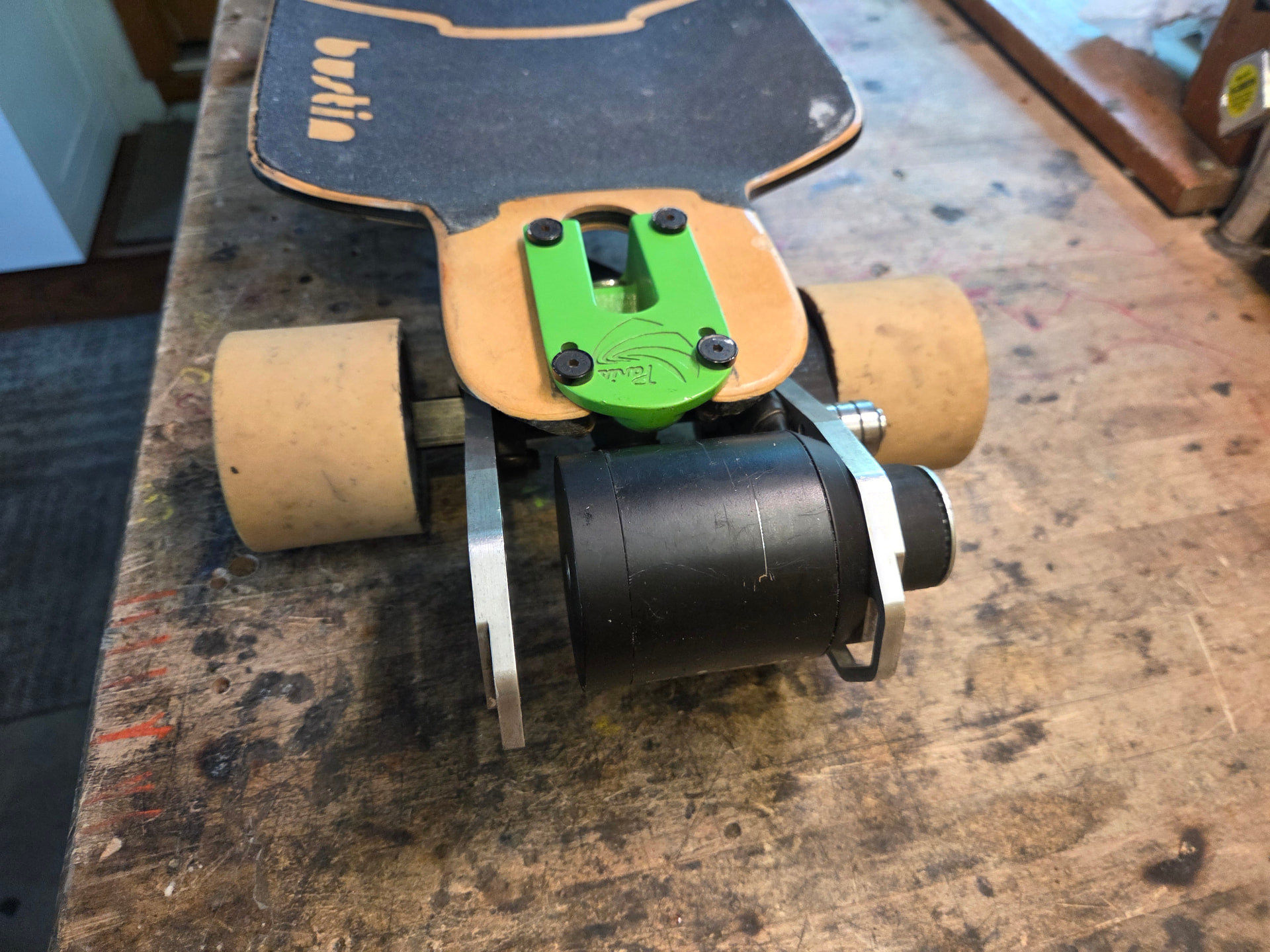

I’m doing a 20 tooth pulley onto a 36 tooth. With the 140kv motor. And 76mm wheels.
looking at the calculator again, maybe I should find an 18 tooth pulley…

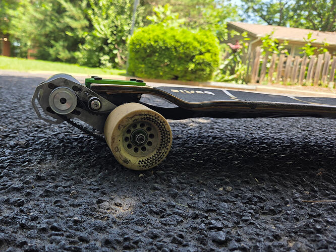

I decided to Go with an idler.
I have the room and it’s single drive.
And I will run the belts super loose ok @Dinnye !!!

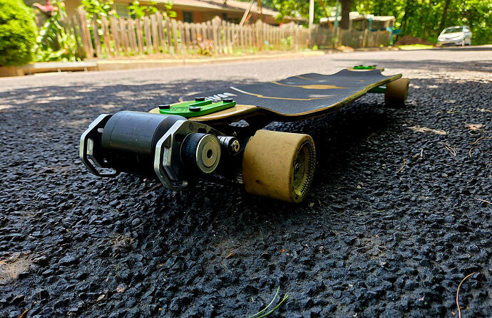

I am pretty happy with the look of the back…
It is not symetrical. But I am not super hung up on it.

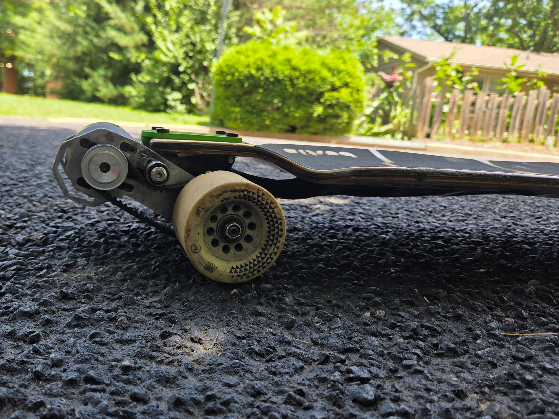

atgfma
Yep.
Mounts are pretty much always sketchy with the 76mm Akashas…

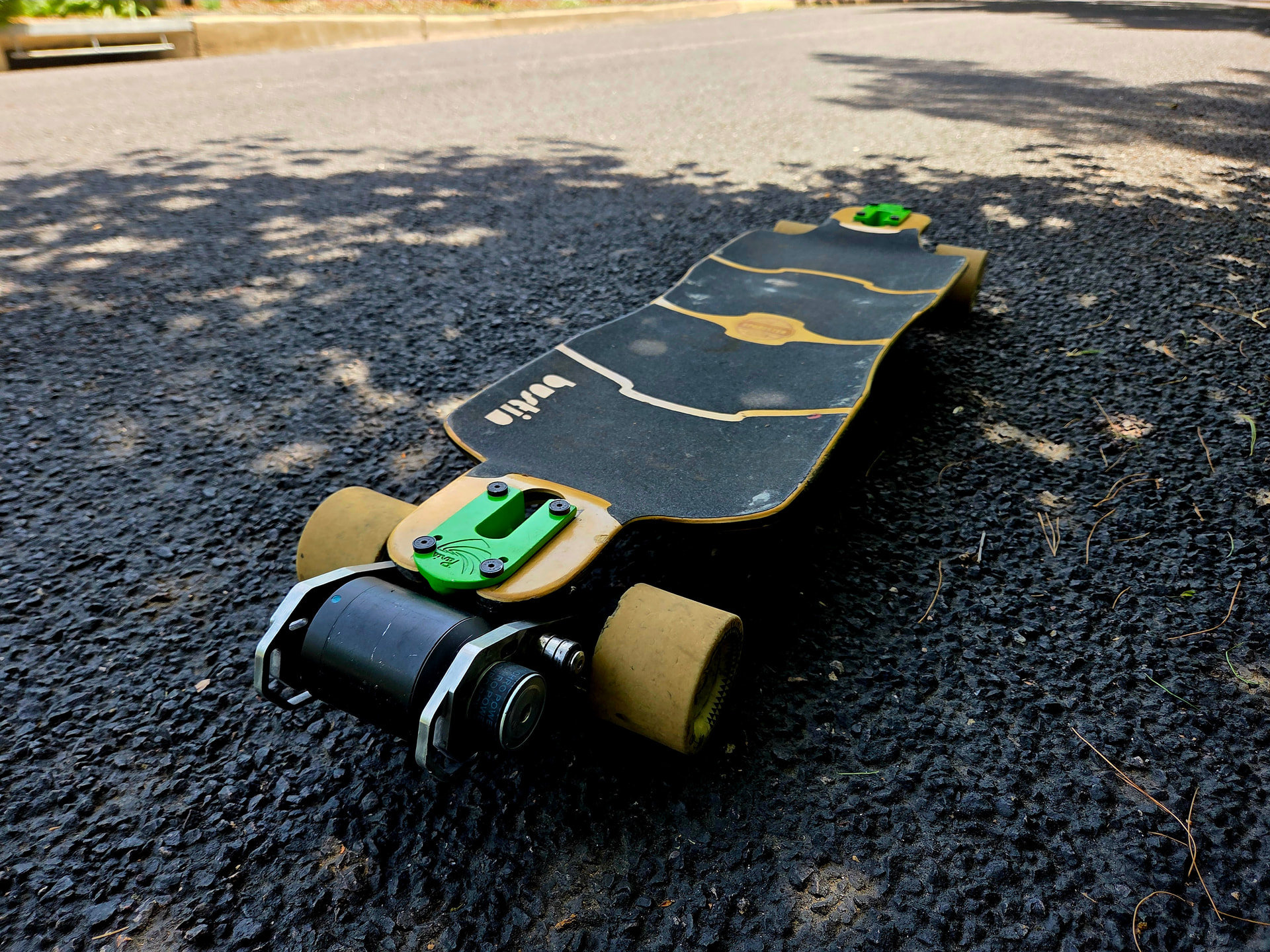

I really enjoy the look of this thing…
The grip tape is pretty beat up. But I am hesitant to do away with the Bustin look.
I also think orange kegels would look killer on here. (I wish they were the soft ones)

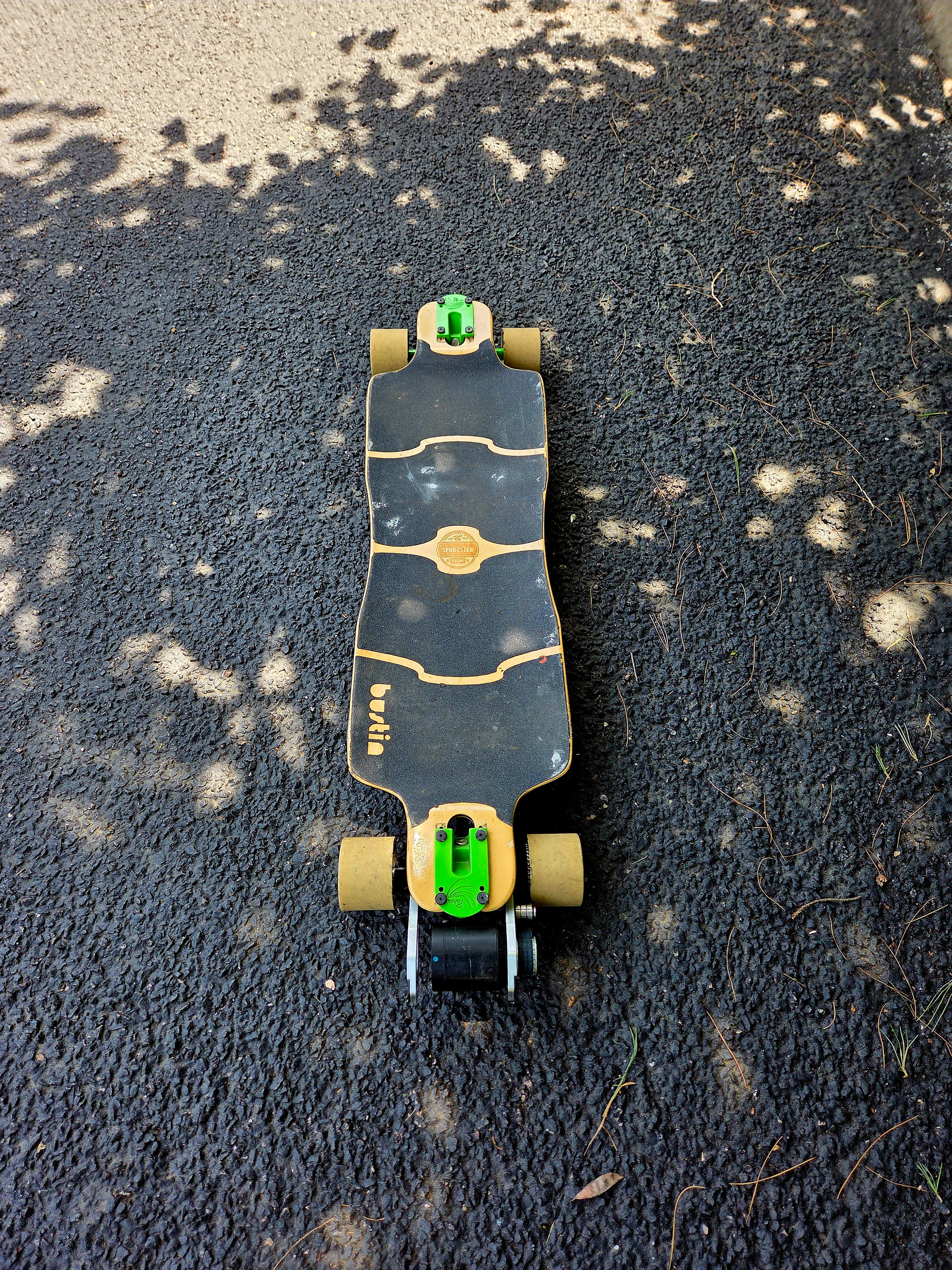

Feels promising.
I rolled around in front of the house.
It’s low low.
It’s snappy.

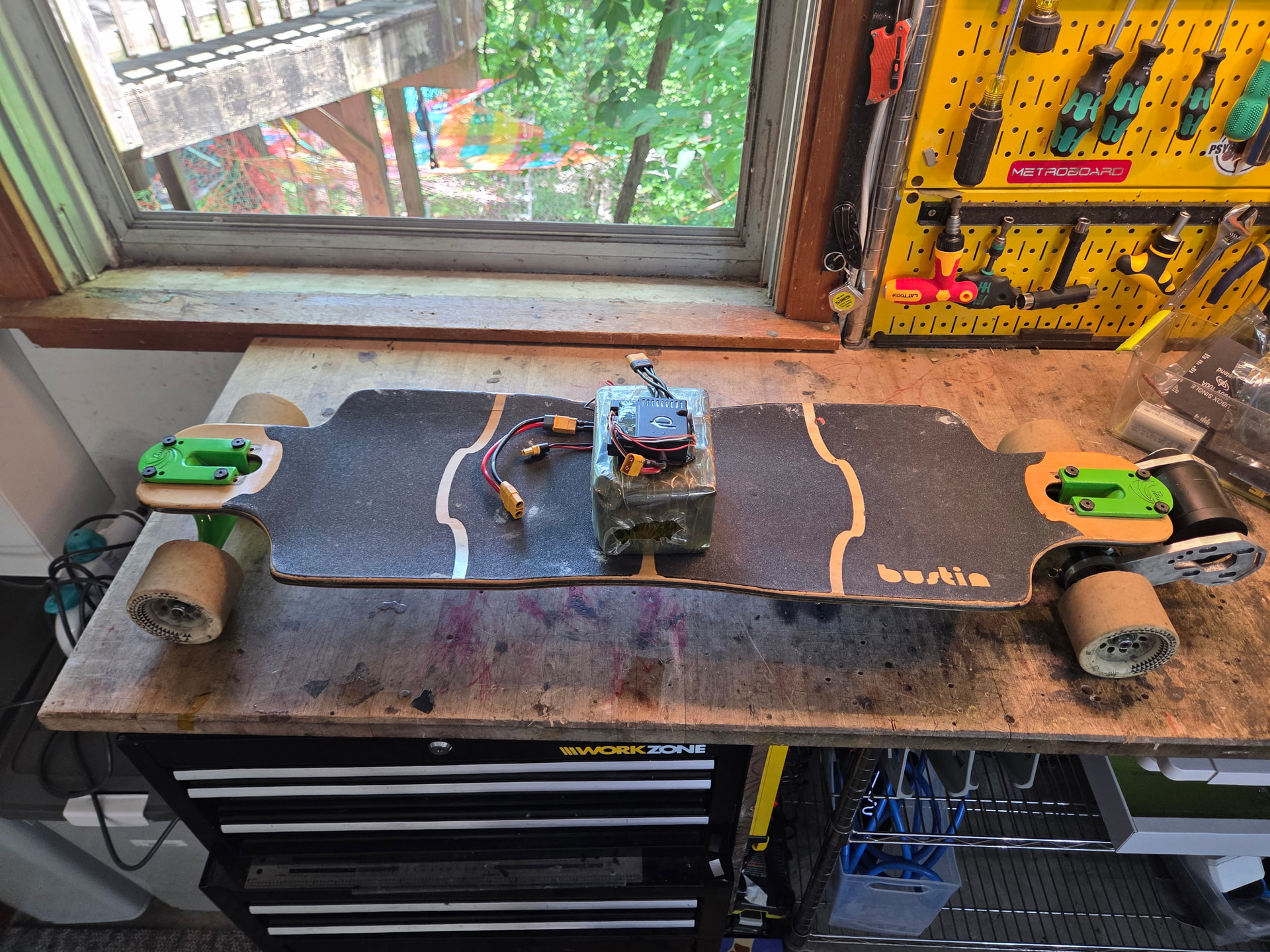

This motor used to live on a mountain board with the esc on the middle box like I usually do.
So it has the long long legs.
Funny thing. Is I am now thinking of mounting the little pack and focbox closer to upfront to distribute the weight a bit more.
I still have to build the little 12s1p. Could be ages…
But I am going to try and electrify with this battery on top.
Easy to do with the extended cables.

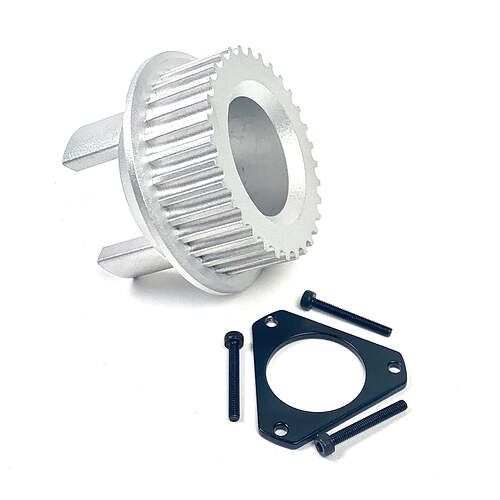

I’ve really loved the Hoyt 83mm wheels on the MBoards site:
Obviously they’re not Kegel, but the bolt-on pulleys fit them SO nicely:
Having to get pulleys makes it so fucking annoying…
If it helps, I am pretty sure you can get the set of wheels + pulleys for under $35. :smiley:
I am serious, Hoyt did a good job with these, they are really neat.
