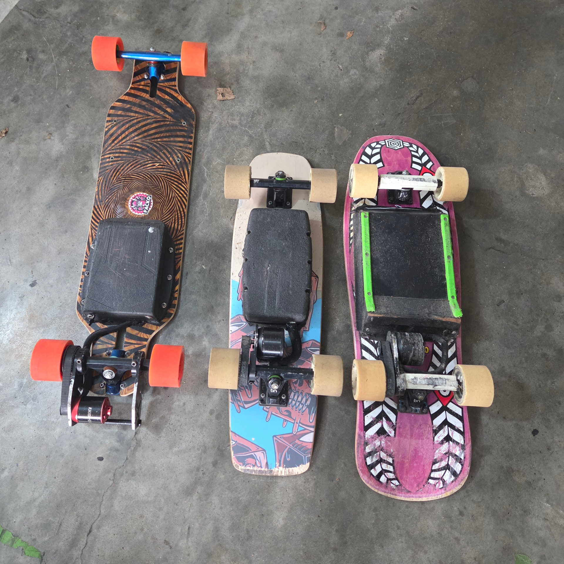

1WD is definitely the way to go if you wanna reduce cost and weight, but as people here obviously already know, braking and accelerating will suck.
I like to have some skateboard like set ups. And I think single drive is good for that.
Definitely a compromise in power, but I love the feeling of light boards and the freeroll.
The little longboard is for the little guy.

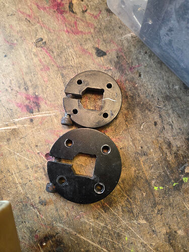

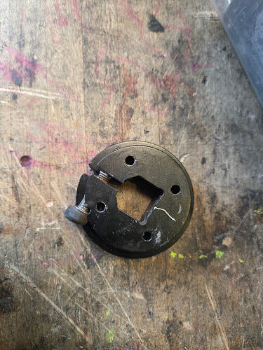

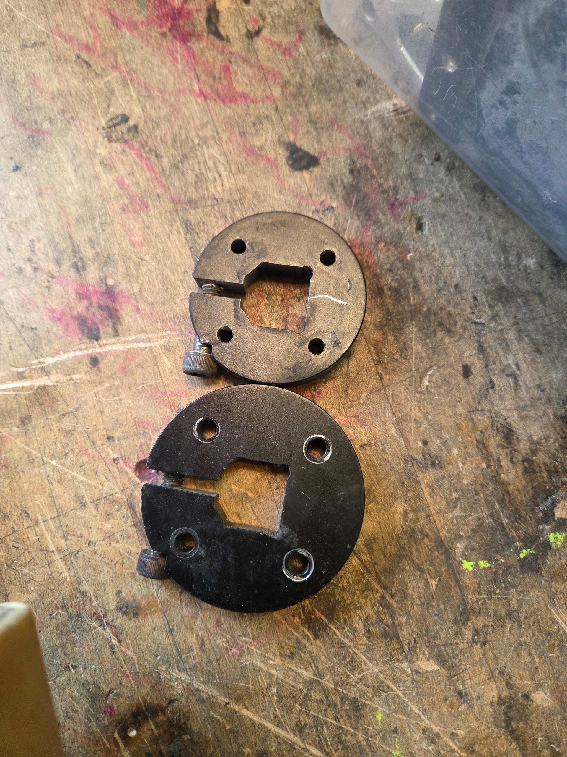

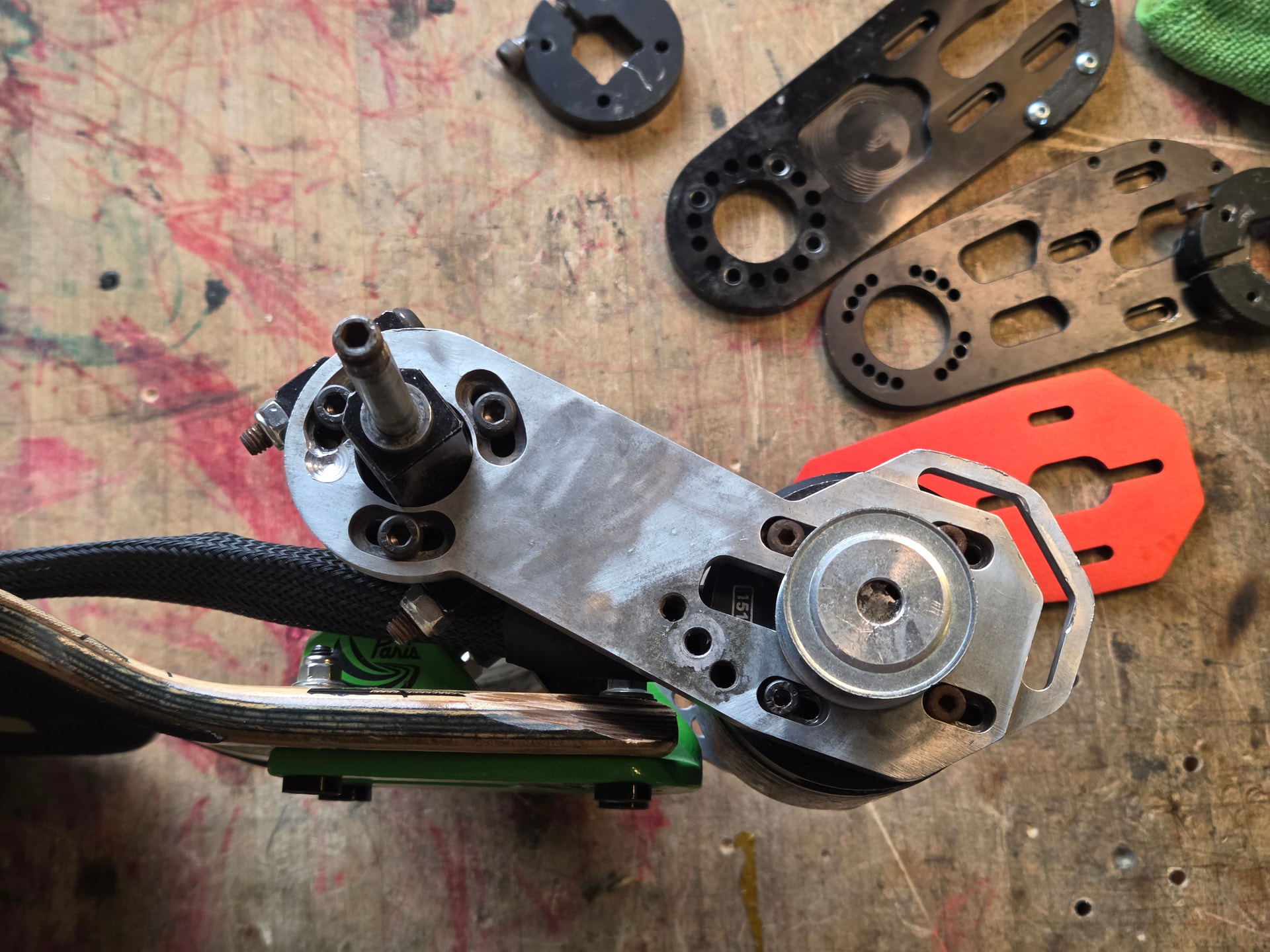

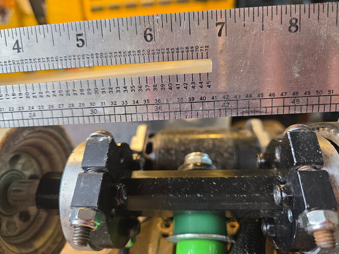

I need to get back to dealing with the death mounts.

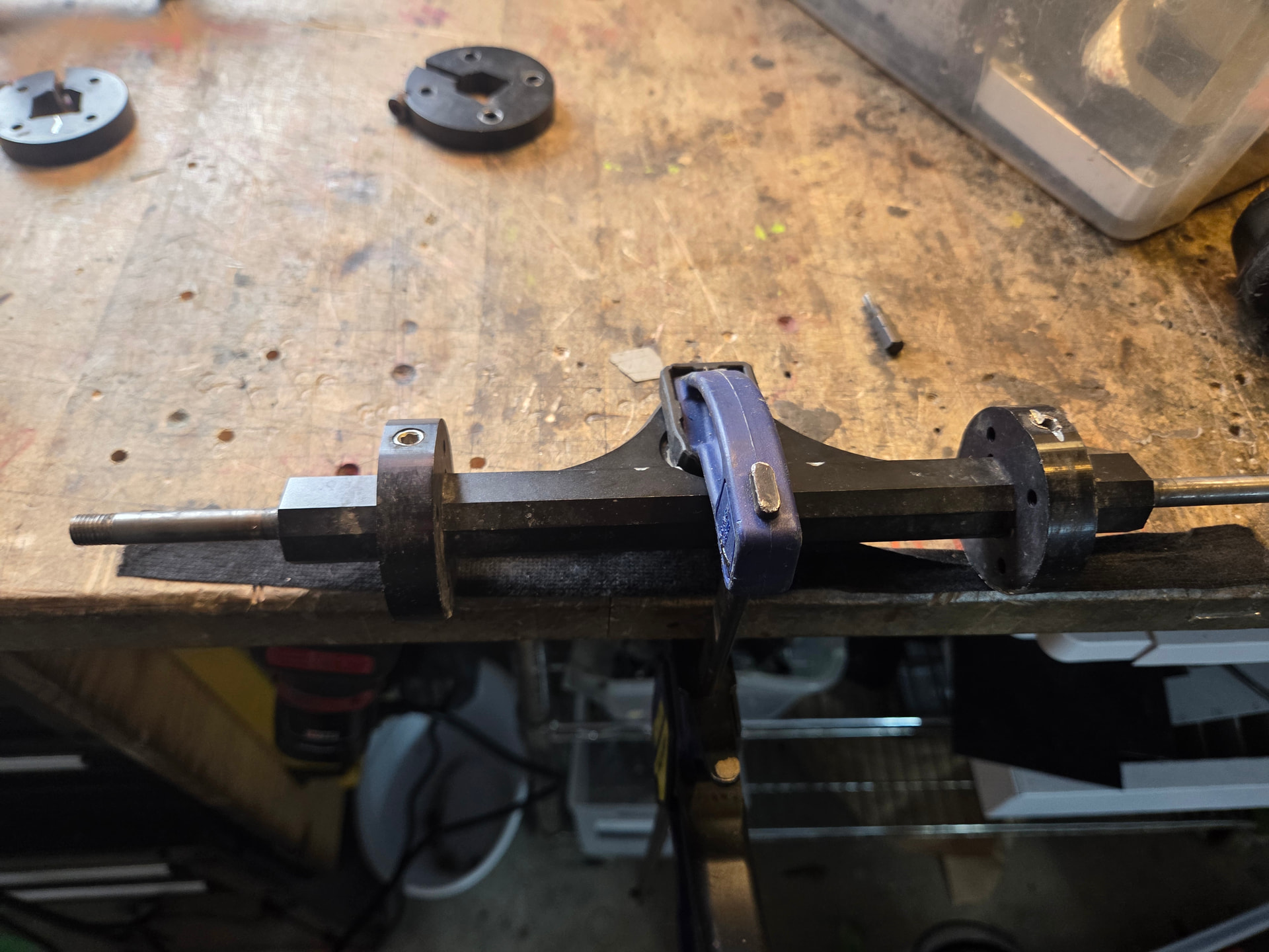

I looked at different things. The BN XL clamps are huge and would need all kinds of modification.
I clamped the old BN hanger with the stuck Idea clamps to the bench, but decided not to tackle it.
I looked at using the BKB axle and plates. But the plates don’t spark joy like the TB ones do.
I looked at the Tito’s plates again too, and it’s the same story. Something would need modified

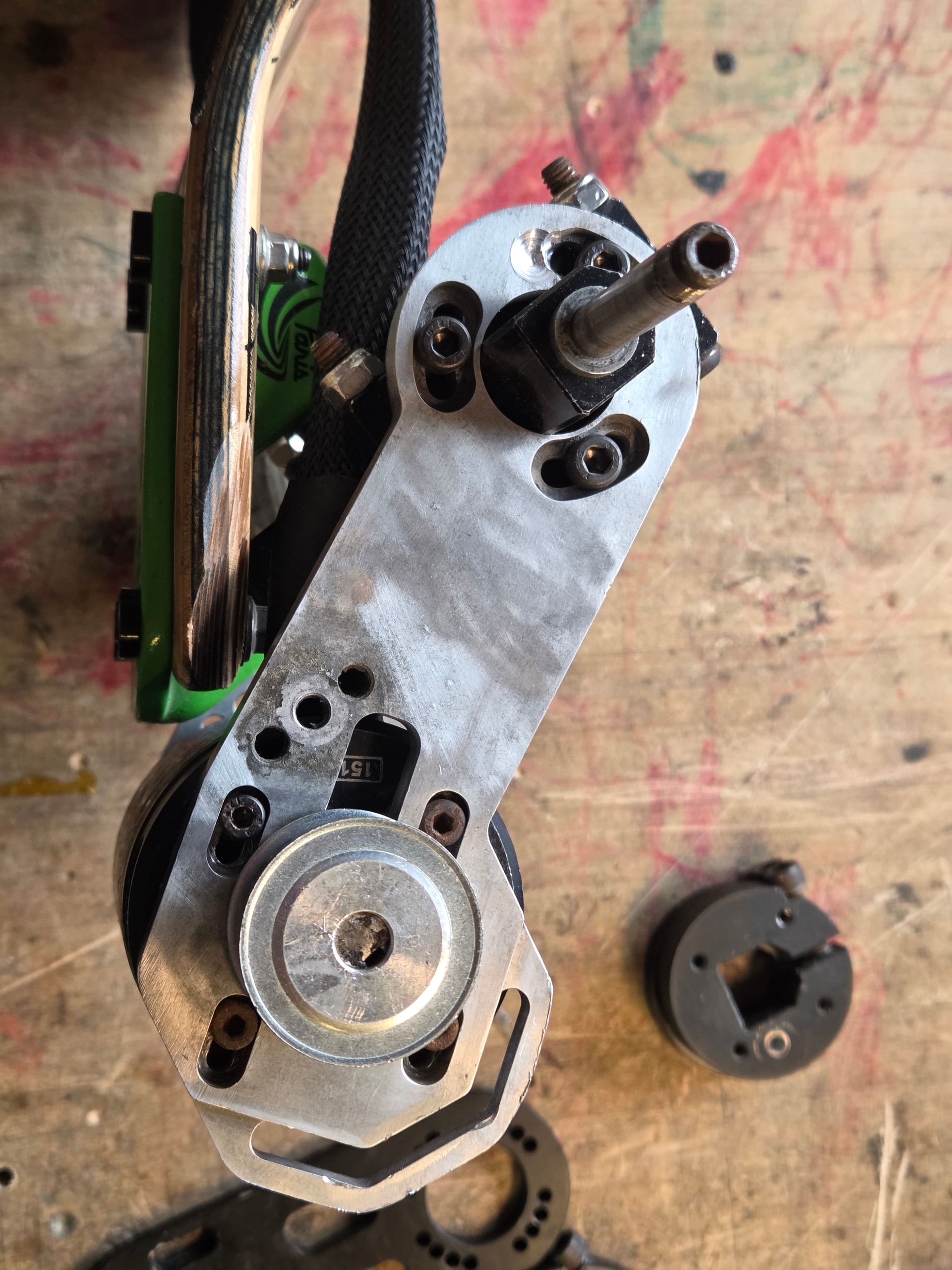

I decided I’m going to revisit the BN single clamp.

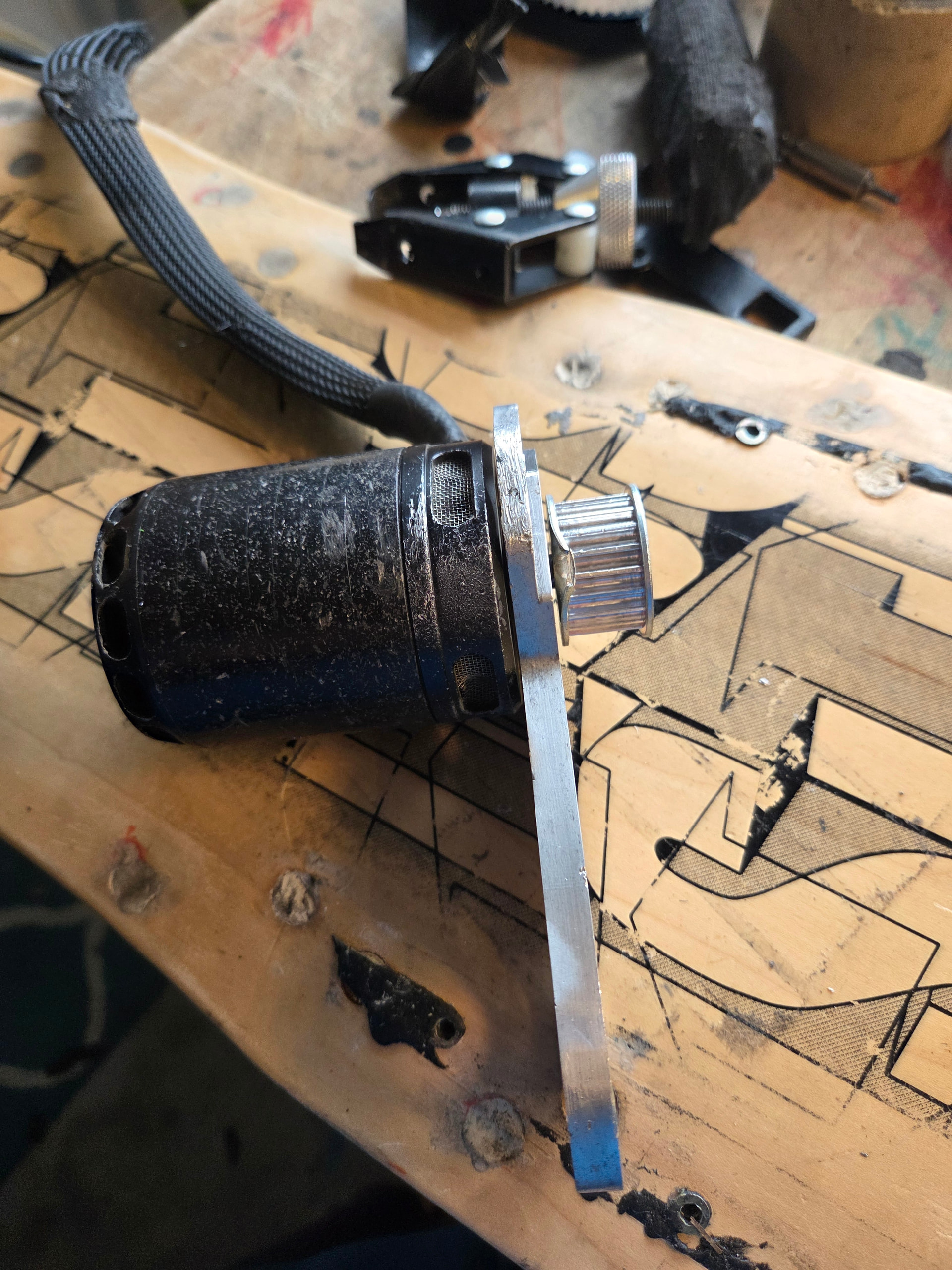

You can see the original hole… makes me feel like I’m making all this harder than it is to move the motor up.

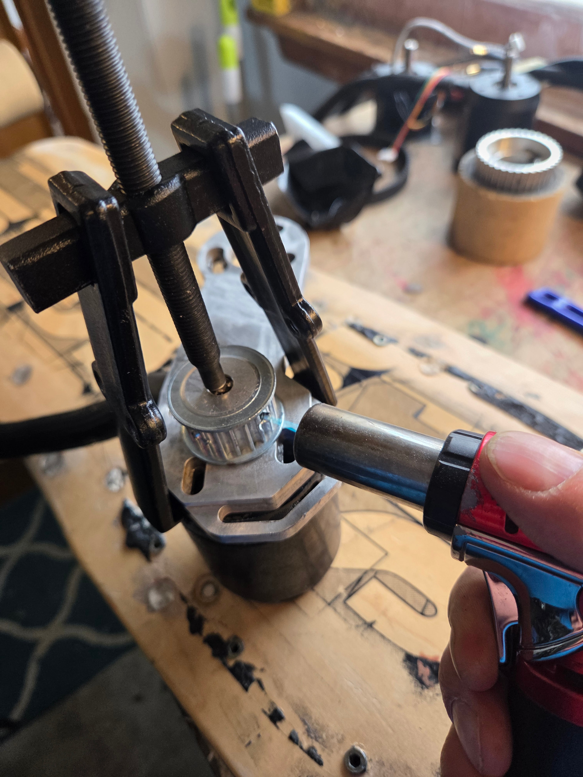

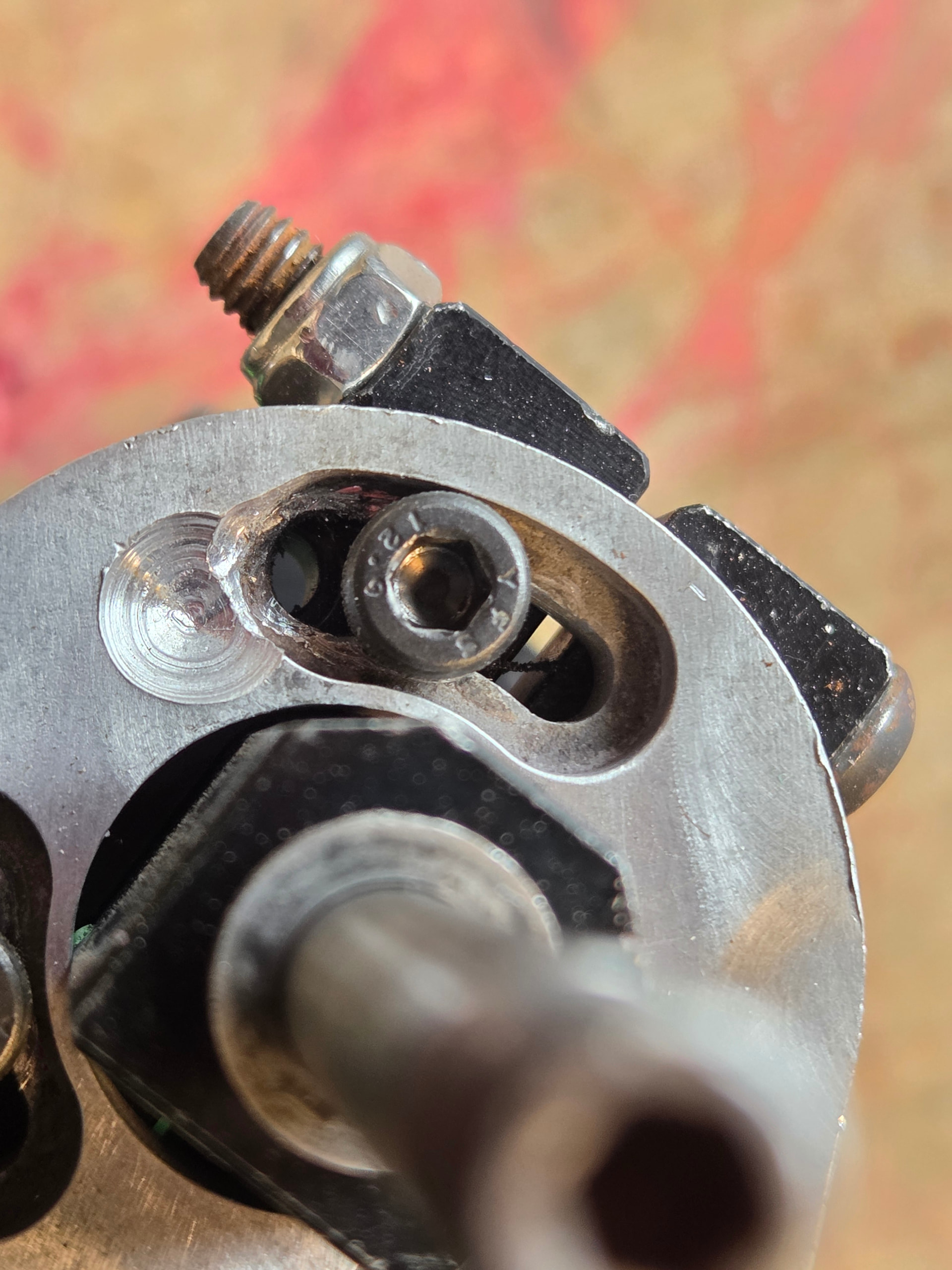

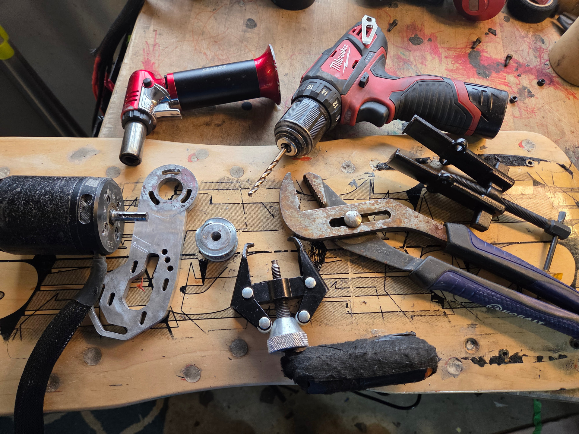

I think a solid 15% of my DIY experience is taking pulleys off.
Really hoping not to destroy these new ones…
Today I lost the battle.
I don’t understand why such basic shit is hard for me after all these years.

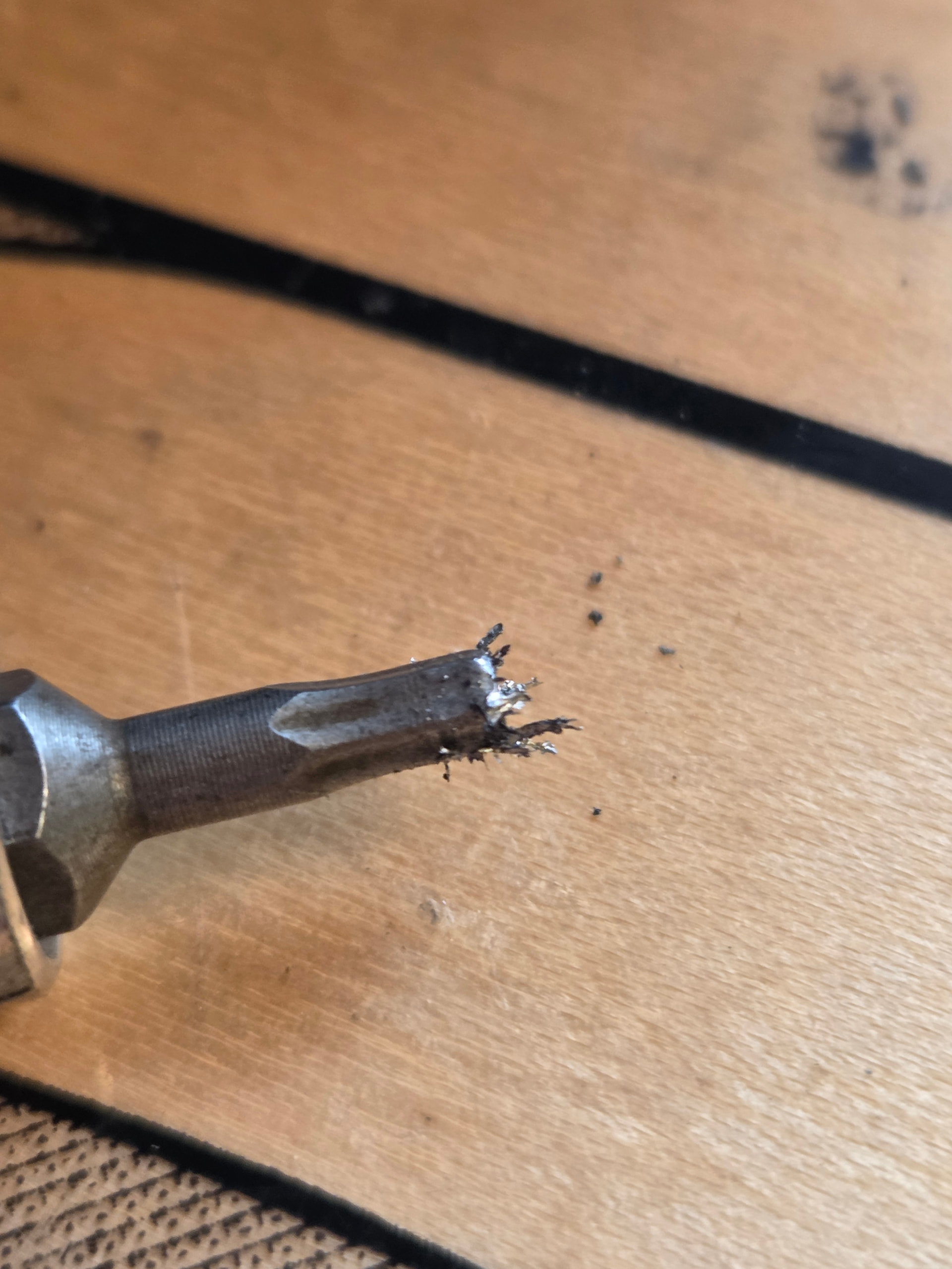

I torched it with the little torch…
I used Wera Plus hex key.
I still managed to strip both of the set screws on the pulley.
The pulley is already destroyed. But worse of all it is still there.
Moving on to try and drill out the grub screws.
Kids that buy a shinny new Parsec will never understand my pain …
Holy bananas dude.
What a detour.
This picture here really captures this classic ā€œDIY is a Diseaseā€ moment!!!
PSA kids.
Remember to wear eye protection when fighting with your esk8.

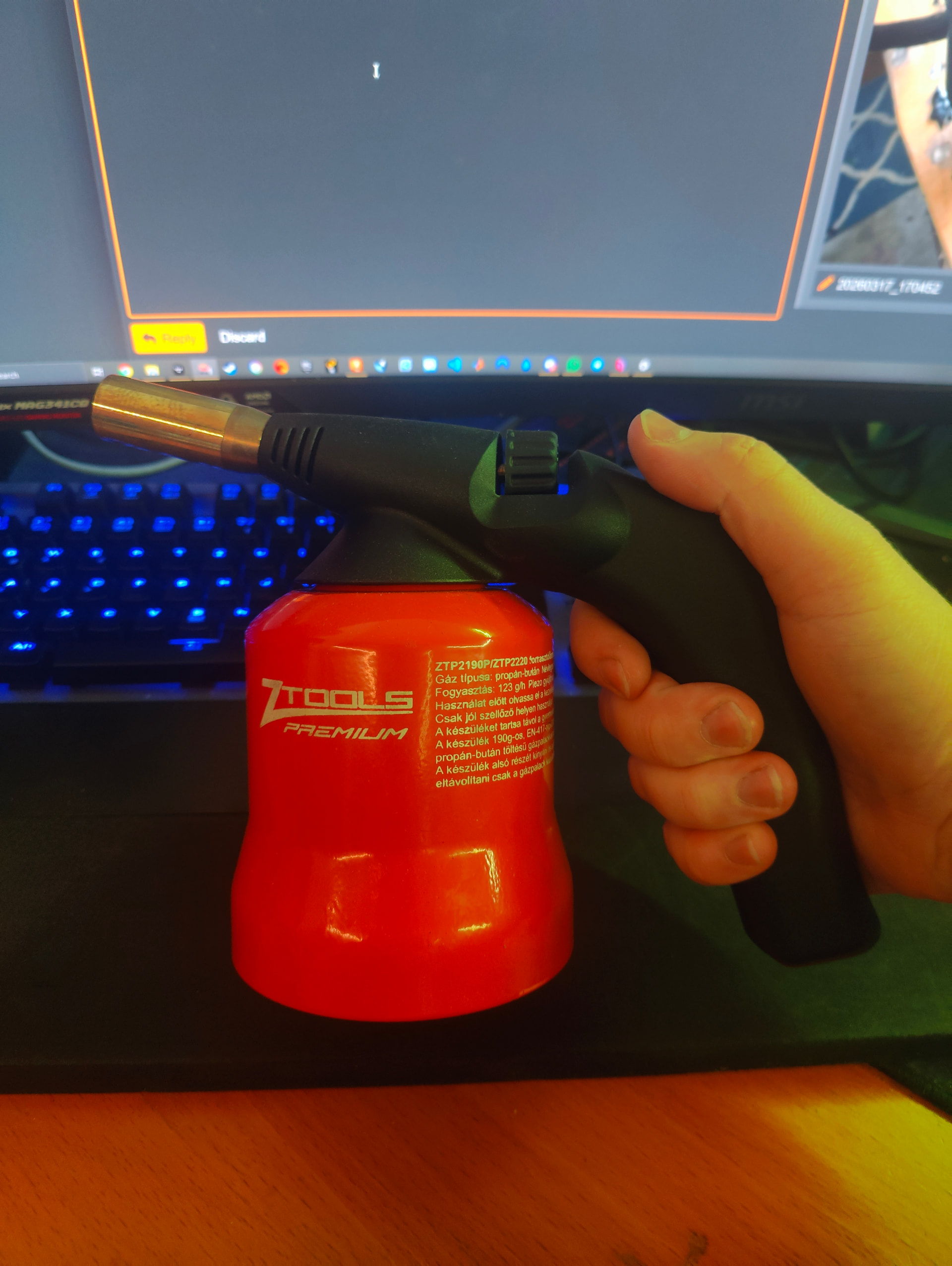

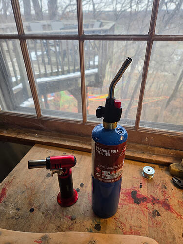

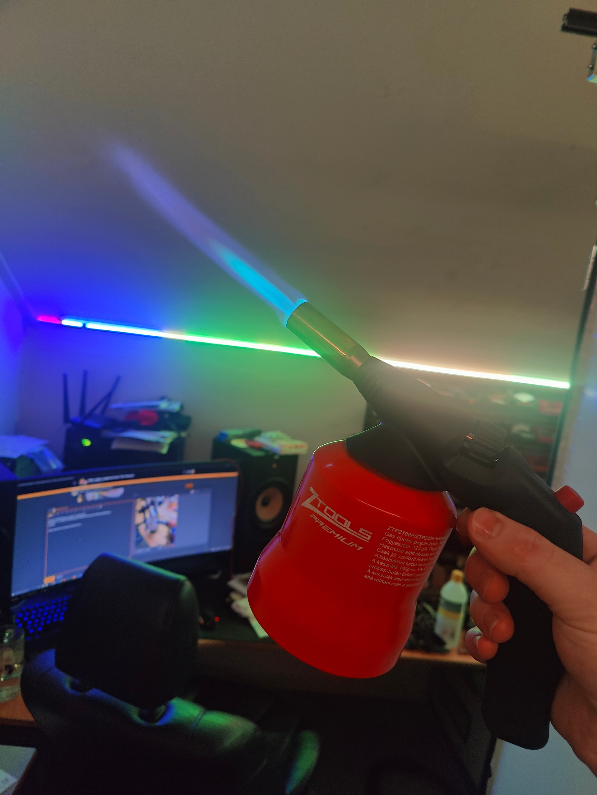

Dude, that torch is a joke for jobs like this…
Get a blowtorch similar to this. I think I paid around 30$ for this one…
It makes this job so much easier, you wouldn’t even believe. I torch it until the loctite starts smoking (30-60 sec depending on size) and then it slides right off with very little effort.
You know. I have a bigger torch.
I looked for it. I could not find it in my messy garage and I just now remembered it is in the basement.
I have had success with the little one plenty in the past.
But obviously it has left something to be desired.
Bit torch it is from now on…
Sometimes too little is too late…

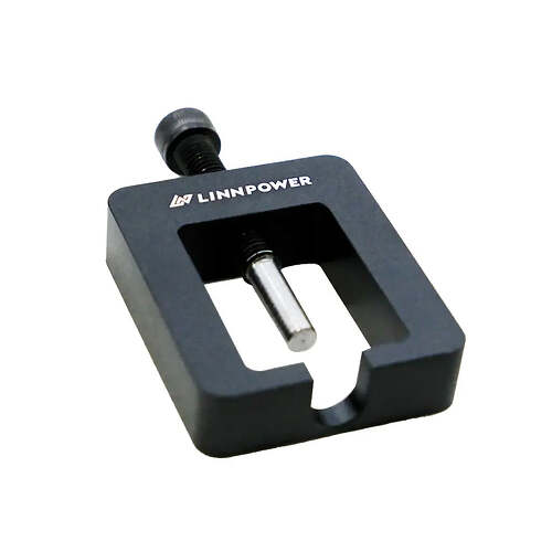

My mate designed this
I mean it wouldn’t help here since the motor mount is attached, but just in case you want a better pinion puller instead of using a generic bearing removal tool
That is nice but the chunky part on the bottom woul make it not usable for most of my situations…
I wish all motor mounts had the slit to just slide out…
