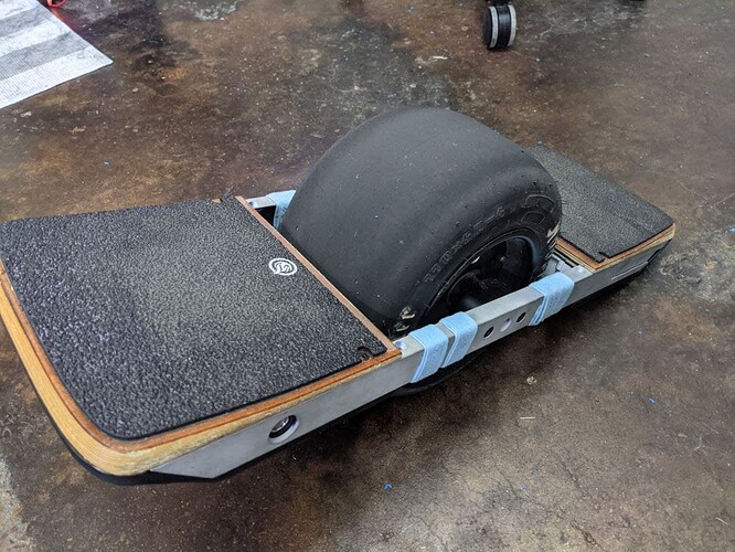

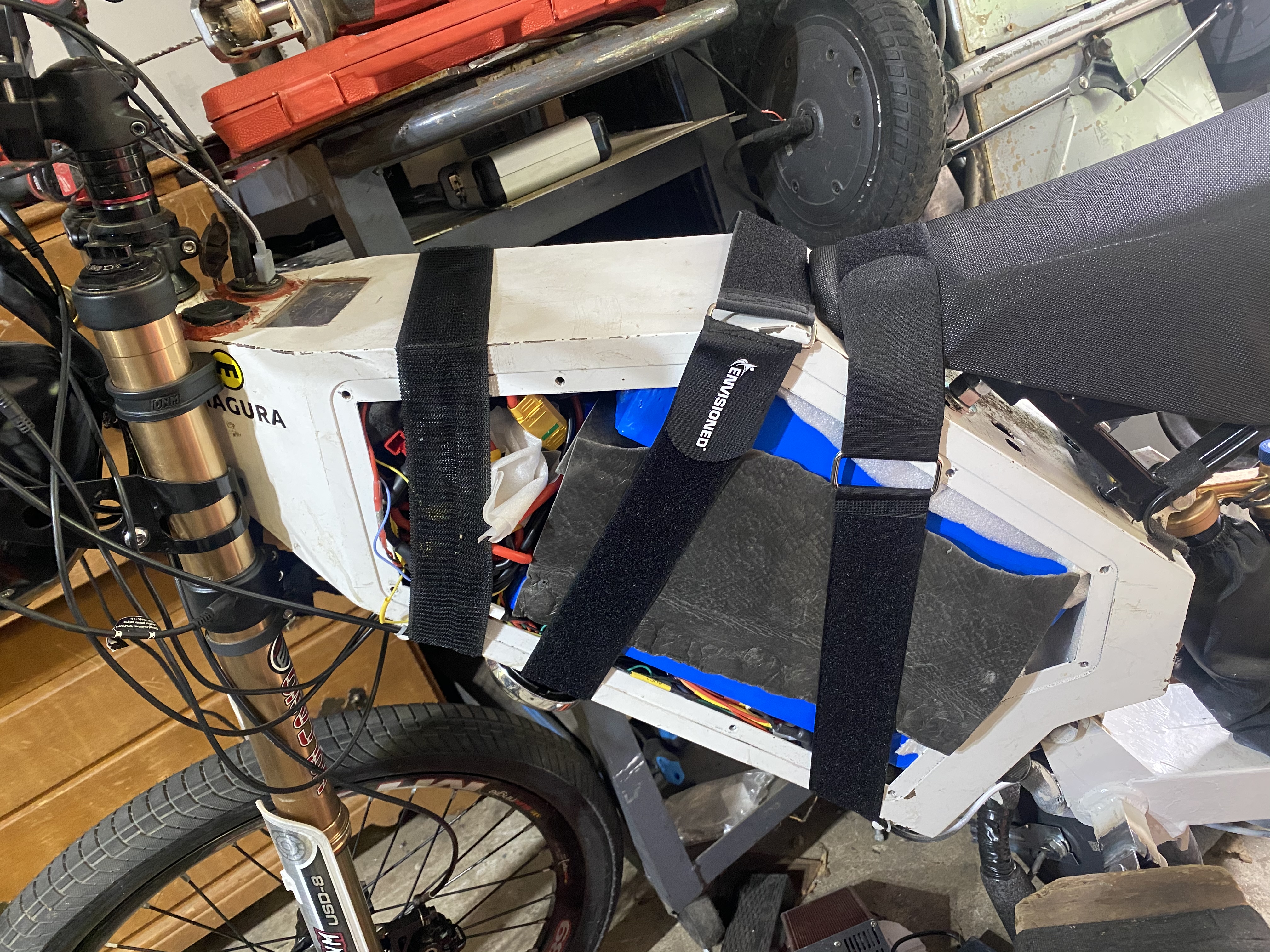

I’ve been testing what I refer to as the big little focer. I was so excited to test out the larger mosfets I forgot to electrically insulate them from the heatsink and killed it dead
. @shaman was very patient with me despite my noob mistakes. Anyways, got another unit yesterday and put that bad boy in my kids dirt bike. My goal as a parent is to make the most dangerous toys possible
. I was able to push it to 200 phase amps, 300 max amps and 100 battery amps. It’s so fast my wife won’t ride it anymore, see vid in google link. Compared to the little focer it’s got way more low rpm torque. If I can figure out how to make an interesting video I’ll post one. Not a fan of going 60kmh with only one hand on the handlebars though. I also put it in my stealth bomber clone. For its size I was very impressed with the performance. Got up to 75kmh with a 16s 60v battery. I was pushing it to the max and think I need a better cooling situation. One shitty 5v fan wasn’t quite cutting it when going up long hills. Still very impressive nonetheless. I was even able to get my 5,000 watt rated motor with ferrofluid and hub sinks up to 60c with -200a of regen. Chirped my tires with that much regen and they are very grippy tires, like the bicycle equivalent of racing slicks. Anyways, hopefully this won’t cause everyone to get a bad case of blue balls but it’s going to be fucking awesome. Thank you for all of your hard work @shaman.
