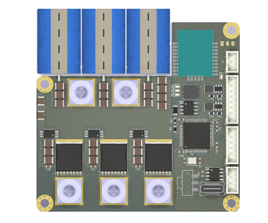

What do we have here?
How this has landed here so fast?
I just updated my latest board design on my website yesterday…
@jesus What is this? How is this relevant to the Little FOCer? @ENNOID is this your design? If so, I apologize if you didn’t want it to end up here.
Yes it is my design.
It is not to you to apologize, it is your thread. and this guy Jesus decided to drop this here for no reason. So, sorry on my side.
I started my own thread for this.
I’m sorry, I wanted to show the connectors used on the board to discuss it with you. Should’ve prefaced. sorry ennoid for posting this here… In either case both your board layouts and interesting and good to see next to each other!
Are you referring to the threaded SMD posts for the DC and motor phase cables?
