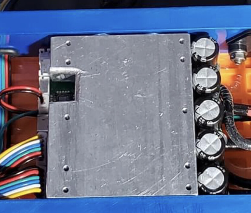

Interesting heatsink mod for better connection found on Facebook
I did something similar a while ago on the lab bench to see if it helped. I didn’t do much from what I could tell. Your mileage may vary.
