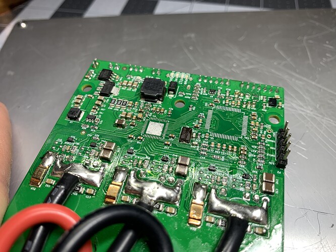

I tried getting the chip off while fully assembled but all the dang heatsinking makes the ground plane hecka hard to heat from top only.
I just ordered something I needed quite bad, a second hot air gun for dumping heat on DRV chips. This will allow me to blast air at the perfectly bare underside of the ESC directly under the DRV chip. Should work a charm I think. I even got some long curved nozzle for the job!
Makes me wonder if they make little riser blocks you can set on a hotplate to be able to transfer heat to a small surface are like that.
Ok on a second look my CAD model was quite wack
Hmm maybe I could have avoided the second hot air machine…
Or St. Anger for about an hour.
Put solder on the drv sink, don’t roast it.
Drill 10mm hole in table and hold with pliers.
Use a mirror to make sure you don’t knock the iron into the fet, I held the esc solid with blocks.

First time doing SMD or using a hot air station… getting the chips off went good
Knocked a bit of solder mask off by the DRV with the solder wick but it should be fine.
I think I did good on the DRV, STM should be here in a few days…
Blue light!!!
Cool! Nice job so far. Be sure to let me know once you’re ready to boot up the new STM. There’s some preliminary checks I advise doing to make sure everything is operating as it should be

Got the STM32s in yesterday, they went on pretty easily and I’m riding again!
Unfortunately the other FOCer has some DRV issues…
