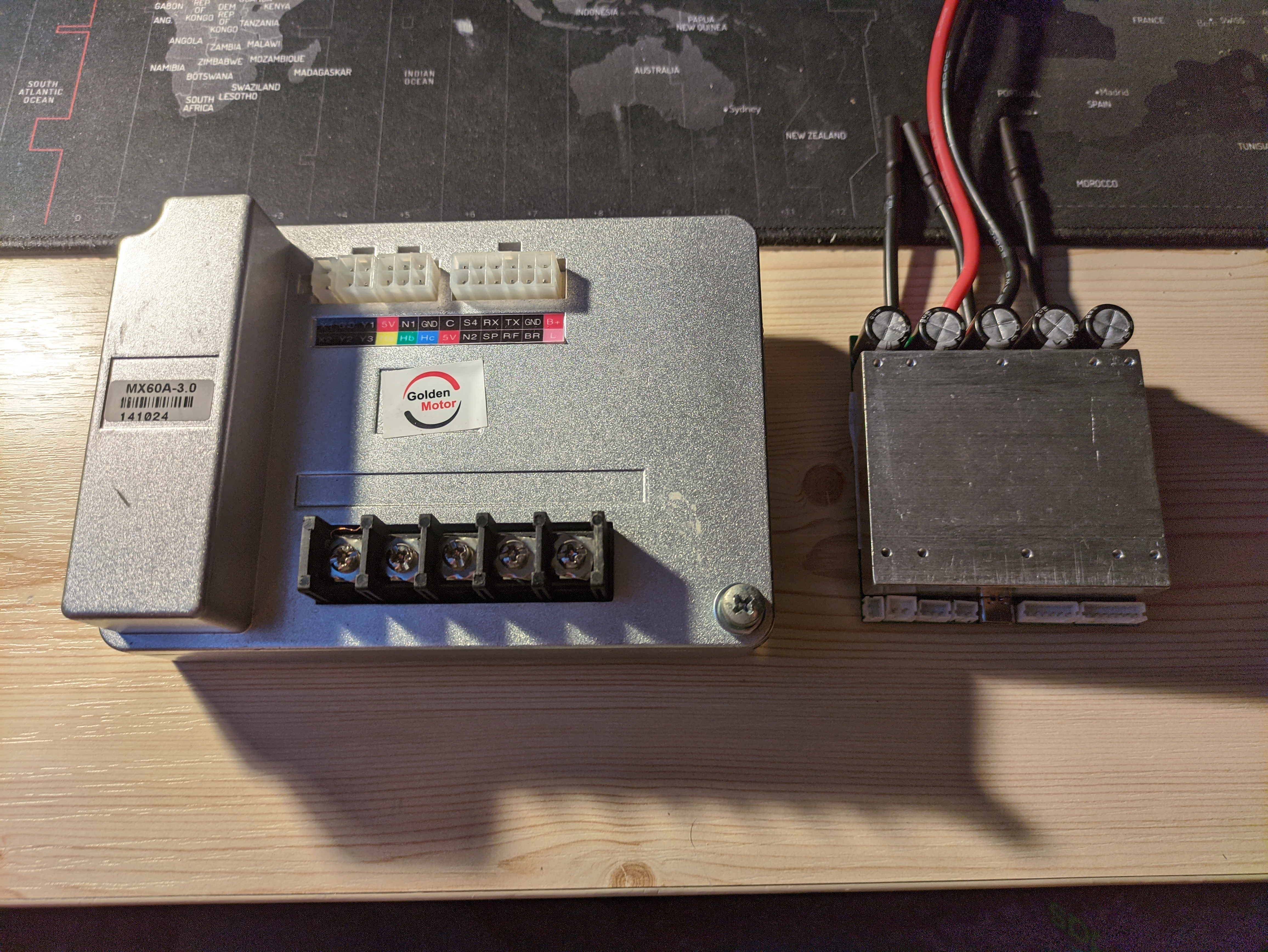

Fighting a lack of connectors, I managed to connect my Little FOCer to my scooter and configured it. So far, I’m impressed.
I’ll take it for a ride this weekend once I fasten the VESC to the scooter frame.
Using a brushless MY1020 motor. Perhaps the 60V 2000W version, not sure though.
Here’s some pics and the absolute unit it’s replacing.
Nice! 65km/h is pretty fast on a scooter!
I’ll see how fast it really goes once I mount a steering damper. I’ve heard these motors exploding somewhere over 8k RPM, so I theoretically could do 100kmh/60mph if I feel like killing myself :grin:
Is there a way you can take advantage of the threaded mounting holes in the little FOCer heat sink and couple it to a metal part of the scooter? That way you can take advantage of all the airflow in operation
I was planning on doing that actually. Since it’s so little, it’ll fit in the front part of the chassis mounted on a thick steel plate right behind the front wheel.
That will also give me enough space to fit a 20s12p battery. Because why not.
What thread are those holes? M3 is too big and 2.5 screws fell right in(not sure if they really were M2.5 though)
They’re M3 0.5mm pitch. I just threaded a screw through a block right now to be sure
EDIT: 0.5mm pitch. Not 1mm
