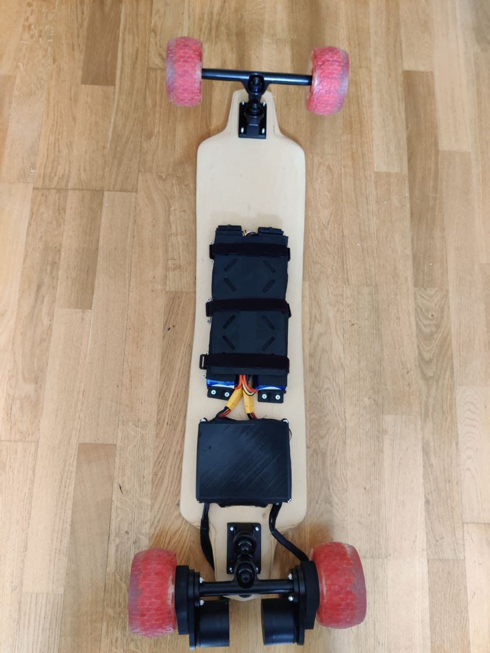

So, finally here’s what I’ve been doing for the past 3 years and have never, ever failed me:
  • Stainless steel wire: Bent into shape in order to form a “bridge”
  • Marine wood screws: I know, inserts are more elegant. I press my own decks, I choose to mutilate them so they know who’s boss.
  • Kevlar-reinforced straps: Inexpensive but tough. These are the ones that I used to hold LiPos on my drones crashing at +100km/h
  • 3D printed anti-slip holders: To stop the batteries from ejecting on hard (de)accelerations.
  • 3D printed PETG shield: Stops pebbles, curbs and general road shit from damaging the cells.
  • EVA foam: Used to cover the packs, adding some cushioning and making them non-slippery
These pictures show different iterations of two boards (mine and my GF’s). Both of them are using Turnigy 5S 5000mAh packs in series. I build a board for a friend using 4x 3S 5000mAh packs and it looks like this:
I think this method has the advantages of being inexpensive, secure and flexible. A dedicated enclosure for both batteries and ESCs (btw, my ESCs are inside 3D printed TPU enclosures fixed with inserts to the deck) certainly looks sleeker, but for me it’s just not worth it. Think of it as the refined version of the tupperware method.
Bonus track: My charging setup:
This puppy can pump up to 8A to each pack if I’m in a hurry!
What do you guys think?

For esk8 I have almost exclusively used Turnigy 25-35C 5000mAh cells, both in 2x5S and 4x3S configurations for 10 and 12S respectively. Lately hobbyking has been running low on stock, and for two new builds I’m planning for family members I have bought chinnahobbyline 3S 5000mAh packs. They are supposedly 55C (take that with a grain of salt, LiPo manufacturers inflate their C ratings a lot and they are usually only useful to compare packs of the same brand). CNHL is a reputable brand in the FPV space known for their cost-performance ratio and if these higher capacity packs are as good as their drone packs…oh, boy, these are gonna be really sweet on a eMTB.
Good setup. TBH, the batteries are protected on all the important sides. Only issue would be water. Good to see someone else using Lipos for a change. I also use Lipos with a bluetooth BMS for easy charging. What are your cut offs?
I have them set up pretty high to avoid damaging cells. Sag is not an issue on these packs, so my cutoffs are 35/33 for 10S and 42/39,6 for 12S (3.5 and 3.3V per cell). Since I always balance charge, I think I could squeeze a little more, but never had the need!
