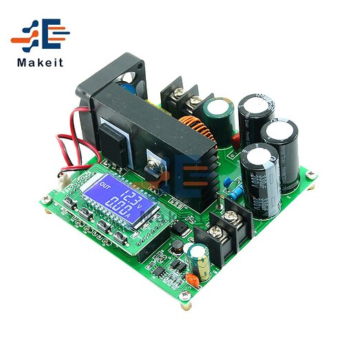

if you want to save money you can also use your Charger as a DC power source feeding a DC-DC step up converter. they are cheaper compared to buying a whole new charger.
If saving money is the primary goal, you should exit DIY and buy a Backfire or something.
