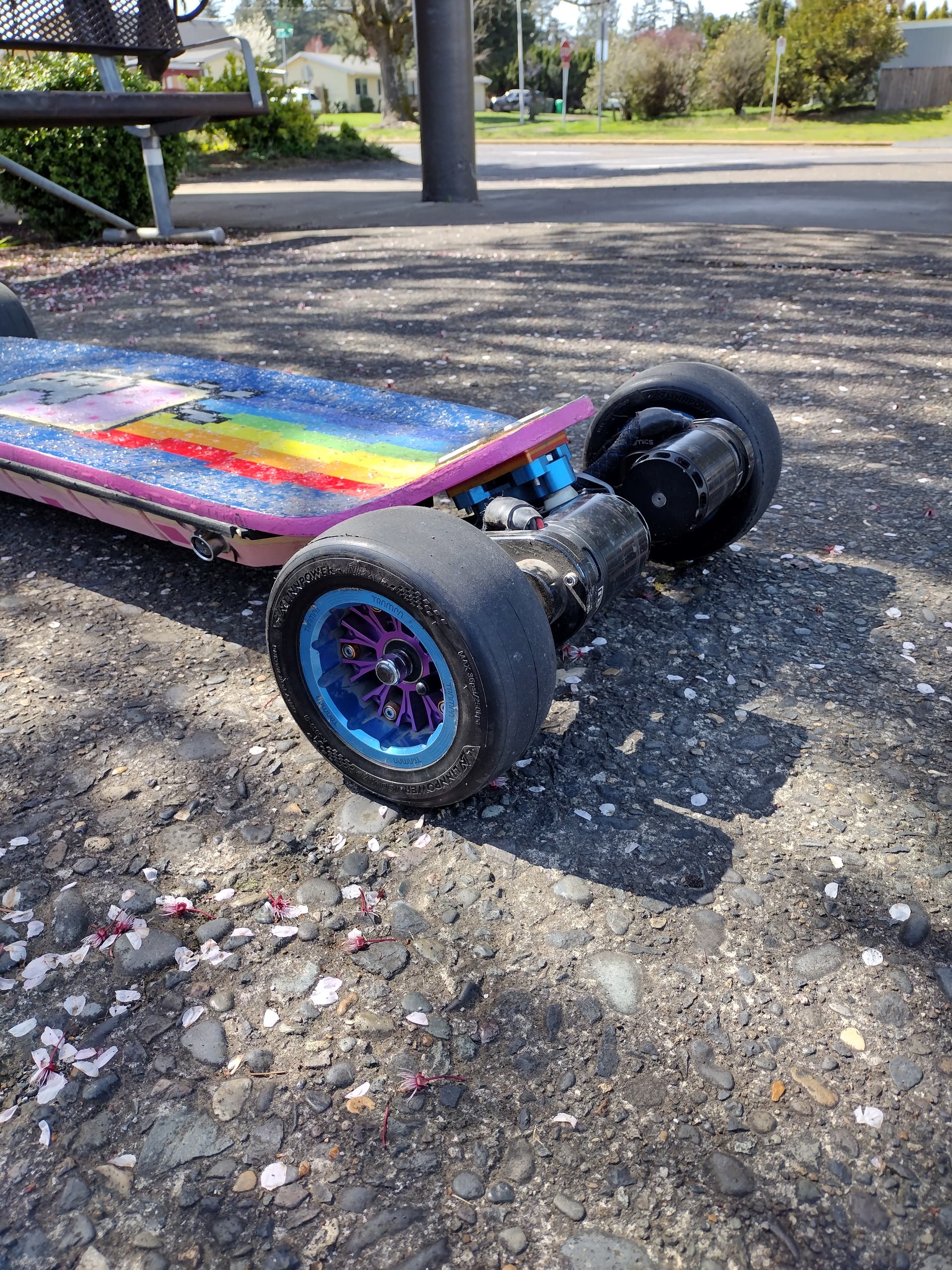

Got some good weather today, went for a quick test ride.
These are pretty grippy, moreso than the qind 200x75s I had on before for sure. I had another video with actual cornering but the file Is too big to upload.
Man that’s spinning like you’re on ice… what volts/amps are you running through those motors?
the better question is how much he weighs :joy:
i think he’s lighter than me?
i’m 120 fully clothed
140 motor amps at 16s, also 5.5 gear ratio. It’s a lot of torque for my 110 pound self :grin:
That’s what the backpack full of bricks is for.
The back pain is worth it
