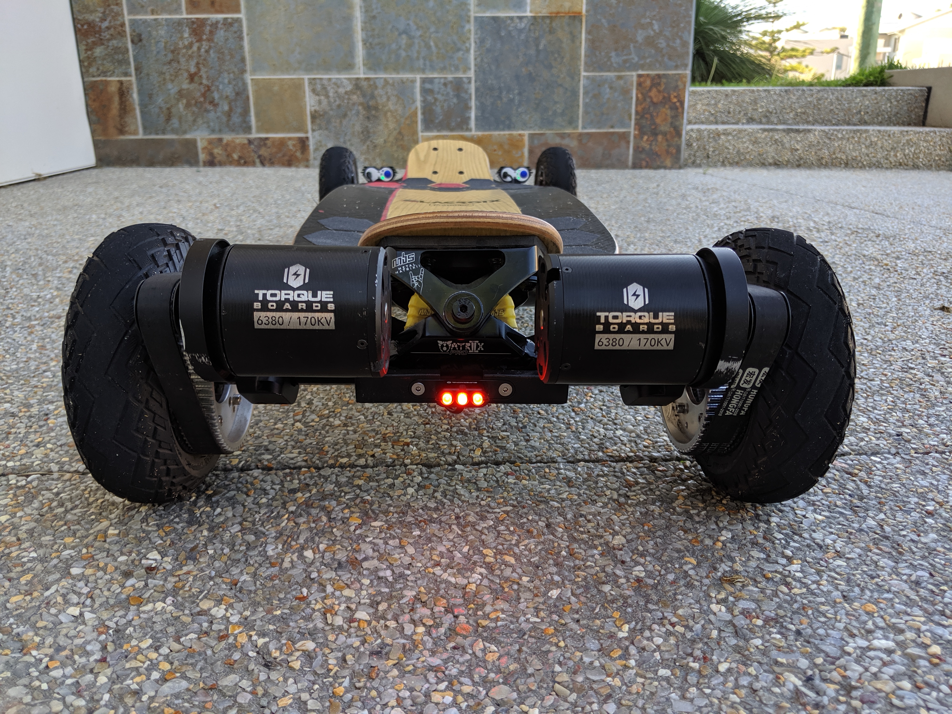

Love the headlights. Tail light seems tiny.

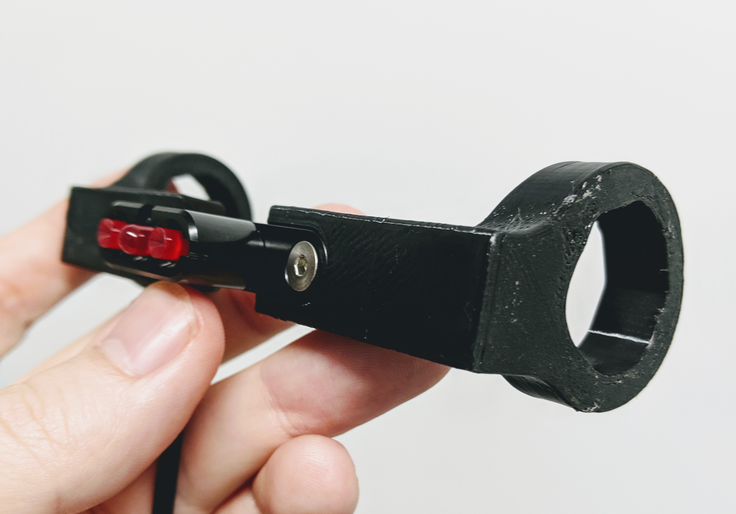

Do you have a link to the lights and a file for the mounts?

I’ve got a pair of those lights I’m not using if you want, they are usually around $15 each from eBay
The tail lights are small but really bright, supernova brand, a little on the expensive side but quality.
The headlights are the ebay specials, great bang for the buck.
I’ll dig out the CAD, stl file for the MBS mounts. Printed in flexible TPU filament at 100% infill, so you can stretch and squeeze them over the bar for a snug fit.
I think it’s these ones
Yes, same brand I used but the smaller option with the two leds/headlight.
If you order them, quick tip, first take them apart and stuff some hot glue into the cavity to help support the coil and absorb the shocks.
Yeah I had both die in the first 50 feet so I had to resolder them and “battle harden them”…definitely secure now though
