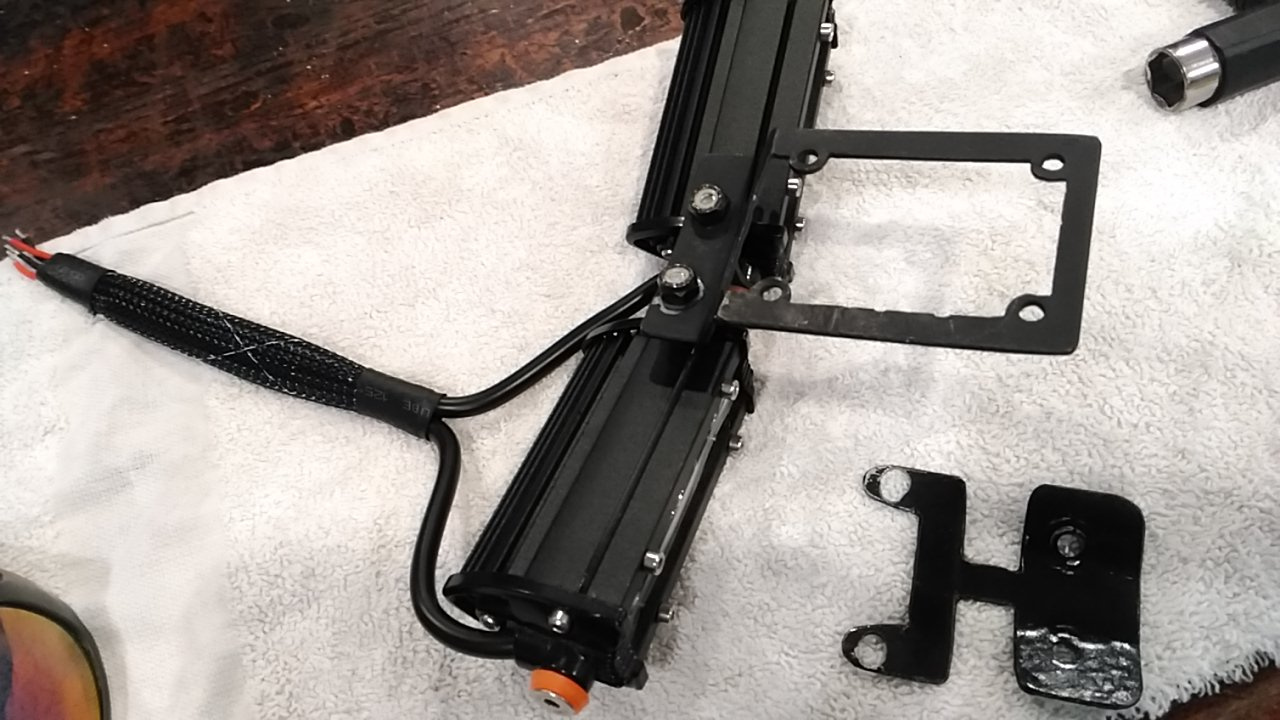

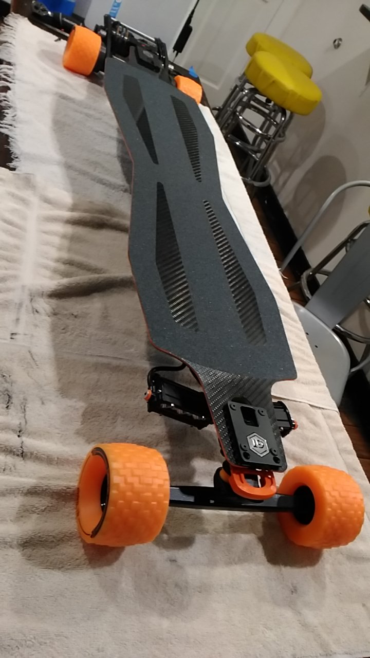

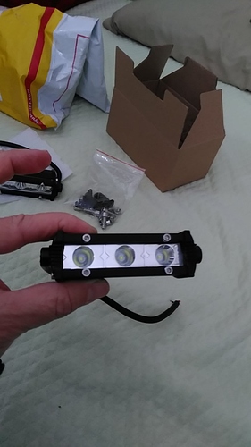

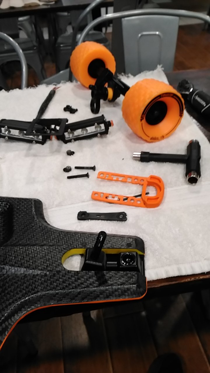

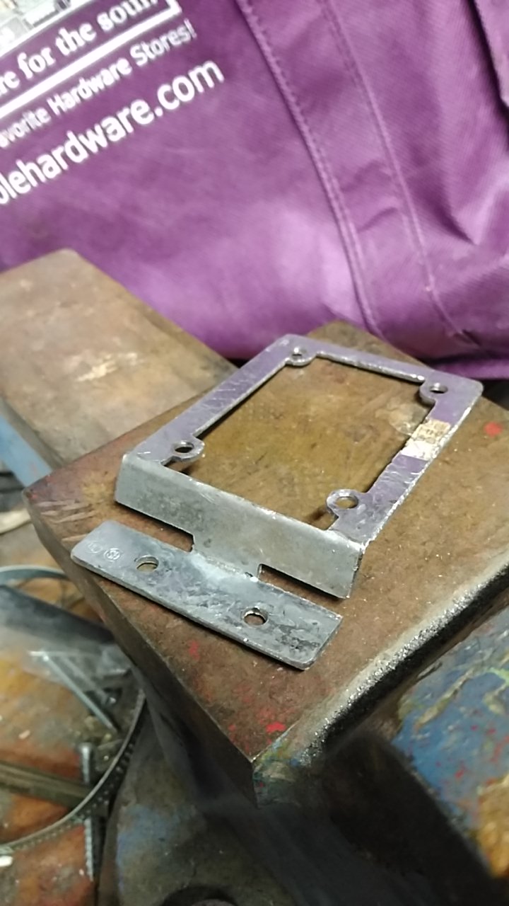

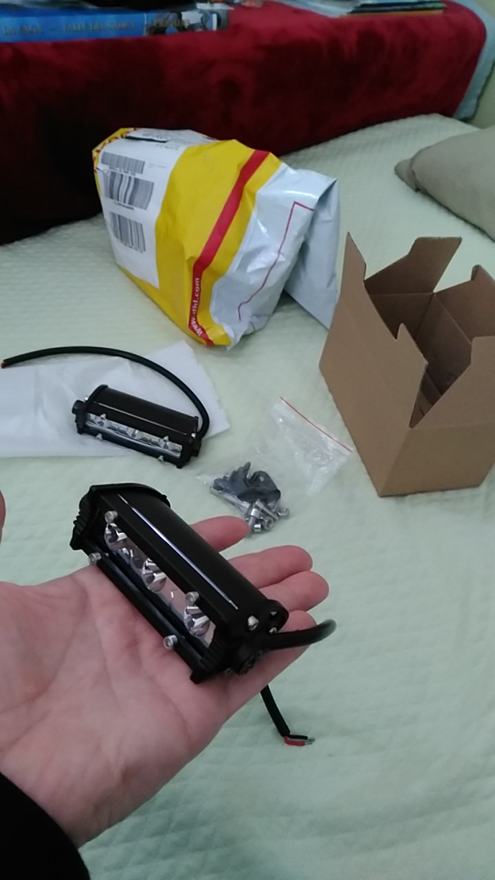

…my idea x my build is been kinda crazy. Got these 10 cms. 9W LED bar lights from China. Wanted them to hang below deck and behind the truck because I didn’t want them up front or over the deck.

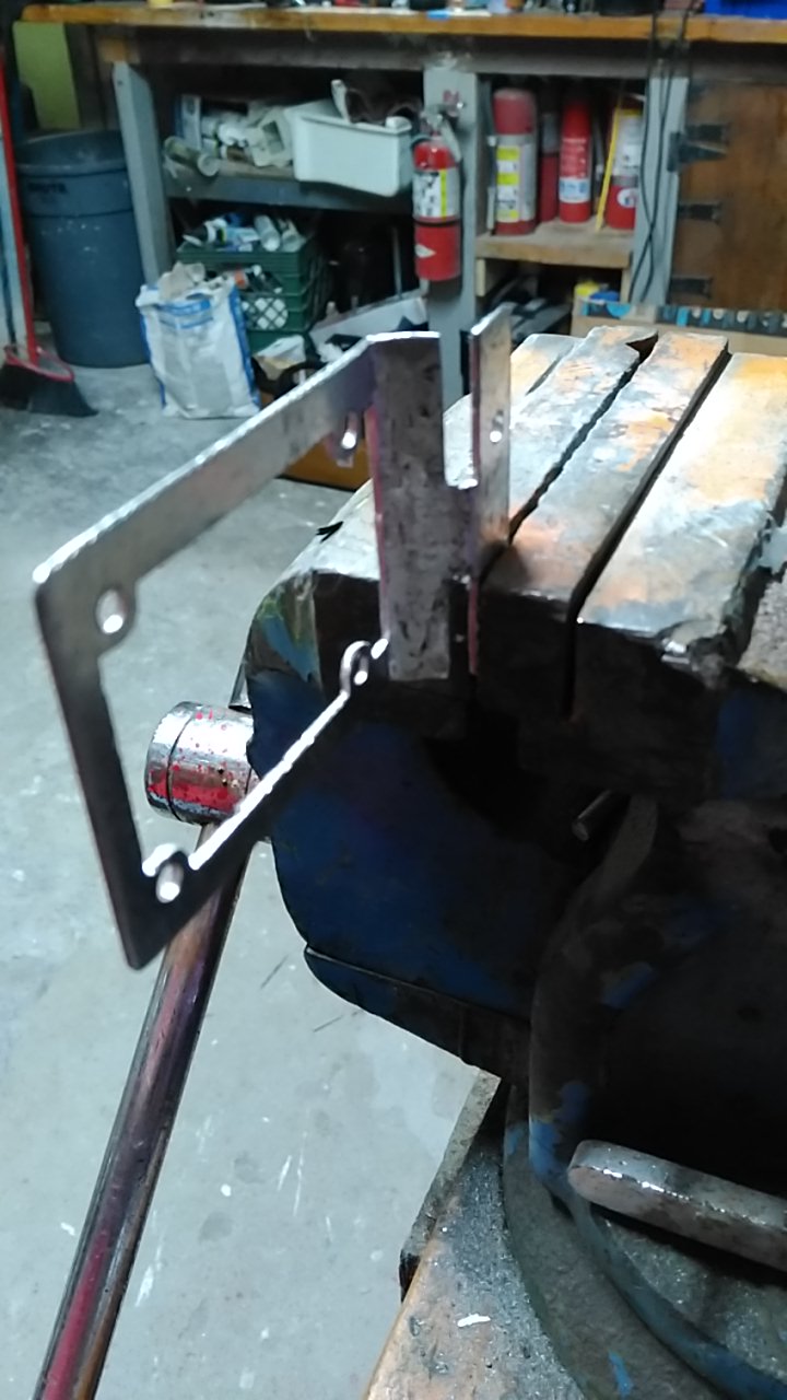

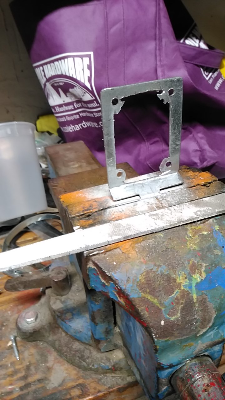

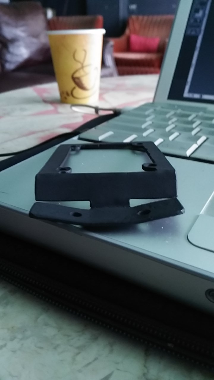

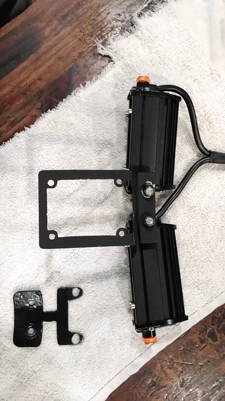

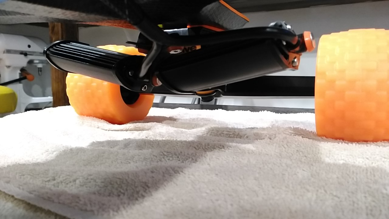

For this particular build instead using just one bar, I found that I could use two of them, side by side, doubling the lighting power, but all this by using the entire board width from edge to edge. Then I decided to hang them on a V position using a bracket which I custom built out of a steel plate that I cut and grinded down. By doing this I avoided the front wheels and the truck so they cannot block the light beams.

@pixelsilva Small random question. Why didn’t you make both cables go towards the inside of the lights? My OCD kicked in
Ohh Bro, that simple. If you look at them from the side ,these lights are symmetrically oval in shape on bottom and top and they also come with cooling fins (on one side) to dissipate the heat from inside. So you immediately assume the fins should be at the top…
If you place both bar lights, side by side, facing forward, their fins are on top but that also means (in this case) that the cables will come out from their right side…
This presents a little inconvenience which is that you will not be able to channel both cables between both bars and direct them thru the center of the board due to their constrained length. So the best way for me to keep the same length and route them out as one set of braided cables was by exiting them midway the first bar on the right (left from your view). Cables will eventually go inside the custom enclosure so it doesn’t matter which side I’ll decide to route them or not. They will be underneath the board and not visible.
In this image you can clearly see on the left bar the cooling fins are a top and the flat side without fins at bottom.
if your feeling brave you might be able to open one and flip the aluminium extrusion :slight_smile:
