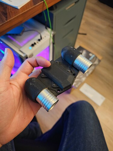

Too bad they are not angle adjustable :frowning:
They are provided with multiple angle mounts that cover a number of different truck installations
I do have plans to make some adjustable ones at some point though

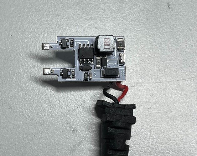

So I took it apart…

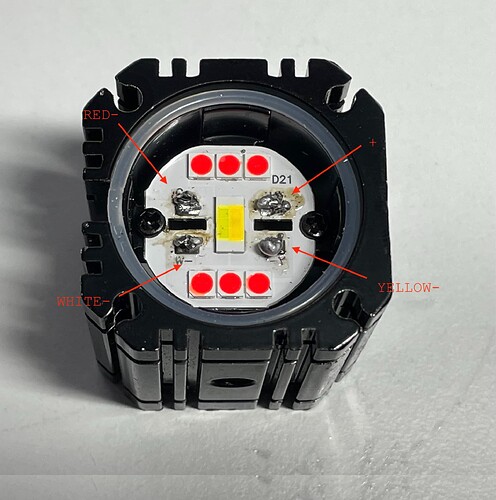

It looks simple enough. The driver PCB connects to the LED PCB with 4 PADs labeled:
  • L+
  • W- (white?)
  • Y- (yellow?)
  • R- (red?)
… and each of the negative pads has a transistor. So I guess I just desolder all the transistors, then short pads on the W- ones and then I have white-always-on. Right?
What confuses me though is that the pads on the LED PCB are also labeled and it doesn’t align. For example the, W- on the LED PCB connects with the Y- on the driver PCB. This will probably require some experimenting. Good that I bought 3. :slight_smile:
LED PCB labels are correct. I connected 9V directly to it to verify.

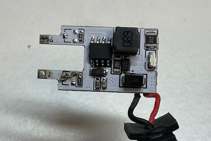

Hacked PCB:
aaand…
It’s doing the right thing! Yay!

@hatman PMed me regarding the details of the while-always-on hack. Let me try to write up instructions publicly in case more people are interested.
Step 1: Basic disassembly. Unscrew the 4 bolts. After that both the front and back cover can be removed. There’s a cutout on the side where you can push against the back of the lense to get it out as well.
Step 2: Desolder the driver PCB. There are two PCBs:
  • driver PCB
  • LED PCB
Initially, they are soldered together at these 4 pads…
LED PCB:
Driver PCB:
I managed to separate the solder joints just by heating them up with a soldering iron. I didn’t use any solder wick or a solder sucker (though that might have made things easier).
Step 3: Desolder the MOSFETs. There are 3 MOSFETs that need to be desoldered. I did it with hot air and that worked really well. Soldering iron will probably also work, though it can get a bit fiddly.
Step 4: Short the pads. You will want to short the pads where the MOSFET for the white LED originally was (or red or yellow if you prefer other color). Now, this is where things get confusing because the pads on the driver PCB are labeled incorrectly. For white, short the MOSFET at the pad labeled Y-:
I soldered a small solid core wire to create the short. This was super fiddly with an iron. I would have probably been better off doing this with hot air.
The labels on the LED PCB are correct:
So as a verification, you want to create the short at whichever pad that aligns with W- on the LED PCB (it was labeled Y- in my case).
Step 5: Put it back together. Be careful not to flip the driver PCB when putting it back. L+ should align with L+ (that one label seems to be correct on both PCBs). Then add some fresh solder and solder the 4 pads back together. (Probably best to do all 4 to make sure everything sits in place nicely though only the L+ and W- are critical for things to work correctly.)
