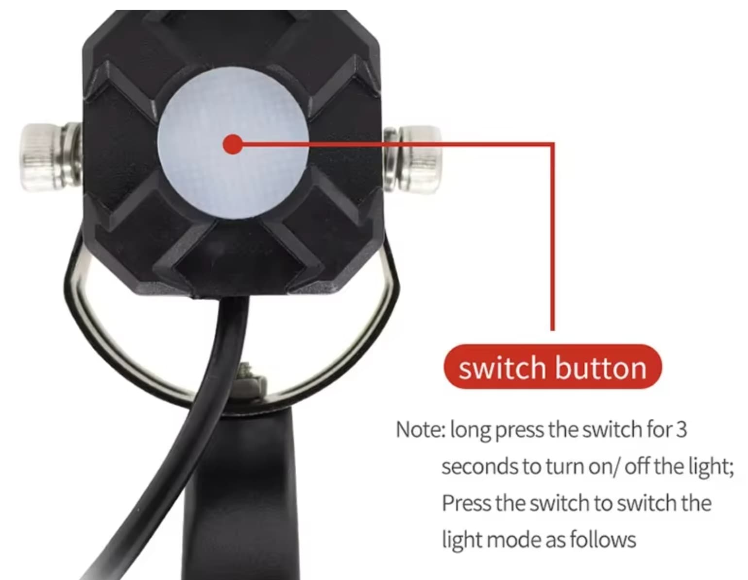

Ugh, I should have held back. I already ordered 3 pcs from AliExpress. If they require power-cycling to switch between modes they go straight into a trash can. I’ll report back when they arrive.

This looks like the “correct” variant:
https://www.aliexpress.com/item/1005006904737423.html
Edit: I ordered from the link above and received the same crap with a “decorative button”. The product description is wrong. Don’t order from here if you want an actual on/off button.

Those AliExpress lights are tempting but I’m not sure how they work. They sell different coloured ones and “strobe” apparently. It looks like white/yellow instead of low/high beams and I would only use the switches wired up instead of the button but can’t see anything about that.
It’s only €10 I can just buy them and see, otherwise I’m also tempted to buy a bunch of 519a chips and do something myself.
